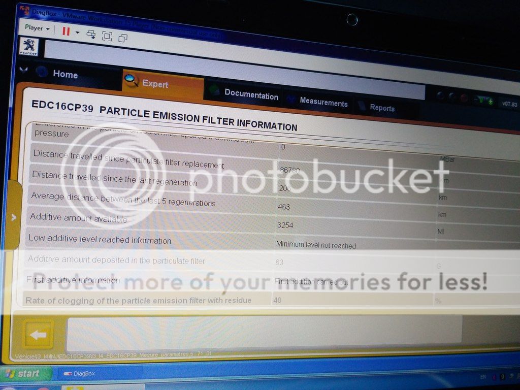

Some update - I've used all fuel and today filled up 50 litres and covered some 130km.
Connect the pc and there is the same level of additive 3254ml :?

Re: ecu wont add eolys to fuel!
It only uses a very small dose so may not show immediately.

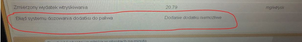

I checked in Diagbox --> Global test-->Injection/Ignition--->Service Repair(FAP additive dosing) -->there is a question if car has a separate ECU for additive. If I choose YES then pulls me back to Service Repair again. If I choose NO, then appears another options reagrding to additive reset counting/ inicialization of additive level after pouch change, here I change level of additive fluid and it is recognized by ECU. That's why I suppose I don't have separate ECU.
I struggle with it only for one reason. There are no faults on the dashboard, just when I go to particle filter information(Global test) on standard parameters I see last column - below picture unfortuantelly in polisch (additive addition system fault) with information"additive addition impossible". Local dealer said that everything is OK, and there is no problem with such information - it's probably Diagbox software error. But I don't quite believe it and that's why I am trying to check how its done in real condition.

Hi Grzegorz
Apologies! :oops: I was working on another member's vehicle similar to your engine and one does and one does not have the separate ECU - your does not! I have corrected my post above to avoid confusion going forward. So in the menu where you were - please do NOT select separate additive ECU - these engines could of had both systems - that's why the option is there.
So a) reset the additive counter and b) also prime the fuel additive circuit. :wink:
