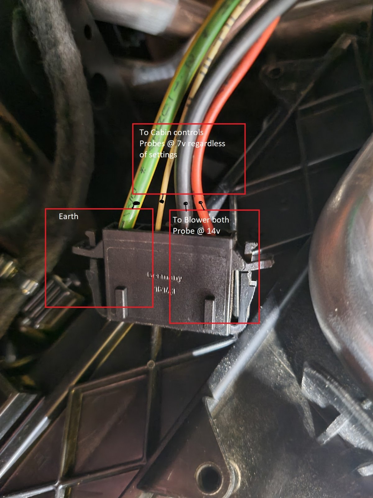

Re: Citroen C5 X7 mk3 climate control heater fan fault
I am going to try this thread to see if anyone reads them still before starting a fresh one.
my situation sounds very similar but just different enough to raise questions.
2013 C5 X7 wagon
Cabin fan operates at full speed, can not turn off, can not adjust speed.
before reading posts I assumed it was the Blower resister (yes I know its not actually a resistor). Like many before me, I purchase a Chinese knock off , the first one was for an earlier model the second one operates exactly the same as the original - no control - full speed
Facing AU $350+ for an OEM unit or AU $150 for a "reputable" aftermarket one, i decided to probe the wires to see if i can find a variable voltage signal coming from the interface.
I probed the 4 wires (plug disconnected), Red and black show a constant 14v, green/yellow appears to be earth, and the little yellow wire shows 7v. none of them appear to change when the dash controls are adjusted.
I can find no wire that changes voltage when i adjust the fan speed, even all the way down to off.
Is my dash control unit busted or am I testing this wrong?
also, My OBD2 reader displays no errors
2013 C5 X7 wagon
