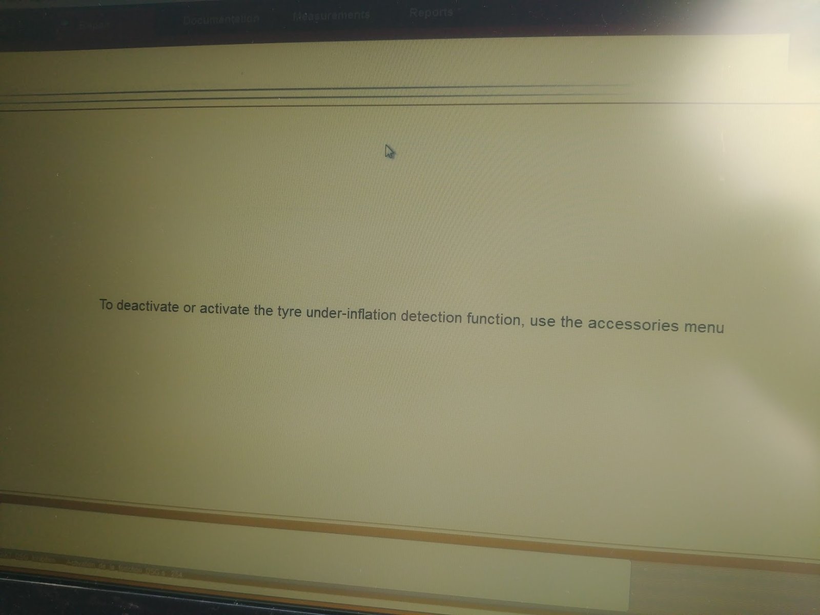

Ok, so the light has obliterated the last part of the text on your last screenshots, but what I think it is saying is that to completely disabled and re-enable it, the configuration settings need to reflect the status in both the BSI and in the instrument panel ECU. So I assume both areas were disabled previously. So next locate the instrument panel ECU from the Global Test and make sure the option is enabled there.
It should then be a matter of programming them / pairing them again once this has been done.

Theres no option to enable this in the instrument panel ECU. Went thru it multiple times. Intresting... Any other ideas? Its crazy how hardit is to activate itGiveMeABreak wrote: 02 Aug 2020, 15:54 Back to the issue:

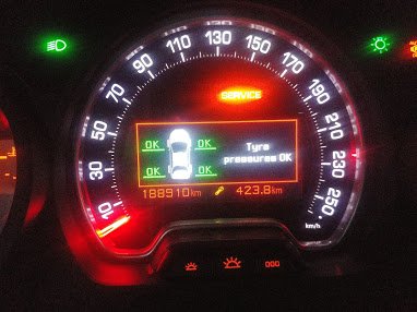

Now i got a menu option to "enable / disable the DSG system" (inside REPAIR -> DSG), but it points me to the accessories menu. Where the heck is that? I went thru most of the diag in the past 3 hours but nothing like that anywhere.
Edit: The Instrument panel ECU / COMBINED doesnt have anything about DSG. You can test stuff and configure what can be shown on the middle screen as info. (no dsg in there)
Pic attached.
I updated to v7.58, stuff do look different in diagbox.
Pic attached.

No problem - have a look right at the beginning when Diagbox opens - it may be called CUSTOMER OPTIONS or similar (they keep changing the locations and names all the time)!

Well, that did it!GiveMeABreak wrote: 03 Aug 2020, 18:01 No problem - have a look right at the beginning when Diagbox opens - it may be called CUSTOMER OPTIONS or similar (they keep changing the locations and names all the time)!
All it took was press activate in that menu and drive 2km.
In that customer delivery menu i changed my tire settings to the correct size too, wonder if that help anything.
