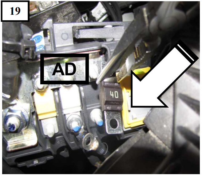

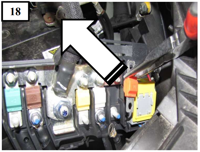

The additional loom is actually wired into the fusebox directly Paul - and in addition requires the removal of the existing fuse plate and replacing it with a 40A one. Taken from the product description:
This harness takes account of the features of the vehicle, thus ensuring safety, reliability and simplicity of fitting.
Simple connection using the interface connectors identical to those for the vehicle.
This harness provides power for a caravan refrigerator.
- Posts: 9454
- x 1945
Re: Is it the socket / connector for the tow bar?
Ah, that answers the basic question regarding high current consumption devices. The 13 pin socket includes several sockets with +12v for different applications. I often wondered why and this answers that one.
