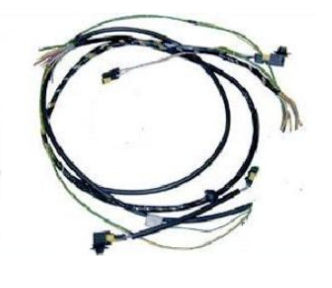

No the BSR is for normal towing and is not standard kit Avi. An additional loom is supplied optionally for the use of separate equipment. I will put a picture up shortly.
So I've now found out that this loom (1609732180) is the additional loom for supplying power to equipment like a fridge. It is optional equipment as not everyone nmeeds this.

I'm not sure what the extra loom would be for as the BSR kit includes a 13 pin socket which services all requirements. I really must find the paperwork when I get back!

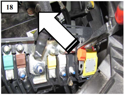

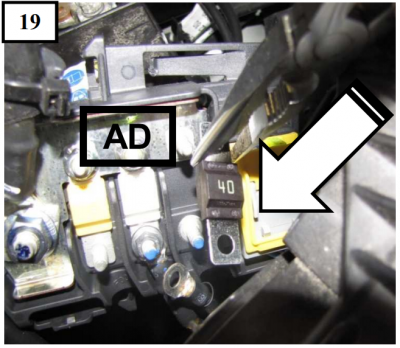

The additional loom is actually wired into the fusebox directly Paul - and in addition requires the removal of the existing fuse plate and replacing it with a 40A one. Taken from the product description:
This harness takes account of the features of the vehicle, thus ensuring safety, reliability and simplicity of fitting.
Simple connection using the interface connectors identical to those for the vehicle.
This harness provides power for a caravan refrigerator.

Ah, that answers the basic question regarding high current consumption devices. The 13 pin socket includes several sockets with +12v for different applications. I often wondered why and this answers that one.
