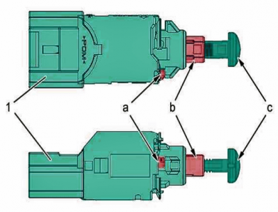

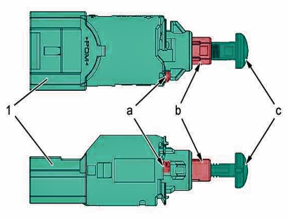

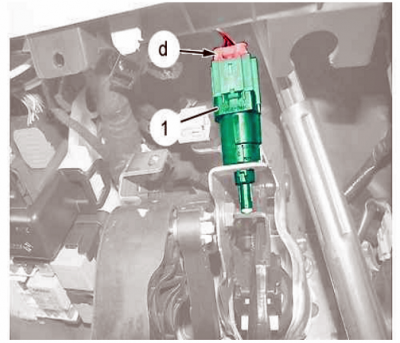

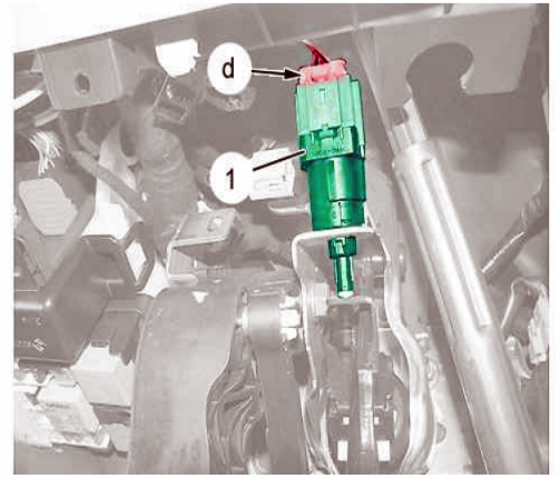

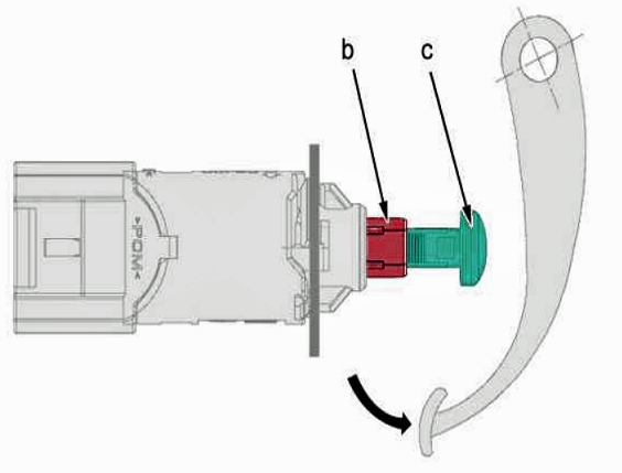

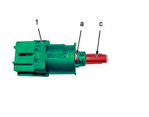

Ok, so here are the guidance notes as I can't recall the other post I did on this...
CAUTION: According to vehicle, there may be two types of brake switch assembly: Either a brake switch assembly with manual adjustment, or a brake switch assembly with automatic adjustment.
Stop lamp switch (With manual adjustment)
Removing
Disconnect the connector of the stop lamp switch (1).
Rotate the stop lamp switch (1) a quarter turn to the left to unlock it.
Take out the stop lamp switch (1).
Refitting
CAUTION : Make sure that the brake pedal is in the rest position and that it remains so throughout the operation.
Make sure that the locking latch "a" on the push rod support "b" is inside the extension of the stop lamp switch centring lug (1).
If this is so, the travel of the plunger support "b" within the brake light switch (1) is limited.
Present the stop lamp switch (1) to its support, with the thrust pad "c" against the brake pedal.
Press firmly on the brake light switch (1) in the centreline to set the piston "c" in the plunger support "b" until the base of the brake light switch (1) is in contact with its support.
Rotate the stop lamp switch (1) a good quarter turn to the right to lock it.
Reconnect the connector of the stop lamp switch (1).
Switch on the ignition.
Check that the brake lights come on.
Check the adjustment: Stop lamp switch (Brake pedal at rest)
Check the adjustment: Stop lamp switch (Brake pedal pressed down)
Stop lamp switch (With automatic adjustment)
Removing
Refitting
CAUTION: Make sure that the brake pedal is in the rest position and that it remains so throughout the operation. Do not support the brake pedal while fitting the brake light switch (1), risk of incorrect setting.
Check that the locking key "a" is inside the extension of the stoplamp switch centring lug (1).
Turn the brake light switch (1) one quarter of a turn clockwise to the stop.
N.B.: Adjustment of the stoplamp switch (1) is automatic once it is locked.
Re-connect the connector (at "d").
| [ | (1) Stop lamp switch . "a" Locking key. "b" Push rod support . "c" Thrust pad. |
Removing
Refitting
| Check the position of the plunger support "b" in the brake light switch (1). The plunger support "b" should be flush with the body of the brake light switch (1) and the plunger "c" should be in contact with the brake pedal. N.B.: The brake light switch (1) must not be used as a stop for the brake pedal. |
| The push rod support "b" is free and the push rod "c" is no longer is contact with the brake pedal. |
Removing
| Disconnect the connector of the stop lamp switch (1) (at "d"). Rotate the stop lamp switch (1) a quarter turn anti-clockwise to unlock it. Remove the stoplamp switch (1). |
| (1) Stop lamp switch. "a" Locking key. "c" Thrust pad . |

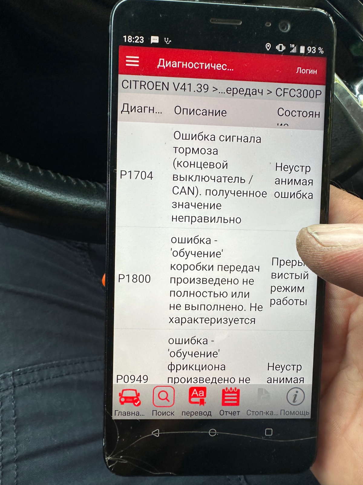

Hi guys,
Have Citroen c4 grand Picasso same problem
All starts from Abs esp park problem.
I have Launch x341.
After checking found that no Power to ABS block. I found the wire make jumper , connect launch and AB’s start responding. So all errors gone cleared.
Car start work fine. I put all wires back make nice. Drive all ok.
Switch it off and again problem. Launch shows problem with break switch. P1704 error.
So I check the switch it’s ok. Break light work. Also take another switch from the same car. Same error.
Also I check the gear box selector it’s ok.
Problem : system ask to press break pedal to start a car.
Also are some errors between communication devices.
As I understand ABS have 2 power wires direct from fuses from battery.
And same wire which goes on brake light goes to abs to prove that pedal is pressed.
Can some one share circuit diagram? With abs pinout.
My opinion it’s broken wires.
P0500
U0122
U0121
P1394
P0700 Gearbox ECU Poor operation of the Automatic
Gearbox
04C7
04D4
05FF
001C
098D
ABS / ESP
U1113
P0949
P0150
U1305
C1408
U1113
U1105
P0088
P0150
U1313
U1113
U1108
U2219
U2000
All this errors time to time coming out.
And one more when I on ignition reverse light on. I think the wire from sensor is broken too.

Here's some help with the fault codes:
If you need an original, genuine part number or part diagram, and can't already find the info you need on the Forum, we do ask for a membership upgrade for official pfor up to 2 years, so excell
- x 6957
Re: ABS/ESR
There's too many faults there for me to list out - from brake switch to programming of the hydraulic actuators not carried out to communications issues on the CAN network.
If you've had any work done recently on the brakes, I would be checking that no damage has been done tot he wiring of the ESP ECU, the wheel speed sensors. Has somebody been fiddling about with a clutch change and not programmed the hydraulic actuators and gear grid???
