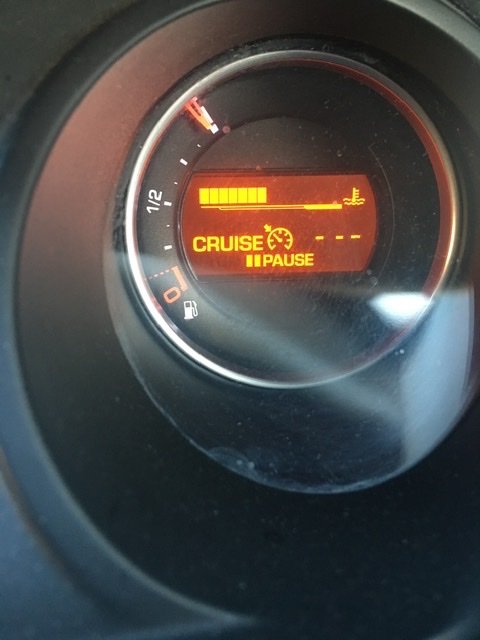

Well, last couple of days car covered in thick frost. This morning I left the car running outside the house for maybe 15 mins to heat the interior, then drove it 4 miles for my morning coffee. On arrival at coffee shop the temp gauge in the car not even registering one bar! Can’t be right surely!

That's the sort of thing mine was doing, sounds as though the thermostat is stuck partly open. Was the oil temperature reading anything?

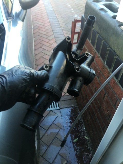

Update. Purchased a new stat from a local factors for £64 (Trade), made sure it was a Mahle/ Behr.

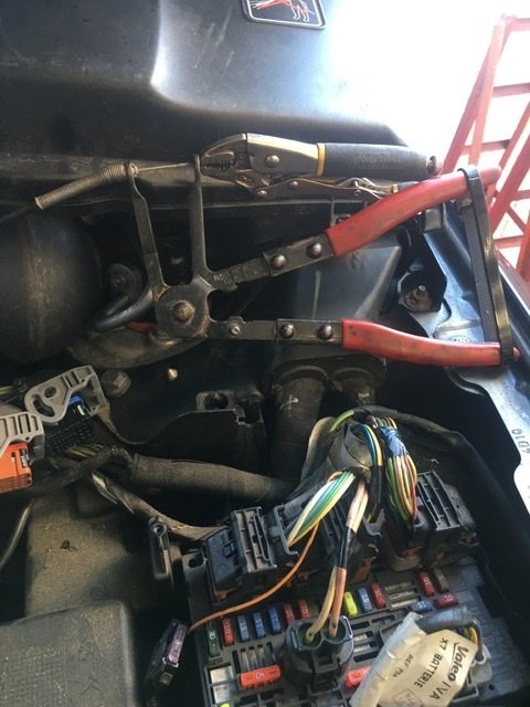

Job took 3 hrs with tea and interruptions. Went well but special clip removing tool highly recommended for the rear pipe. Car reassembled and now runs consistently at 6 bars, occasionally 7. No question that the old stat was faulty, even the heating is working better. Hopefully see an improvement in mpg! Pictures to follow.

A bit more info.
Oil temperature now also a bit hotter, at least one, maybe two extra bars. Ultimately though, the biggest effect is that the temps of both oil and water have now stabilised with none of the constant heating up and cooling down experienced before. Also the radiator cooling fan actually fired up for the first time ever! The acid test will be in the morning from freezing cold.
Dunno why these pics are rotated through 90°.

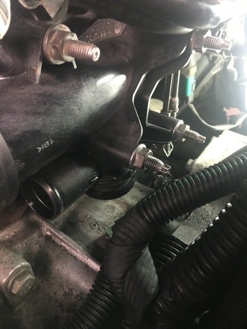

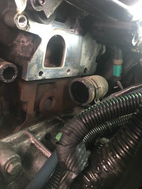

Bit more info..... Took out the battery, air box, and pipework to access the bracket over the thermostat housing.
Also disconnected the gear selector and removed it’s fixing bracket. Also a couple of plugs and sockets to undo to allow the electrical cables to be moved aside. If I had to pick one specialist tool to aid with the removal it would definitely be the hose clip remover! :-D

Well done, its a bit more complicated on the C5 but the principle is the same.
