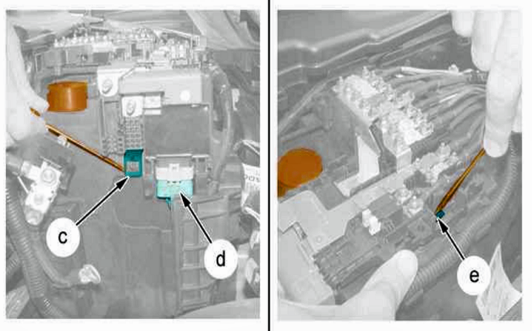

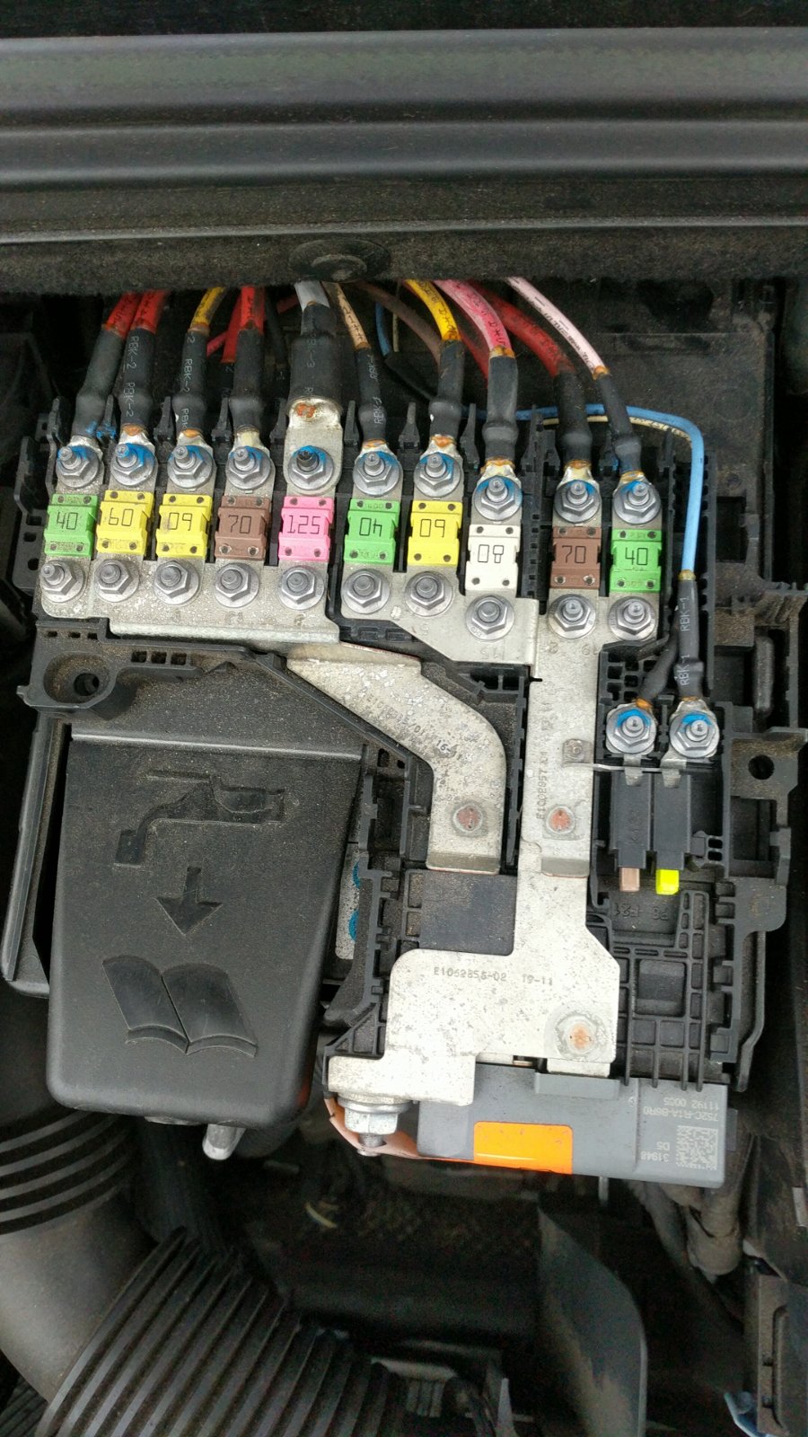

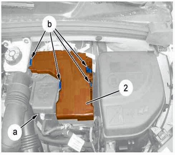

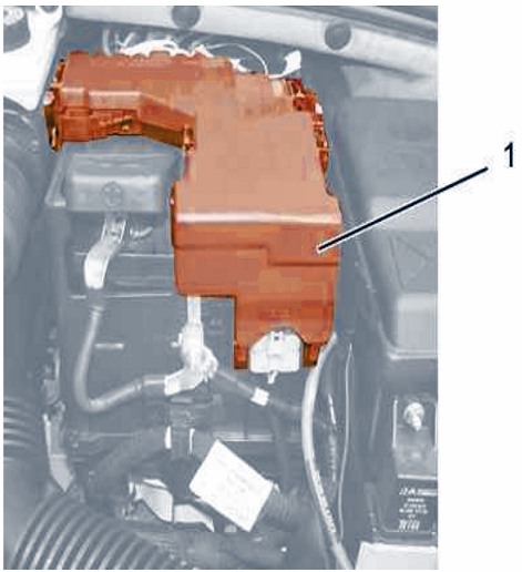

- x 6956
Re: C4 Heater/AC not working

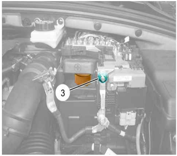

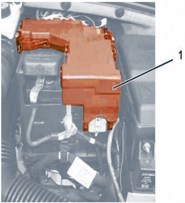

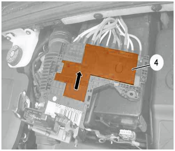

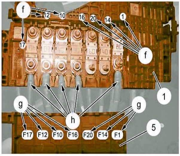

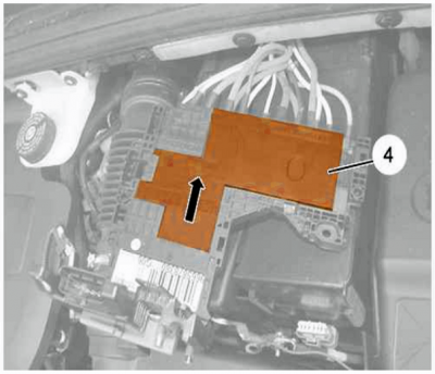

Ok, so the part you want is on the underside - this is part of the removal procedure, so should give you an idea of location - just follow what you need:-
| (1) Supplies protection and management unit (BPGA). The supply protection and management control unit is located on top of the ancillaries battery. N.B. : The supplies protection and management unit cuts the power supply to make the vehicle safe in the event of a short-circuit. |
| Disconnect the ancillaries battery (at "a"). Fit an insulating cap on the positive terminal of the ancillaries battery. Remove the following components (depending on the proximity of the operation zone):
Remove the cover of the fuse box (2). |
| N.B.: Always replace the nut (3). Remove the nut (3), Remove a tamperproof label. Disconnect the ancillaries battery positive cables and move them aside. |
| Disconnect the connector (at "d"). Unclip at ("c", "e") : Slide the fuse box (1) (Upwards). |
| Turn the power supply protection and management unit over; Handle it with care. Remove the cover of the fuse box (4) (In the direction of the arrow). Move aside the supply management and protection control unit; Handle it with care. Remove:
| Identification of the fuses (Lower panel): "f" Identification of the fuses on the supply protection and management unit "g" Identification of the fuses on the cover of the fuse box (5) Identify the electric wires (at "h") in relation to the identified fuses (at "f", "g"). |
Thanks you will have a look at the underside of that unit, I am also struggling to find 40amp MIDI fuse easily, eurocarparts need to order that in apparently.

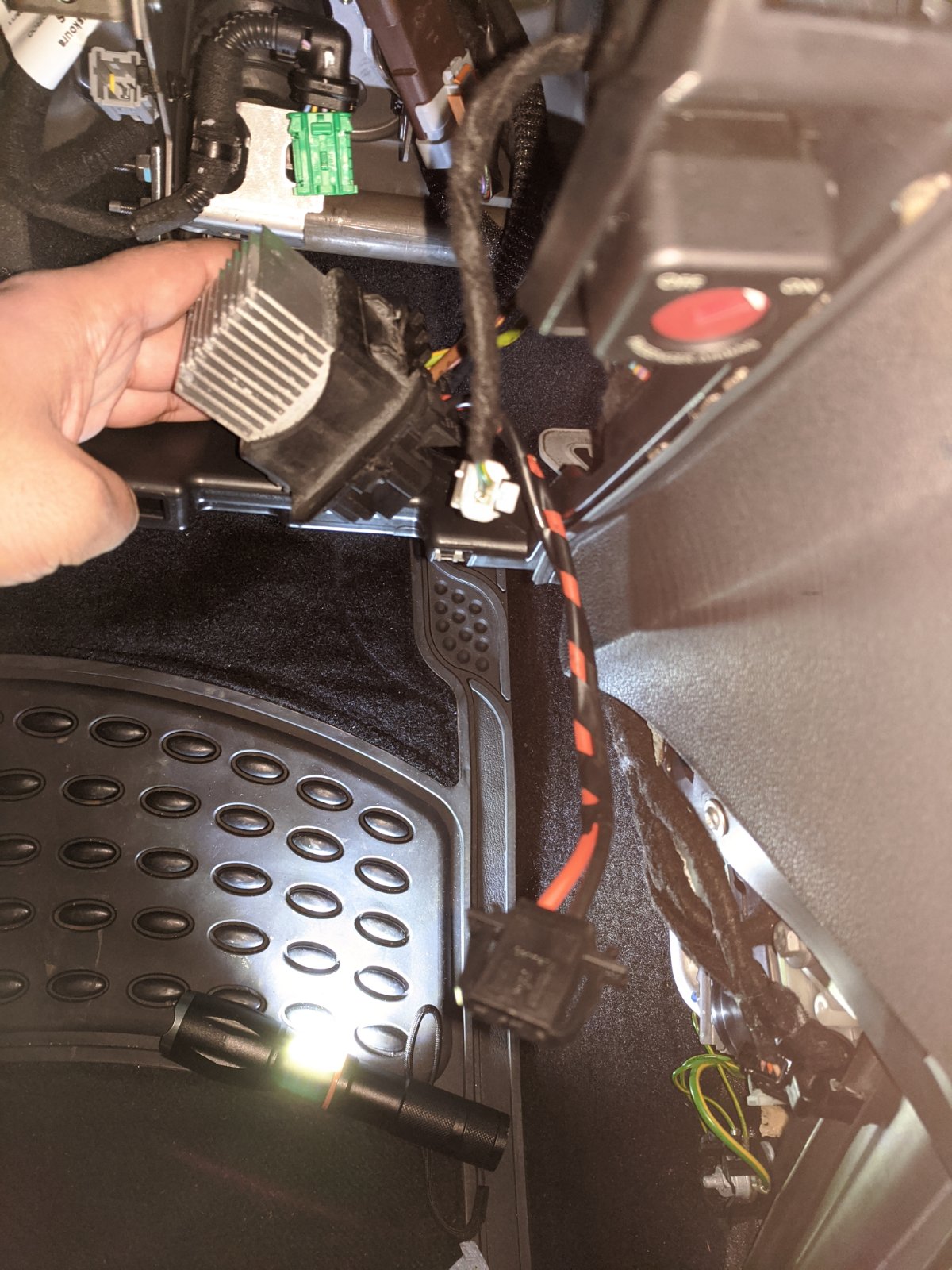

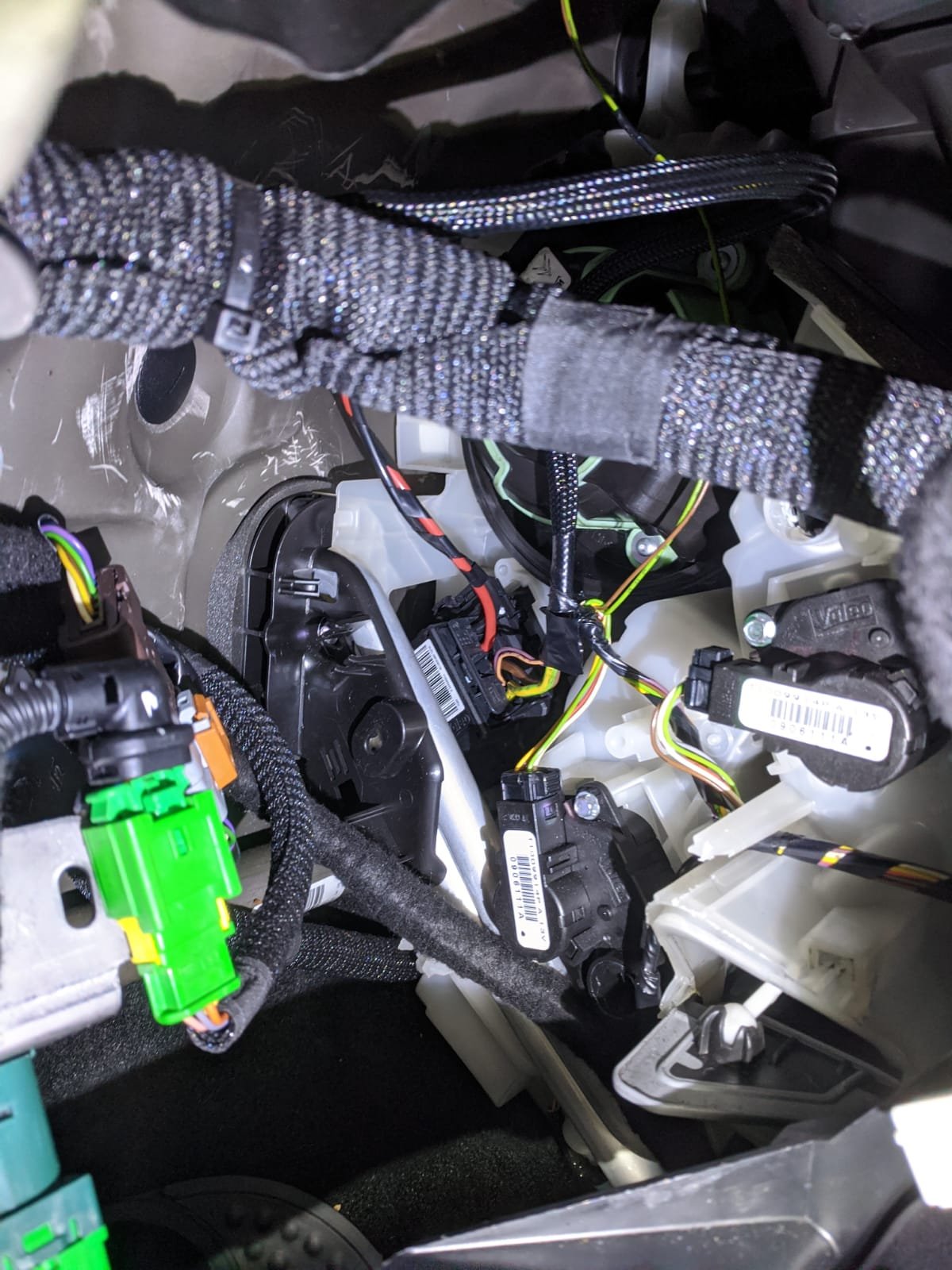

I checked the fuse with multimeter and it has continuity. I don't think it's a fuse problem. I also took the motor off and checked voltage at the supply end to motor. At full fan speed showing 4v and lowest fan speed was showing 12-14v.
Any one know what the voltage should be?
I tested voltage at the black and red wire which comes of the resistor control module and goes to blower motor. See picture.

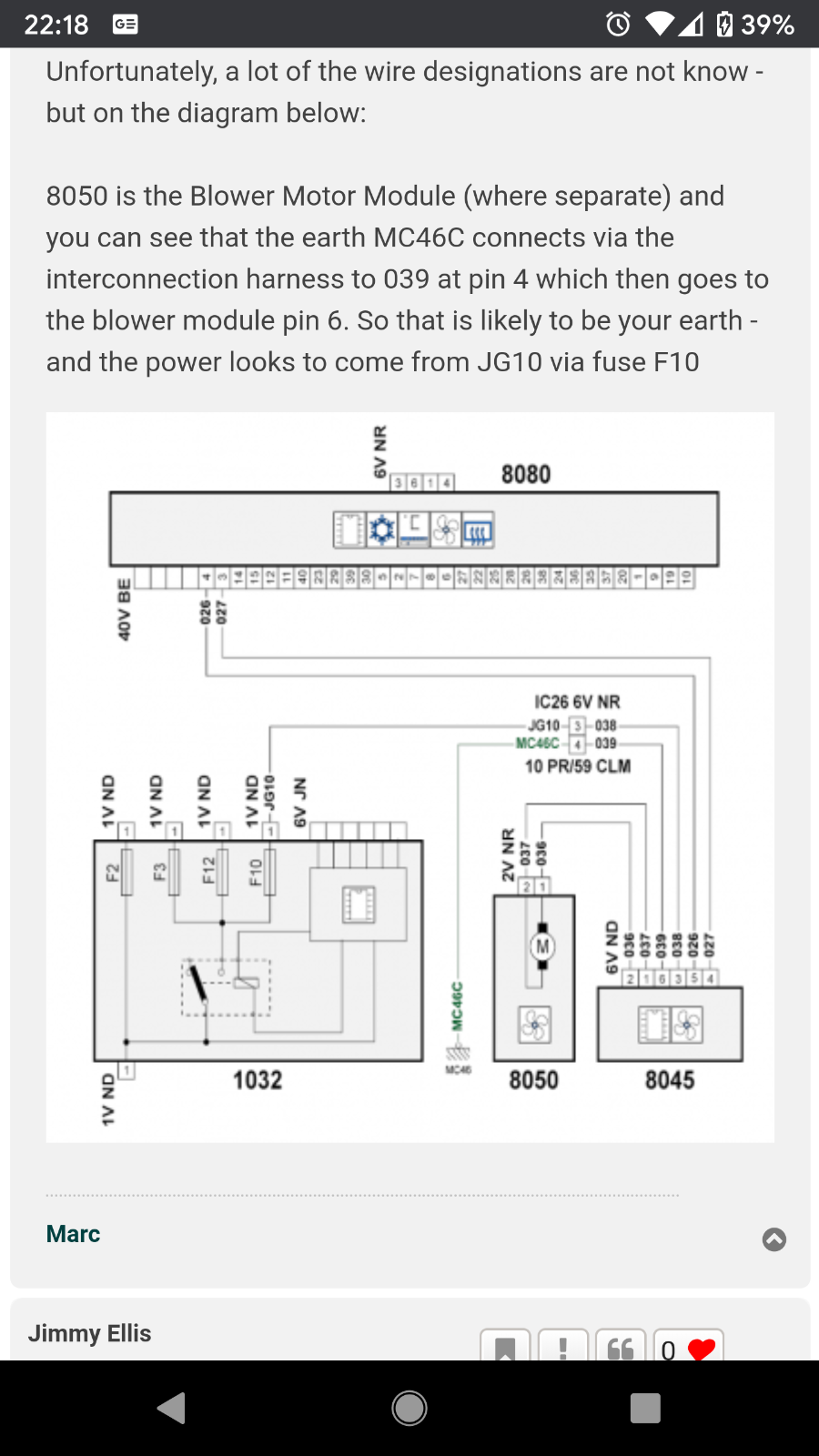

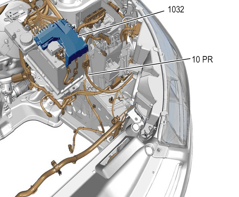

Been trying to read other topic areas to get an understanding and came across a post for DS4 regarding a faulty 10 PR/59 CLM.
I assume 8045 is the blower control module.
8050 is the blower motor module.
What is 8080?
What is 10PR/59 CLM and where do I find this?
Also if I want to check the Earth point MC46 where can I find that?
Thank for the help in advance...
What is 8080?
