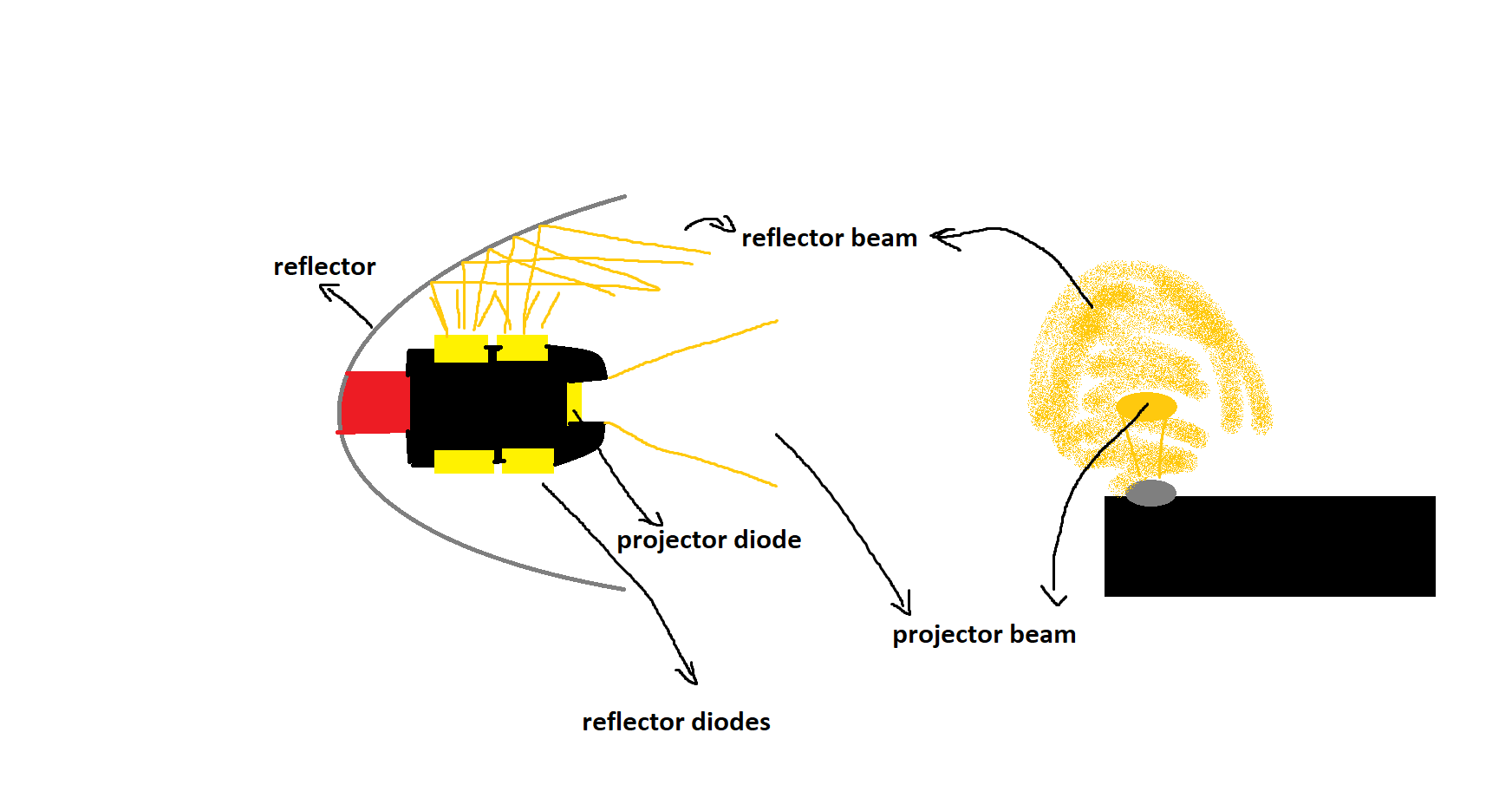

A crude drawing of what's it like on my car.

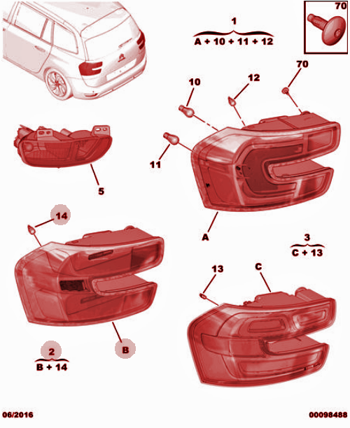

Ok, so that's why we ask for the VIN as it saves a lot of time and faffing.
So you have the LED lamp unit that incorporates the FIXED LEDs - so there's diddly you can do about these.
Item (2) on the diagram:
The only bulb (14) in this unit that is not LED is a W5W filament. So I wouldn't bother trying to do anything with these as a new light unit is a mere pittance at £460.19 each side for the tail light unit - but that does include VAT of course :rofl2:
So you are stuck with what you have unfortunately.
Now I have seen some silly pricing, but that takes the biscuit for a lump of plastic and some LEDs.

Cutac wrote: 05 Feb 2019, 13:07 A crude drawing of what's it like on my car.
That's a cracking drawing :rofl2:
But now we have the VIN, nothing there is interchangeable or swappable on the OPs light unit.
On other standard light fittings (not this vehicle), depending on the housing (some have little to no reflector on the reversing light and of course the colour lens filters, these are extremely limited to what you can do.

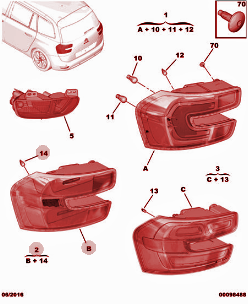

GiveMeABreak wrote: 05 Feb 2019, 13:18 Ok, so that's why we ask for the VIN as it saves a lot of time and faffing.
Thanks very much for your invaluable help, Marc. Is there any possibility you could email me the attached page plus any others pertaining to my rear lights? The picture shown is rather fuzzy, and it would be good to have in a higher definition.
Yes, Citroen UK parts prices are ridiculous. I recently bought a second set of rims for my Picasso (17" Aquillon) to fit a set of Michelin CrossClimates for the winter. I bought them in Calais for €828 compared to £1300 here. The difference was worth way more than the cost of a day out in Calais. The Executive+ should have 18" 225x45 profile wheels but they were so noisy and uncomfortable, PLUS they turned the car into a skier in the lightest snow, so I got rid of them and changed to the 17" 205x55 profile. Same brand of tyre in both instances - Michelin Primacy HP.

Right? :mrgreen: :mrgreen:
Yeah, manufacturers often see the reversing light as an indicator of a car backing up, not a light that should make backing up easier.
If it was up to me, cars would have crude halogen projector(s) instead of a standard reversing light. One H1 projector would illuminate better than any "classic" reversing bulb, and if necessary, a white indicating light can easily be fitted somewhere.

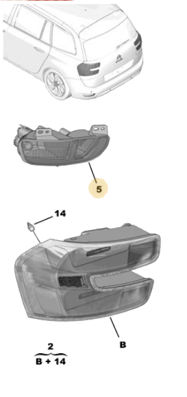

Re: Reversing lights upgrade?
WillyR wrote: 05 Feb 2019, 14:06
Unfortunately these are not available in hight res - you can click the image to magnify it up but that's about it.
Try this:

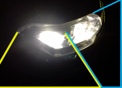

I have directional Xenon's, but that aside, the X7 has dedicated active cornering lighting as well as front fog lamps. On mine, the angular lighting is activated on turning the wheel at certain speeds and at junctions, and I get a 90 ° beam angle left and right that lights up hedges or road junctions, as well as the directional headlamps. But the lamp housing is set at 90° for this lamp - so is very effective.
Your fogs have a 'cornering function' - but in reality, all that can possibly mean is switching the fogs on at speeds under 25MPH when the main lights are on and using that small spread to throw a little more light on the near ground - they don't have a directional adjustment mechanism, so cannot pivot or change light spread direction. It's just offset slightly as can be seen on the picture below:
The X7 directional headlamp looking side on - here you can see the dedicated cornering light throws a good spread out that I approximated and marked in yellow and the headlamp spread (directional lamp looking ahead).
