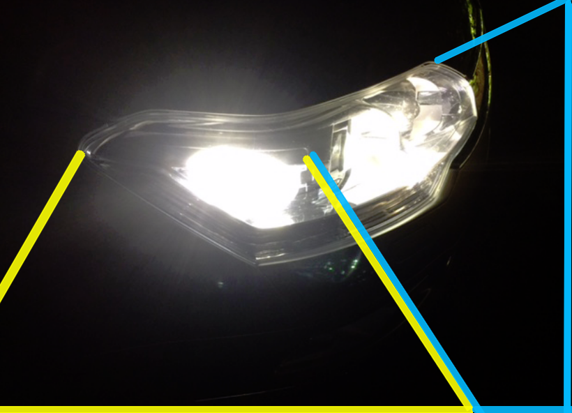

A crude drawing of what's it like on my car.

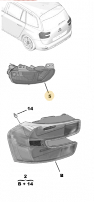

So you have the LED lamp unit that incorporates the FIXED LEDs - so there's diddly you can do about these.
Item (2) on the diagram:
The only bulb (14) in this unit that is not LED is a W5W filament. So I wouldn't bother trying to do anything with these as a new light unit is a mere pittance at £460.19 each side for the tail light unit - but that does include VAT of course :rofl2:
So you are stuck with what you have unfortunately.
Now I have seen some silly pricing, but that takes the biscuit for a lump of plastic and some LEDs.

Cutac wrote: 05 Feb 2019, 13:07 A crude drawing of what's it like on my car.
That's a cracking drawing :rofl2:
But now we have the VIN, nothing there is interchangeable or swappable on the OPs light unit.

GiveMeABreak wrote: 05 Feb 2019, 13:18 Ok, so that's why we ask for the VIN as it saves a lot of time and faffing.
Thanks very much for your invaluable help, Marc. Is there any possibility you could email me the attached page plus any others pertaining to my rear lights? The picture shown is rather fuzzy, and it would be good to have in a higher definition.

WillyR wrote: 05 Feb 2019, 14:06
Unfortunately these are not available in hight res - you can click the image to magnify it up but that's about it.
Try this:

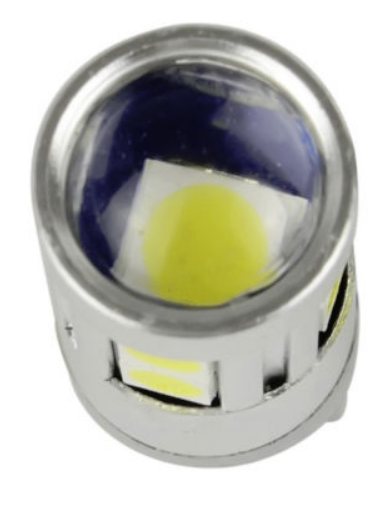

Back to the supplementary reversing light then. While one of those el cheapo aftermarket DRL's might be tempting, I'd want a demonstration of how much light it'd actually throw on the ground before paying out good money. My preference would be for a strategically but discretely mounted small foglight.

Which car is it for?
You could buy a halogen projector, take it apart, cut the blind/shutter/cut-off metal in a manner which would make the cut-off flat and then drill a hole in your bumper and fit the projector there.
