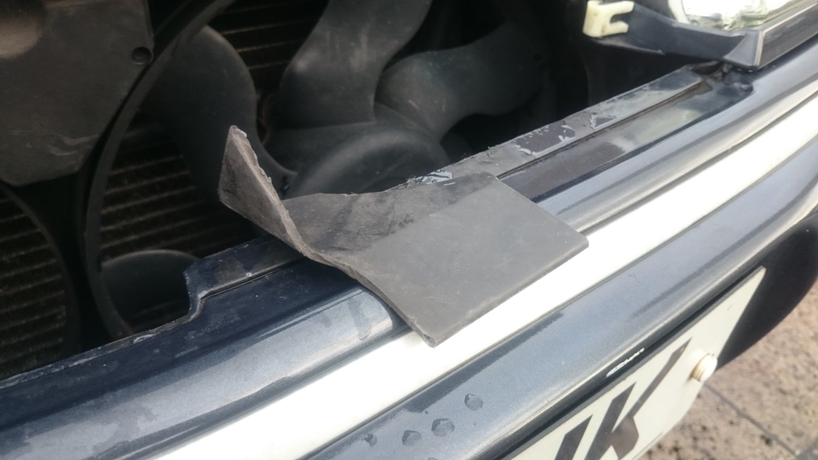

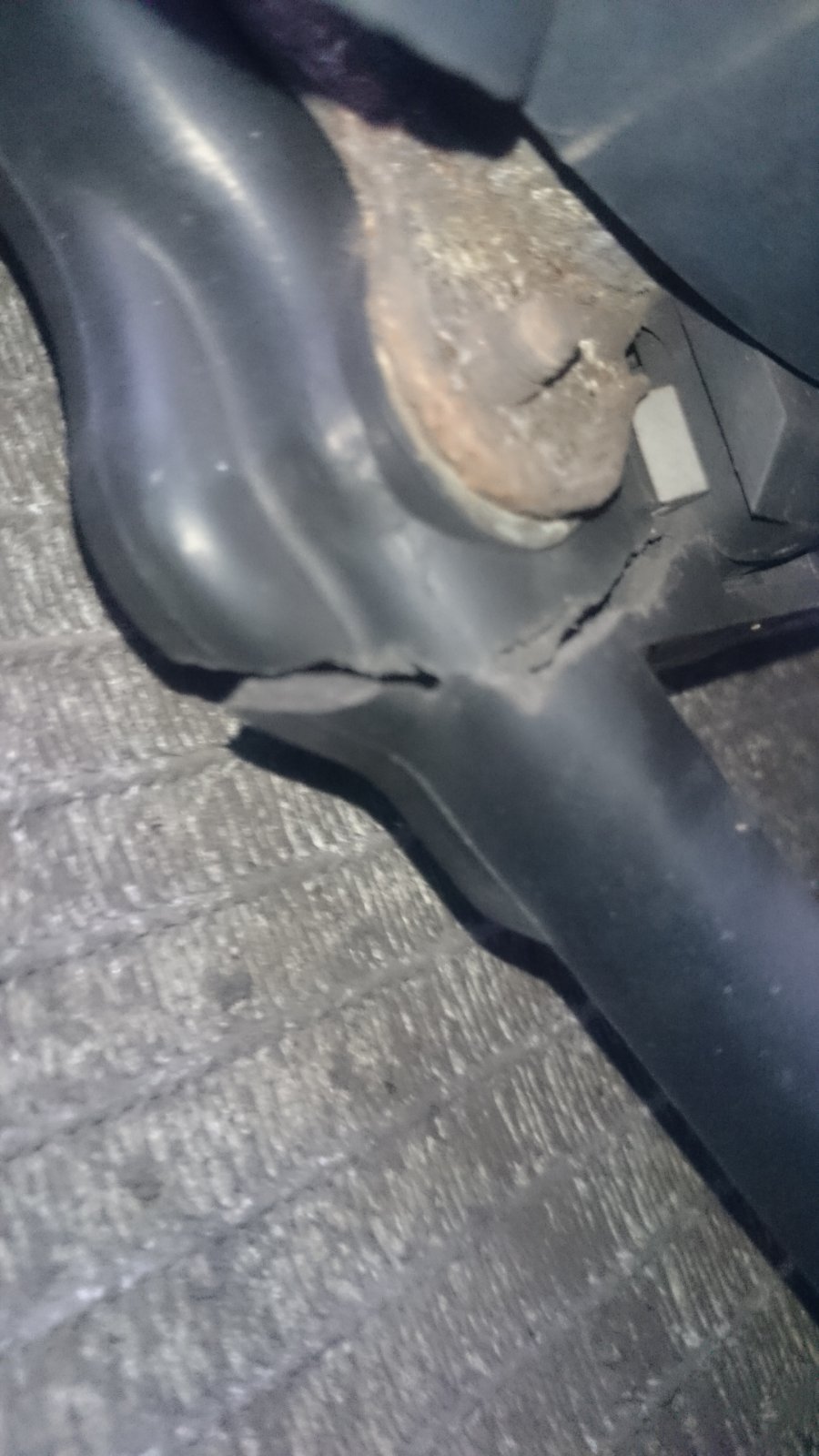

Right. Check it just now and looks like all fuses are alright. I've checked three relays (located between fans) in black plastic box and there is no issue with them at all - no burns or melts on sockets and relays's pins are clean and not damaged. As I've check them I found loose piece of plastic located behind fans and radiator and some damages to frame itself. :x
Any suggestion what else I can do ? As mentioned before I got donor car from 1999, but trying to start with small bits before thinking about replacing of whole thing.

@Pshemsky that bit of plastic looks like a piece of fan blade to me.
The damage is on the housing unit and they do spin at a fair old whack so assuming you have a complete assembly i would suggest replacing the whole thing.

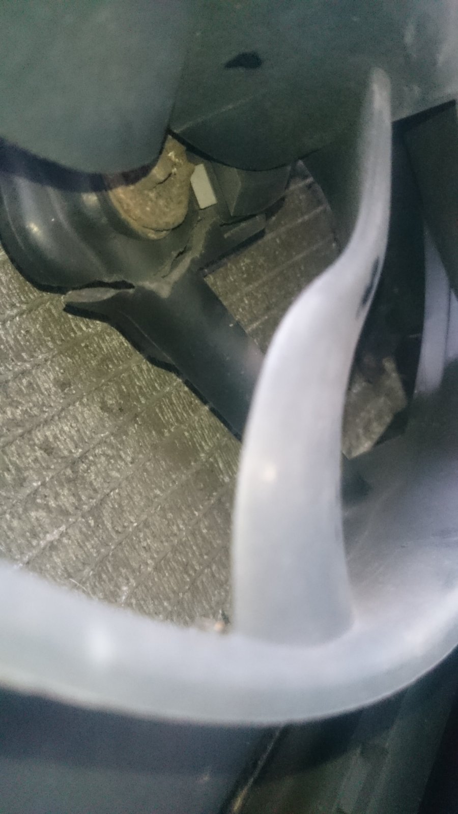

That broken part looks like a fan motor support strut, rather than a fanblade itself.
Might be repairable with Araldite and a bit of screwed-in support.

I agree the broken part in the last pic is the support strut, in the first pic the part on the slam panel looks like part of a fan blade, should have explained a bit more in previous post
