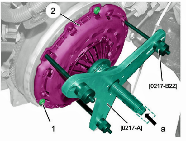

Caution: Some flywheels have open threads. Do not exceed the threads of the 3 retaining rods while screwing; Risk of deformation of the secondary flywheel.
When compressing the clutch mechanism; Do not cross hard when tightening the central screw of the tool [0217-A]. The tightening must not exceed 10 revolutions clockwise.

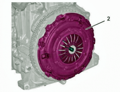

Refitting
CAUTION : Observe the tightening torque values.
Slowly compress the clutch mechanism (2) to contact with the primary flywheel (at "f").

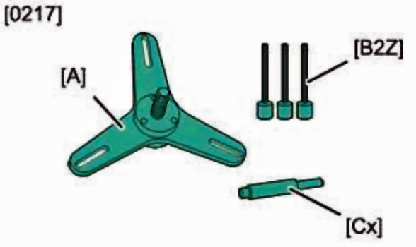

| Special Tools | |
| Ref | Description |
| [0217] | Clutch mechanism compression tool |
| [0217-A] | Clutch mechanism compressor |
| [0217-B2Z] | Retaining rod (Ø 8 mm) |

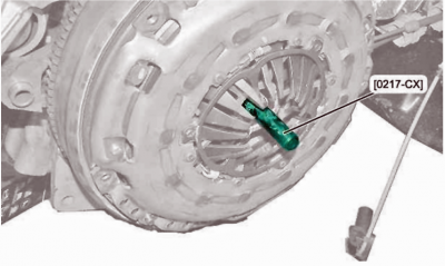

| [0217-Cx] | Clutch Centring Drift (Code [0217-C6Z] for EW10 Gearbox) |

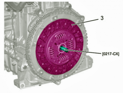

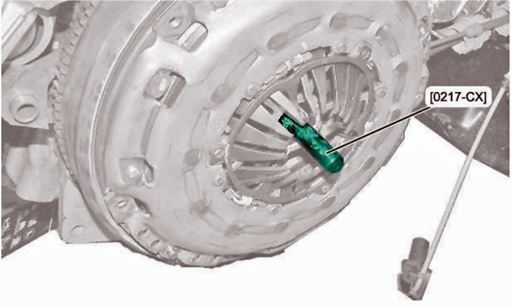

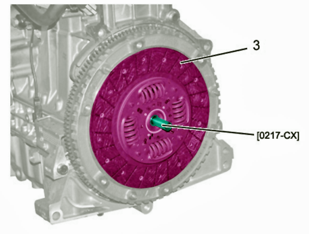

- CAUTION: In order to improve the centring of the friction plate and to eliminate engine jerks, vibrations and noise, compress the clutch mechanism when tightening the fixing bolts; Using tool [0217]
- CAUTION: Always replace the clutch bearing when replacing the clutch mechanism or the clutch disc.

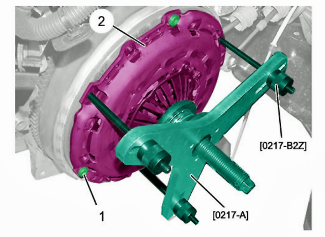

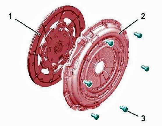

Remove the gearbox. (* See footnote)

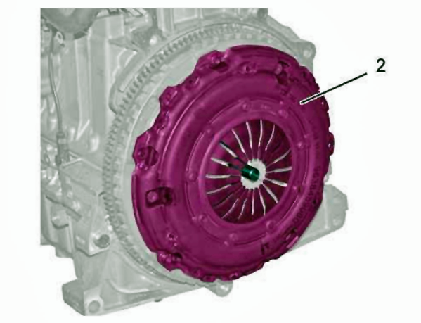

| Fit the tool [0217-CX]. | Remove the 3 bolts (1) (Every second bolt). Position the tools [0217-A] and [0217-B2Z] on the clutch mechanism (2). Screw in the 3 retaining rods [0217-B2Z] in place of the fixing screws (1) (Do not exceed the threads. |
- Compress the clutch mechanism (2) with the central bolt of tool [0217-A] (at "a").
- Finish removing the remaining bolts (1).
- Release the clutch mechanism (2) by moving the central bolt of the tool [0217-A] (at "a").
- Remove tools [0217-A] and [0217-B2Z].
- The clutch mechanism (2)
- The clutch disc

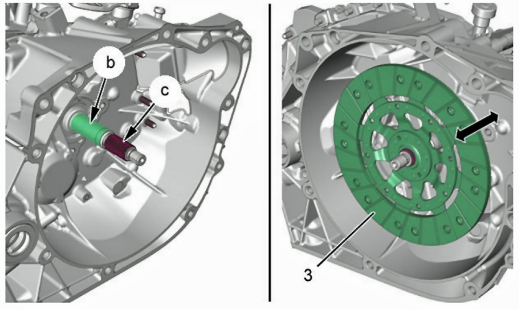

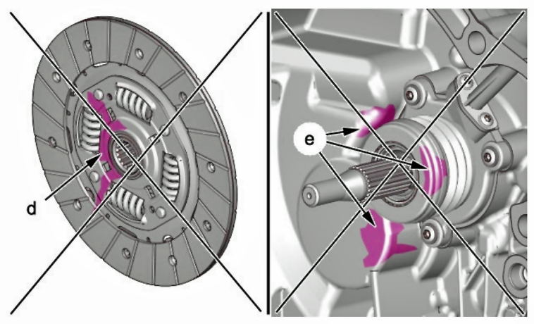

Greasing
Strictly observe the lubrication step.
CAUTION: Protect the interior of the clutch housing from splashes of grease.
| Vehicles equipped with a gearbox that has a mechanical clutch bearing Spray a little grease MOLYCOTE G-RAPID PLUS (aerosol) on the splines of the primary shaft and on the clutch bearing guide tube (at "b" and "c"). Vehicles equipped with a gearbox that has a hydraulic clutch bearing : Grease the splines of the primary shaft with MOLYCOTE G-RAPID PLUS (at "c"). Do not soil the clutch disc lining; Risk of skating. Fit the clutch disc (3) on the splined shaft and perform several translations to distribute the grease. Remove the clutch plate. |
| CAUTION: An excess of grease will contaminate the clutch friction plate and cause noise in neutral, slipping or juddering of the clutch. "d": Traces of grease present on a clutch disc polluted as a result of excess grease. "e": Traces of grease present on a clutch housing contaminated by excess grease. Caution: Clean all traces of grease that can be thrown onto the rotating friction. Remove the surplus grease on the top of the grooves and the end of the input shaft using a cloth. NB: The film of grease deposited on the rotating elements must be as thin as possible in order to avoid projections. |
| CAUTION : When refitting, place the face of the clutch disc, where the N° PSA 96 XXX XXX 80 is marked, gearbox end. Refit the clutch disc (3). Centre the clutch disc (3) ; Using tool [0217-CX]. |
CAUTION: The clutch mechanism and disc are paired at the factory and cannot be replaced separately. CAUTION: Any fitting of a clutch mechanism with automatic free play adjustment (whether new or re-used) must compulsorily be performed using the compression tool [0217]. Refit the clutch mechanism (2). N.B. : Do not remove the tool [0217-CX]. |

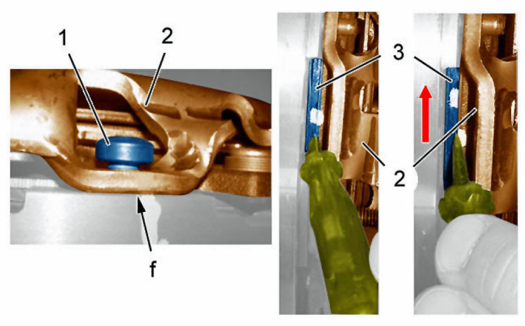

CAUTION: No resetting of the clutch wear adjustment is permitted.
Check the absence of friction:
- Apply a slight force on the clutch disk (3) to control the rotation; Using a thin, flat screwdriver
- In case of difficult or impossible rotation, continue the compression operation of the clutch mechanism very gradually until the rotation (1/8 of a turn on the tool screw [0217-B2Z])
- Tighten the 3 bolts (1) to the specified torque.
- Unscrew the centre bolt of the tool [0217-A] (at "a") by several turns to detension the clutch mechanism (2).
- Remove tools [0217-A], [0217-B2Z] and [0217-CX].
- Refit and tighten the remaining 3 bolts (1).

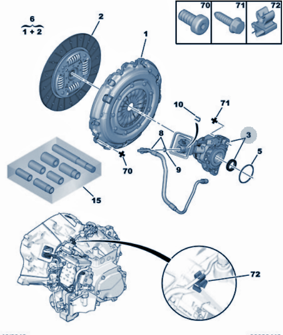

Clutch Info
Parts
Clutch Tightening Torque
Clutch Info
| Engine type | Clutch mechanism brand | Clutch mechanism type | Clutch friction plate external diameter (Road wheel side) ( mm) | Clutch friction plate internal diameter (Road wheel side) ( mm) | Friction plate type | Thrust bearing brand |
| EW10A | Valeo | 230 DNG 5100 + | 228,6 | 155 | 810 | SKF |
Parts
| Clutch Plate (2) Part: 2055HC £45.18 inc. VAT from Citroen Exchange Clutch Kit (Items 1 & 2) Part: 2051Z4 - £184.66 inc. VAT from Citroen (plus a returnable surcharge) The Bearing Buffer (3) (also known as Central Slave Cylinder) Part: 204184 is £116.11 inc. VAT |
| Clutch mechanism fixing screws (3): tighten to 2 daNm |
