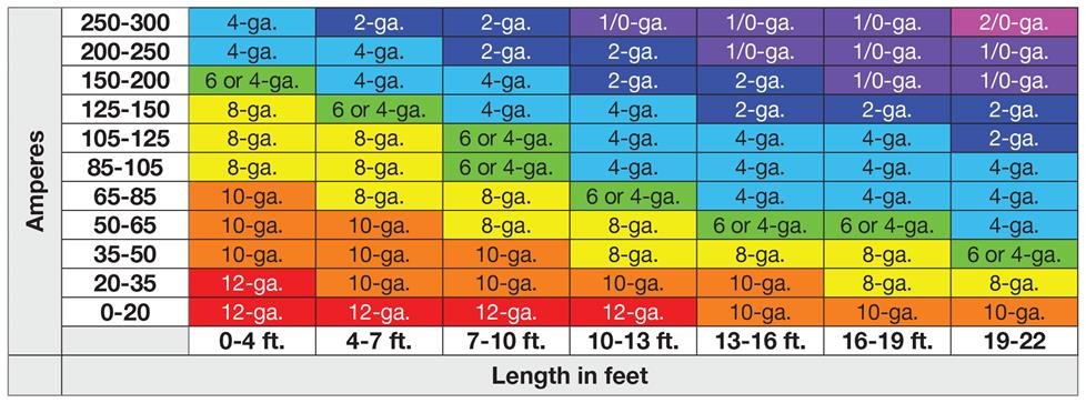

Re: Power For Amplifier
Can you give me an example? Car amplifiers are designed to be used with proper cabling and that´s why they don´t have big internal capacitors to compensate thick power cabling.
Here is one chart to determine how thick cable you need, are these all just for showing off and for selling more copper to car-audio-enthusiastics?
And I´ve seen it personally many times that lights on the dash go dim when you play loud bassy music with car audio -system that has got insufficient power cables or inproper grounding.
