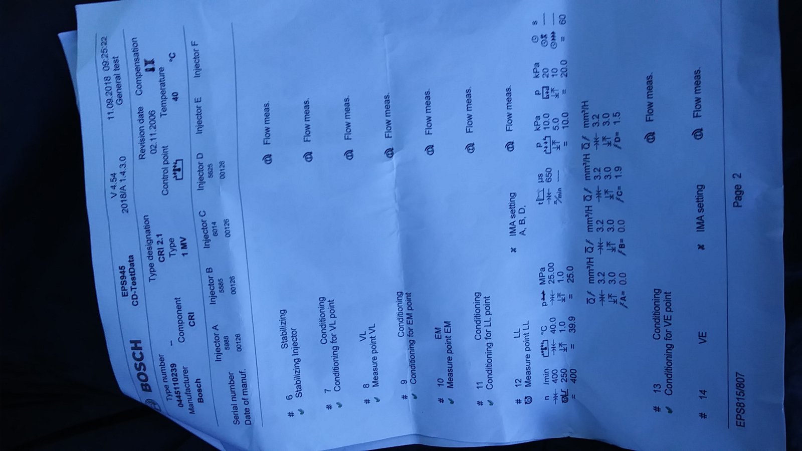

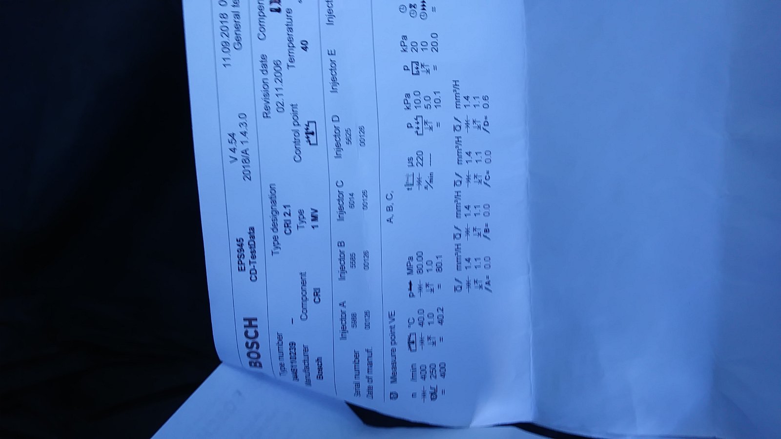

RPWC
Posts: 329
Joined: 27 Sep 2015, 12:06
x 21
Re: Diesel injector test
Unread post by RPWC »
Report attached if you can zoom in or enlarge it......
Cheers Rich :wink:

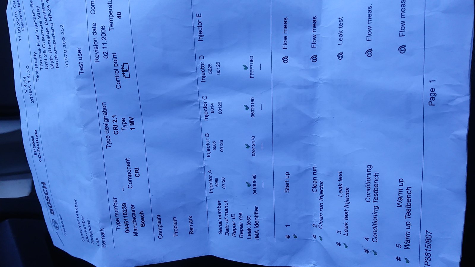

RPWC
Posts: 329
x 21
Page 3 of report.
Cheers Rich :wink:
MikeT
Posts: 4808
Joined: 11 Jun 2007, 16:17
x 232
Unread post by MikeT »
Thanks Rich. The tests do show failures on measuring points LL and VE, both of which equate to your original complaint of white smoke.
Leak test and test points VL, EM & TL all passed.
So your facing the choice of having yours remanufactured or replaced, which the garage has already advised it better (cheaper?) to replace them.
As others have said, it's unusual that all four are faulty at 90K miles. As you may know, the fuel system operates at extreme pressures and tolerances so fuel cleanliness is paramount.
