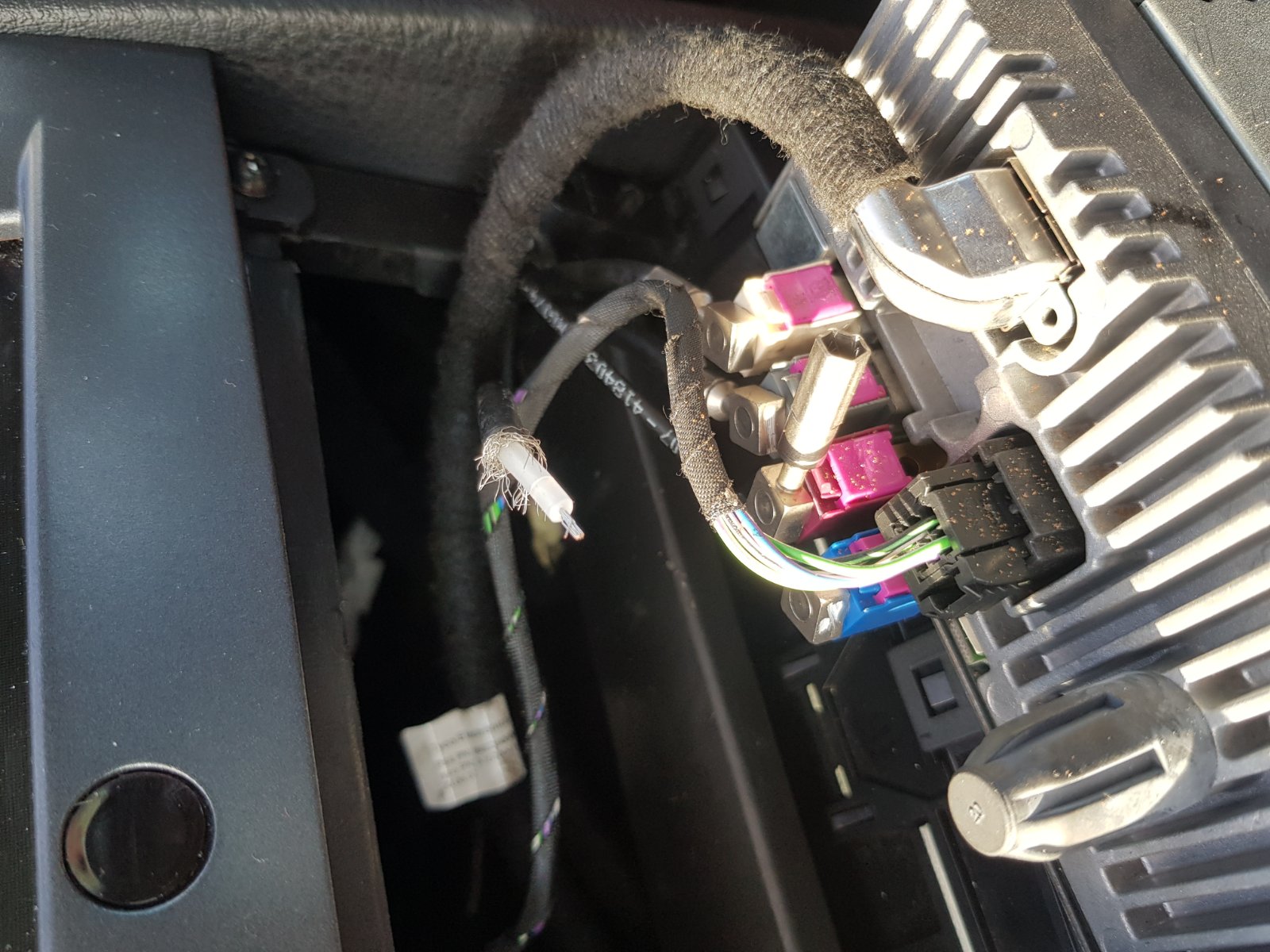

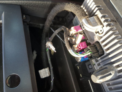

In that case you want to check the maroon coloured FAKRA connector at the back as that is the GSM antenna connection. If that doesn't sort it you can buy a cheap GSM antenna for testing purposes and if it resolves the issue just hide it in the dash somewhere.

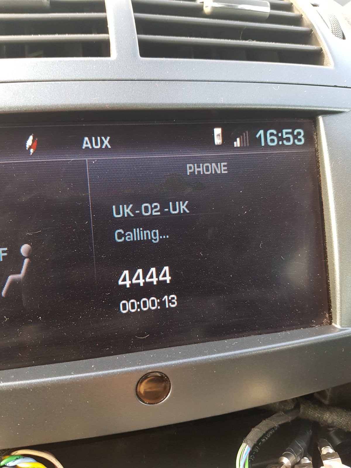

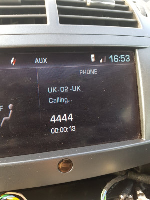

Re: Finally got a 407 coupe, but....
Fixed. Now I do the call divert thing finally

Excellent - I've seen more hair on Kojak than wires on that aerial!
