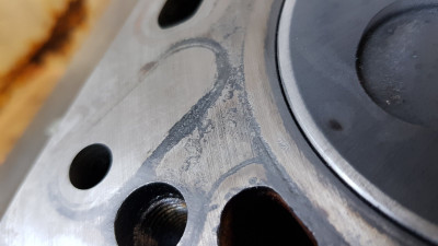

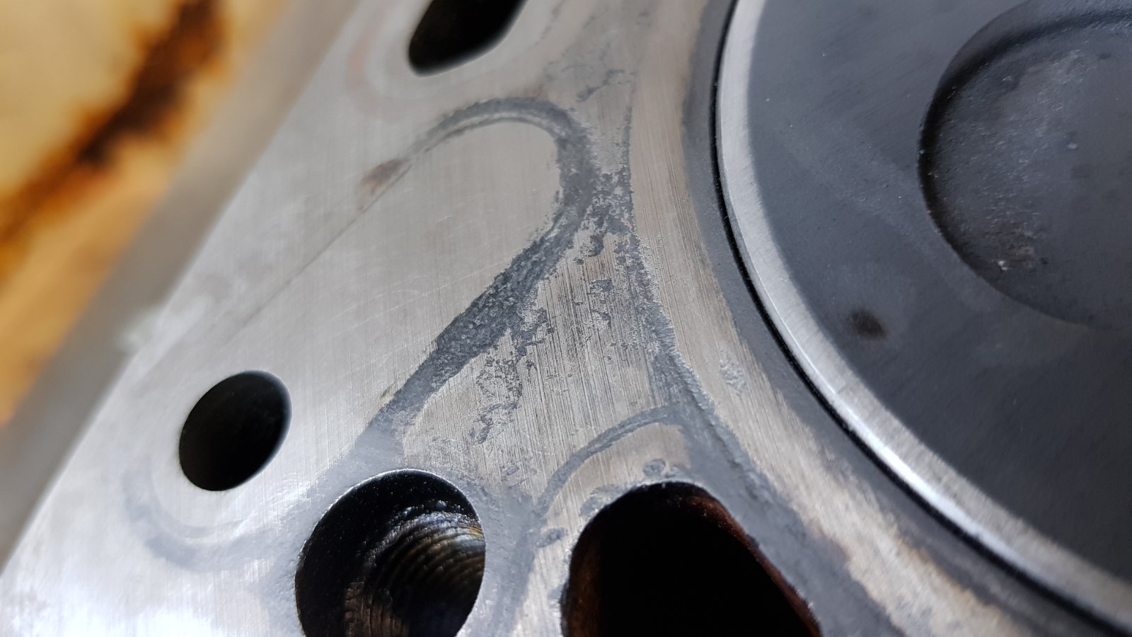

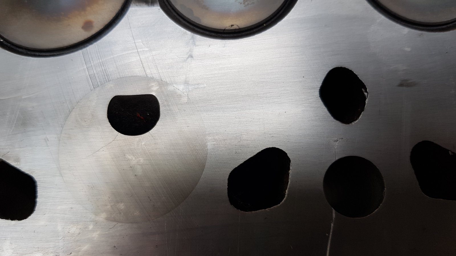

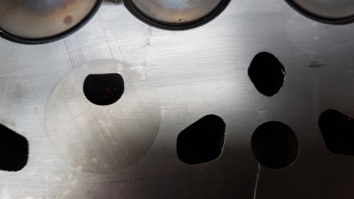

Went for the head this morning, when I had a good look at it I noticed small cracks in the steel inserts the injectors sit in and the skim has left some light scratches in the surface of the head, I'd expect some tooling marks but not to be able to feel them.?The engineer gave it a light rub with a scotch bright pad and , although still visible, can't feel them anymore...
A mechanic rolled up while I was at the shop and said these engines are known for cracking in that area and for pressurising the coolant. AFAIK there was no issue with that prior to removing the head.
Gasket was a two notch one (2 at top right with 3 beneath) engineer thinks the head has been skimmed before so I should get the thickest I can?
Here's a pic of the cracks and the machining, do I plonk the head back on or look for another? Hope you're all having a good bank holiday weekend!
- Posts: 54941
- x 8290
Re: XUD 9 oil leak
Those little cracks in the pre-chambers - the steel bits - are nothing to worry about and will not cause any issues...
They are so common as to be considered normal on an engine of that age/mileage...
Go ahead an reassemble
You have no worries that they'll cause any coolant pressurisation...

Cleaned up the surface of the block with a razor, piston protrusion is 0.7mm which according to the Haynes corresponds to the two notch gasket that was already on.

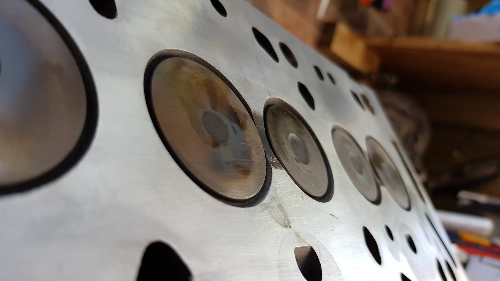

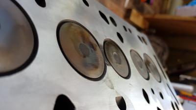

The head had previously been skimmed according to the engineer and is now past the minimum dimples... I've checked the depth of the valves and the inlet valves are 0.35mm at their minimum clearance, the exhaust valves pass a 0.85mm feeler just...
I was planning on putting a five notch 1.54 elring MLS gasket on. Will I get away with those clearances?
Also there some deep pitting on the block where the gasket had failed, any remedy to help seal this? Ta.
