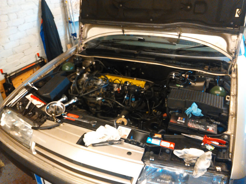

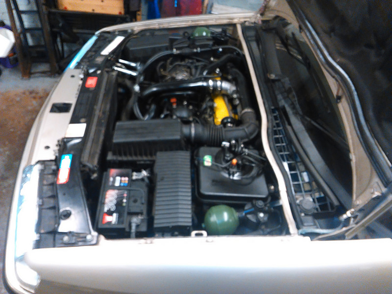

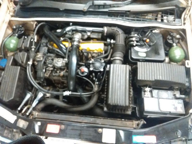

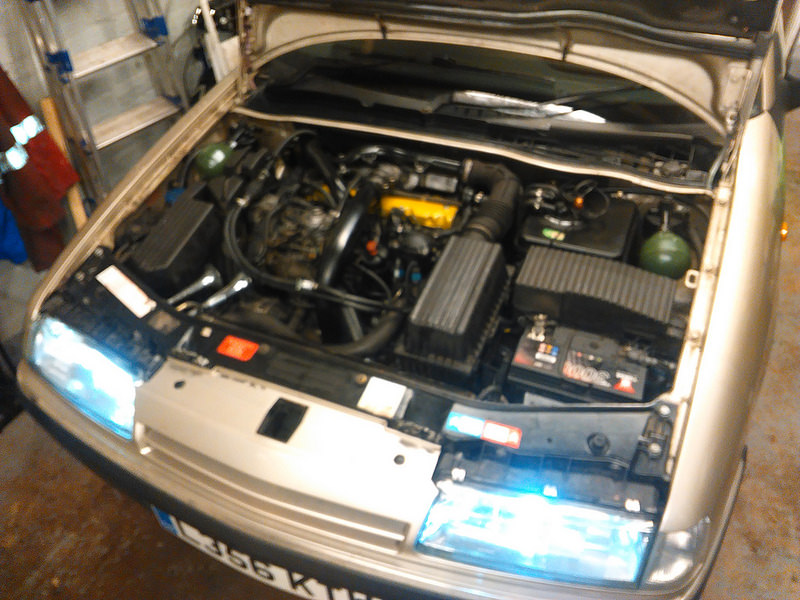

All the hard and heavy bits back in, I painted the rocker cover in gold high temperture paint I'd got originally for brake clipers until I went with green for those.. I thought the gold would cap it all off with the new rocker cover seal of course...
ImageWP_20171203_004 by Graeme McNulty, on Flickr
The dreadful camera makes the gold look like lego brick yellow! I assure you it's gold to (sort of) go with the Mk1 Xantia paintwork.
And a few blurry pics of the engine with the final bits on:
ImageWP_20171203_006 by Graeme McNulty, on Flickr
ImageWP_20171203_007 by Graeme McNulty, on Flickr
ImageWP_20171203_010 by Graeme McNulty, on Flickr

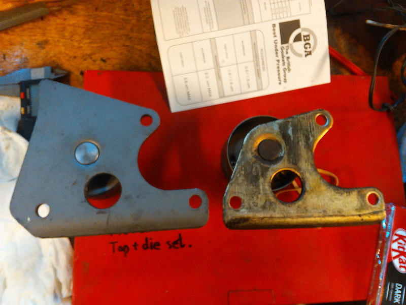

I replaced the manifold gasket of course, new thermostat, diesel filter, a good few replaced hose clips. I also fitted the timing belt idler and tensioner I'd bought last year with the belt but didn't fit at the time. The tensioner was alright apart from the battle with the spring-plunger. But the fixed roller was a different shape to the original. It has the same roller and the same fixings but has a massive back plate that when fitted, well, didn't. It fouled on the tin plate thing between the block/'head and the stuff on the timing belt side. It also fouled on the step between the idler and the diesel pump.
ImageWP_20171202_002 by Graeme McNulty, on Flickr
Anyway, in the end I simply cut the new roller back plate to fit.
