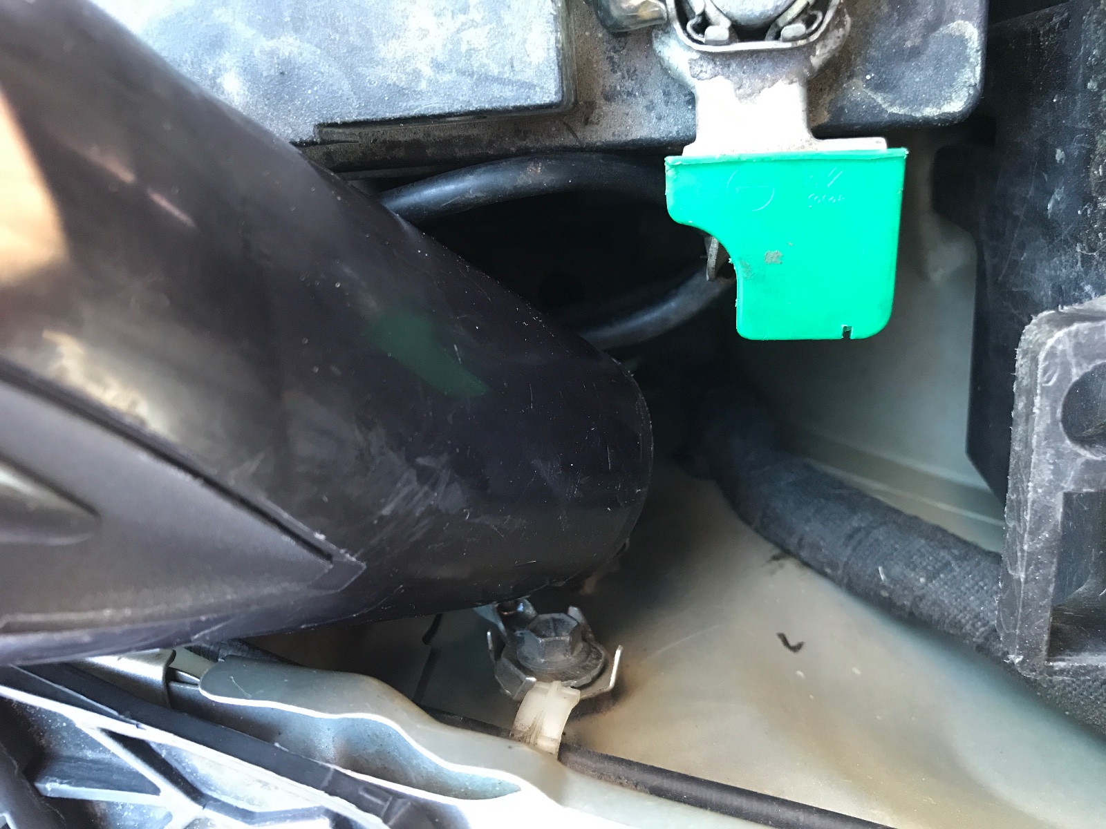

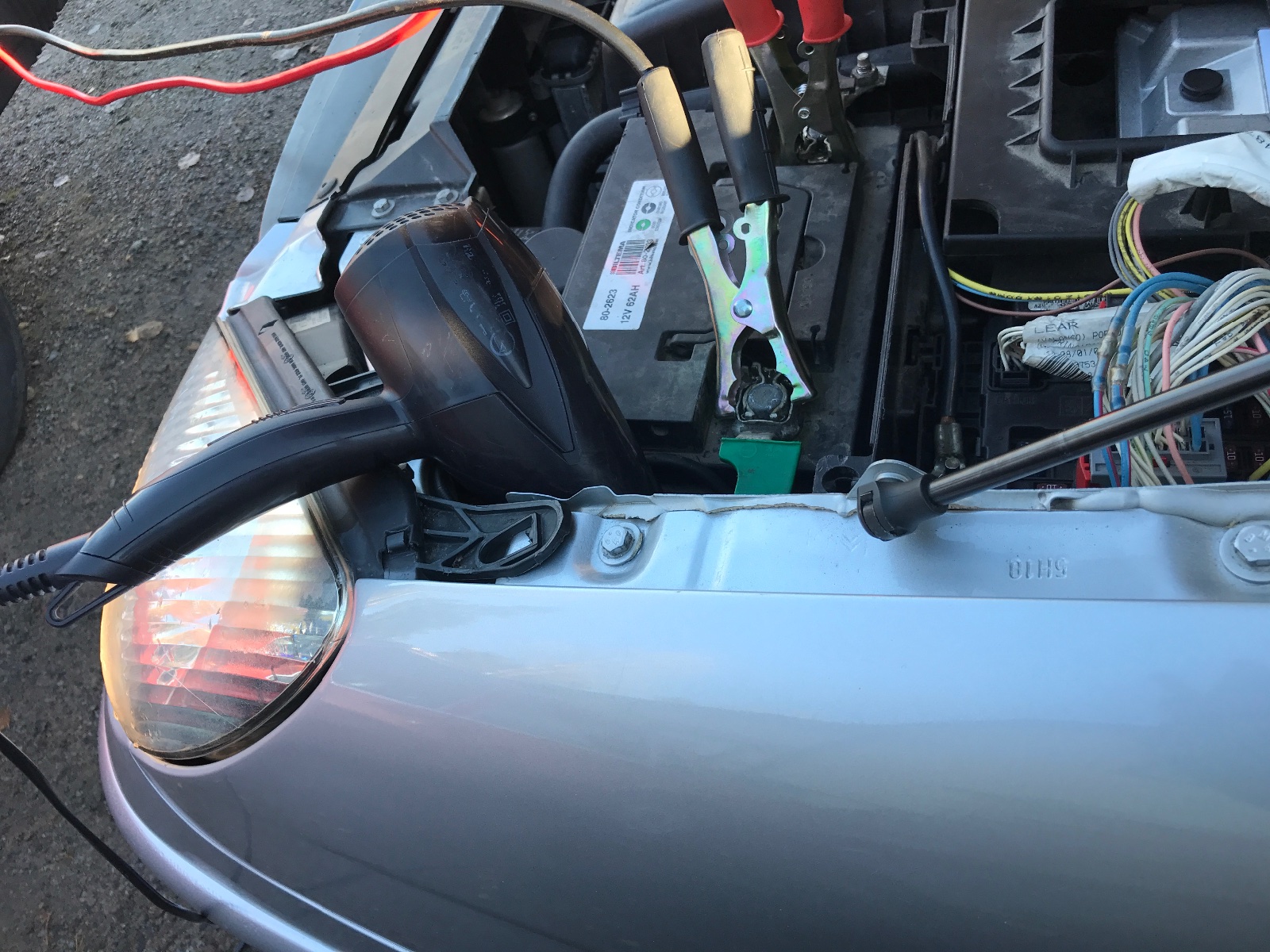

I have blown hot with a hair dryer both on the bsi in the engine compartment and bsi at the driver's seat without any results! Right now, a heat fan is running inside the car so it starts to get hot, but without results!
So that the workshop said that bsi was broken inside the car and works when the car enters the heat I do not think so!
I start to wonder if there is any temprator sensor on the engine block that makes this?

I managed to start the car yesterday! Blown first inside the car but nothing happened there! Only when I blew at the thermostatic house, the car started! Today, the car did not start again, then blew the thermostatic house again and then the car started!
