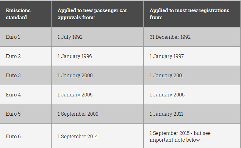

Marc & Bobbins, I was confused...stickers so I went looking and found these two pages created by the RAC, no longer confused and thanks fr bringing it to my attention.

Interesting that - according to Wikipedia which we all know is always accurate
- "The DW10B and DW10C are Euro 5-compliant, and therefore still available for sale in Europe"
https://en.wikipedia.org/wiki/PSA_EW/DW_engine
Wonder what the actual carbon dioxide emissions of the RHF variant are ? Might they actually be low enough for a lower VED tax band and the only thing stopping them is the confused paperwork from PSA ?
- x 6957
Re: Asin 6 speed auto - Clunk
That's exactly my point - I saw that RAC thing and ignored it because it meant diddly to me. The approval dates are one thing - but what about late registered cars and all that? So my 2009 is Euro 5 compliant, but like the others has a Euro 4 engine. I think I'll email them!
