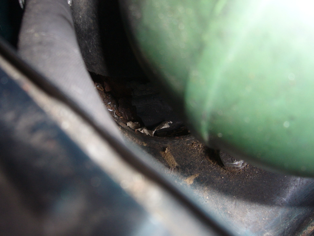

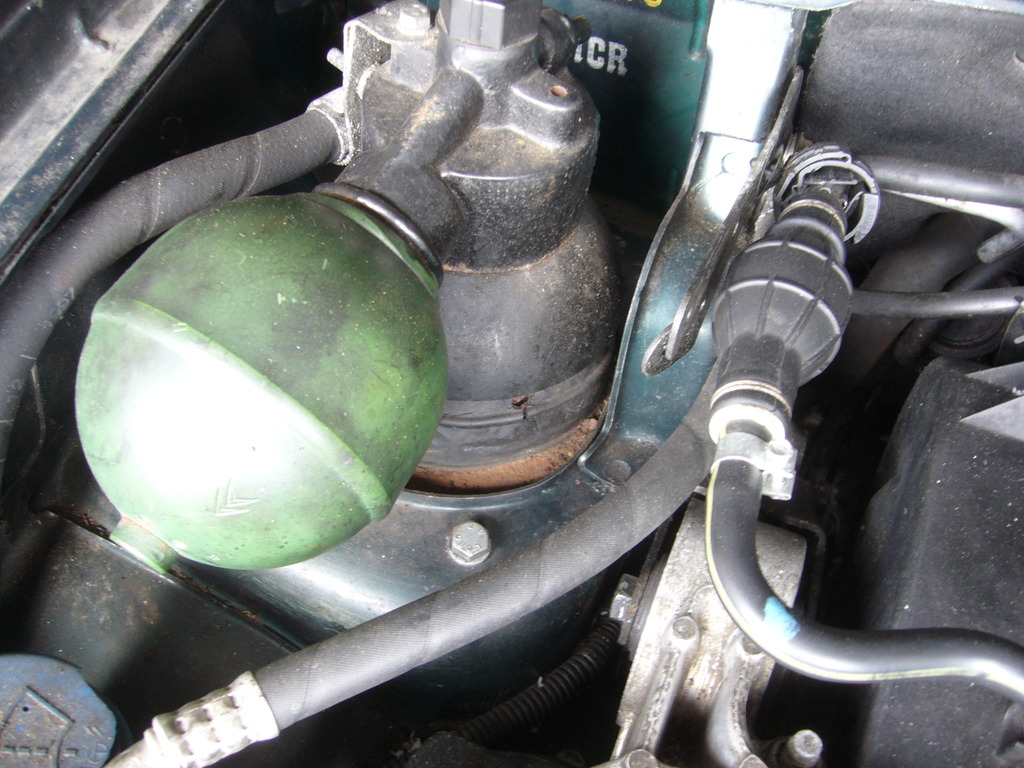

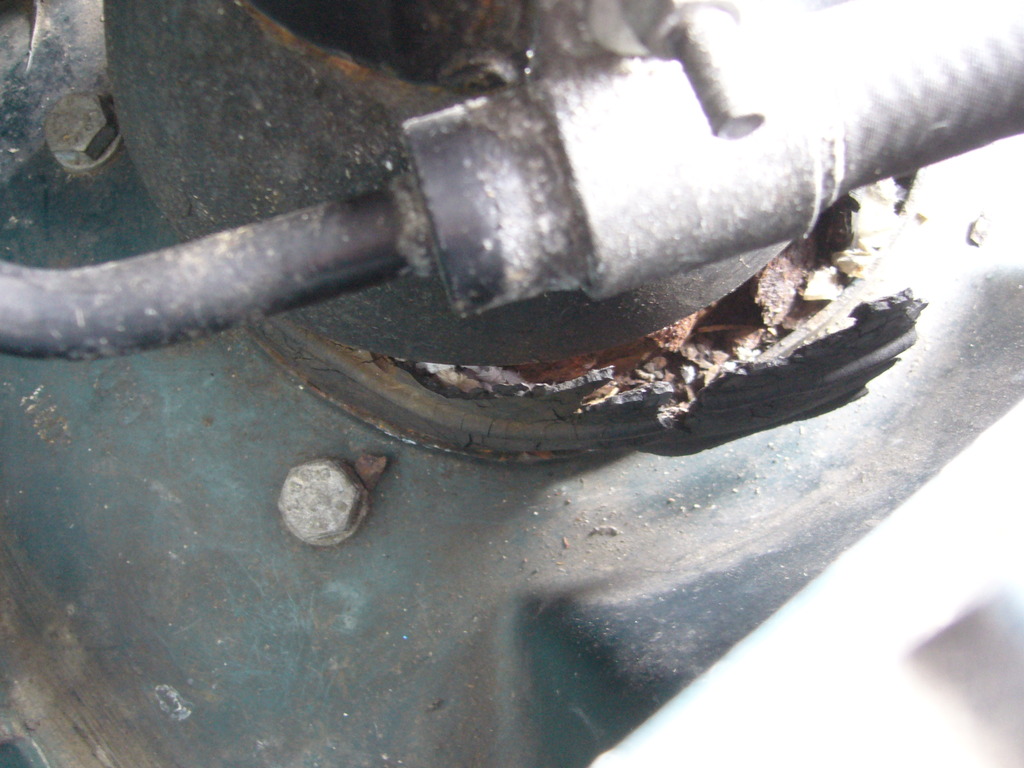

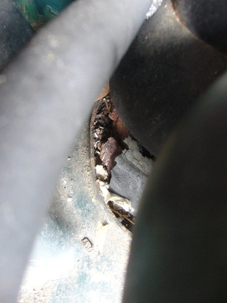

Can you post pictures of your strut tops for a second and third opinion?

Well apologies for the delay but I have taken some pictures of the worst Strut Top, which is the drivers side but it was difficult, because the sphere and piping get in the way! ... The majority of the circumference doesn't look so bad, as the rubber covering is still in place, although a bit crunchy underneath!... but the area (About a quarter of the circumference!) that is nearest to the wing is the worst, with the rubber coming away. :shock:
I had trouble the other day, working out how to put the picture link's here from PhotoBucket, which I joined for the purpose #-o but I was in a bit of a rush at the time. Anyway I am giving it another try now and hopefully they are going to magically appear below!
Well I seem to have mastered it :-D
... I might take the sphere and pipe off to inspect closer and to tidy better for MOT Man, in which case I might ad some better images later.
I look forward (I hope!) to your feedback!

That strut top is DANGEROUS Grum and is imminently about to fail!

Sorry but there is a big safety concern here Grum... Sadly, a lot of MOT testers miss strut tops... You could well take it for MOT and have it pass even thought those tops are about to let go!
It seems they normally let go when the car is parked up and rarely when in motion which I suppose is a blessing but you really don't want to take the risk...
