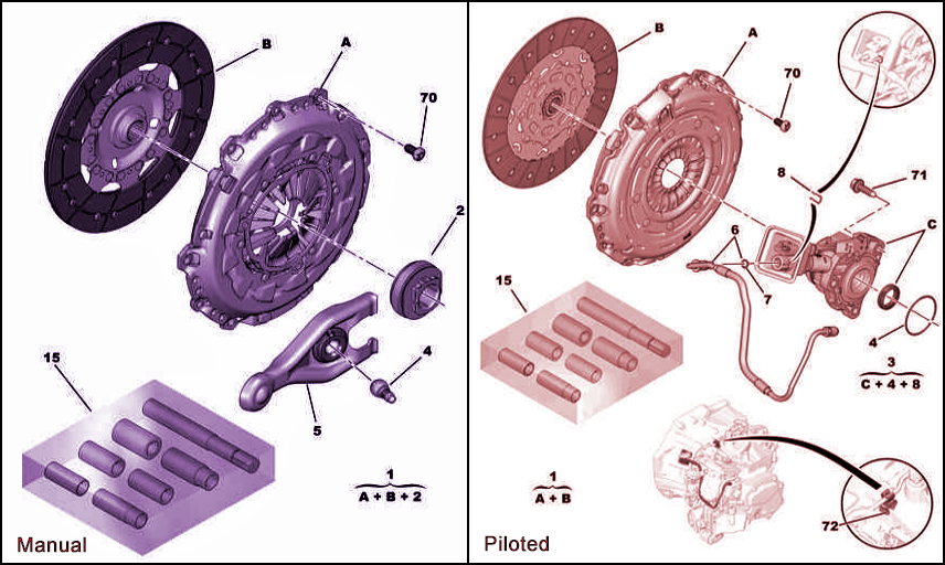

1) For those that are interested, yes, the Piloted system does have a DMF as it is essentially a manual Gearbox and Clutch.ekjdm14 wrote:a grand for a release bearing is taking the proverbial... If he's quoting to renew the whole clutch & DMF if fitted then that wouldn't be so unreasonable, but does the EGS even have a DMF and on what evidence does he believe the clutch/release bearing/DMF to likely all be knackered?
2) Here are the comparisons between the 6 speed manual gearbox system and the piloted system in terms of clutches (as you can see, there doesn't seem to be the same clutch release mechanism as the manual - so the release bearing on the piloted system is contained within (3) - the Clutch Slave Cylinder Stop. This can be seen on the second diagram - item (13).
Click on the pics to magnify
So on the manual, clutch fork is (5) and (2) being the clutch release bearing buffer.

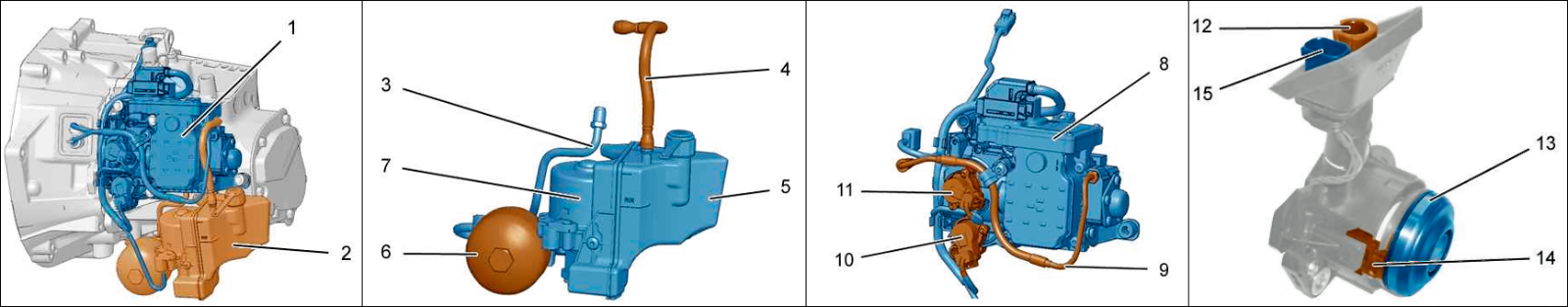

On the Piloted system item (3) is the Clutch Slave Cylinder Stop For general interest, here is what the piloted system components consist of (externally):
Click on the pics to magnify Key
(1) Actuator electro-hydraulics.
(2) Actuator electro-pump.
(3) High pressure hose.
(4) Reservoir return pipe.
(5) Hydraulic reservoir for piloted manual gearbox.
(6) Pressure accumulator.
(7) Actuator electro-pump unit electric motor.
(8) Piloted manual gearbox ECU.
(9) Decluch piping.
(10) Gear engagement position sensor.
(11) Gear selection position sensor.
(12) Hydraulic piping union.
(13) Declutch bearing.
(14) Travel sensor.
(15) Electrical connector.
As for the replacement of the Clutch Slave Cylinder Stop unit (containing the bearing), that retails at £141.96 inc. VAT from Citroen.

GiveMeABreak wrote:... yes, the Piloted system does have a DMF ...
That's interesting as the drawing of the clutch plate on the piloted system seems to show the bulges for cush springs. Now I know you shouldn't believe everything in a drawing but is this possible? A DMF plus "conventional" clutch plate? Or not a DMF after all?
- x 6945
Re: Gear box problems
There are 2 different DMFs - slightly different design from the diagrams
The one for my 2.0 manual requires the 8 bolts replacing, whereas the Piloted one does not.
