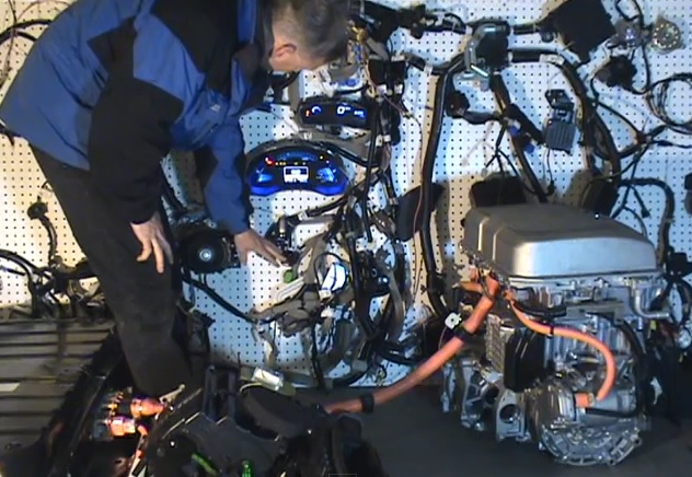

To give you a better idea of what the donor is, this is a later model Leaf laid out and running on a peg board. The motor, controller, inverter are all one silver block on the lower right, the motor is the lower third with an output at the rear with the S shaped orange cable going to it, the middle section where the black module is has a cooler and controller. The upper part where the orange cables go with a cover is the inverter.
In the earlier version of the leaf that I have these are all seperate.
The battery pack is on the left, the heat pump with the green parts for interior cooling heating are at his feet. The parts that aren't in shot are the charger cooler and 12v car battery. It is also not running a radiator or the electric water pumps as this is the only fluid other than the Brake fluid.
Alot of conversions trim off alot of items they don't want, but the whole car runs and operates with all of the things you have in the Leaf, heated seats, sat nav, keyless entry, quick charging, automatic climate control, cruise control, ABS, 360 reverse camera. You just unplug it, remove it, earth it and it still thinks it is a car.
