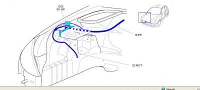

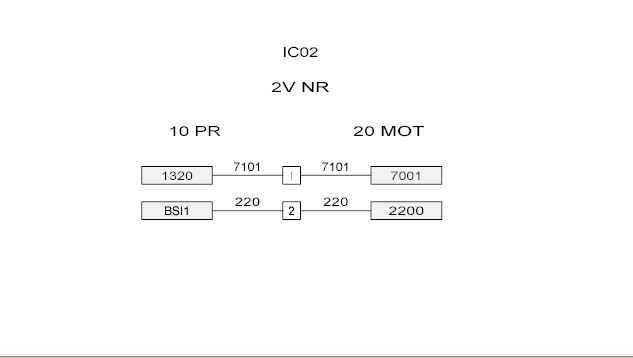

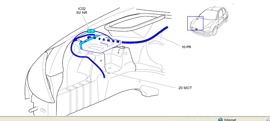

IC = Interconnector & the one in question is a 6 way black, the previous diagram shows it to be in the vicinity of the ECU.

Ok today I have traced that wire from pin 13 on the 16 way connector it is light blue, it goes behind the cylinder head and out the other side of the engine in to that IC 02 connector and comes out the other end of thee connector a purple wire to the F4 on the engine ecu, My test leads on my ohms meter are reading 0.4 ohms before I start, Testing the wire just before it disappears behind the cylinder head it reads 0.6 ohms, but when it comes out on the left hand side it reads """7.9 ohms"""", could this be the problem, what I don't know is it one complete wire right to left ?. or does it go somewhere else so it would give me these readings?.
