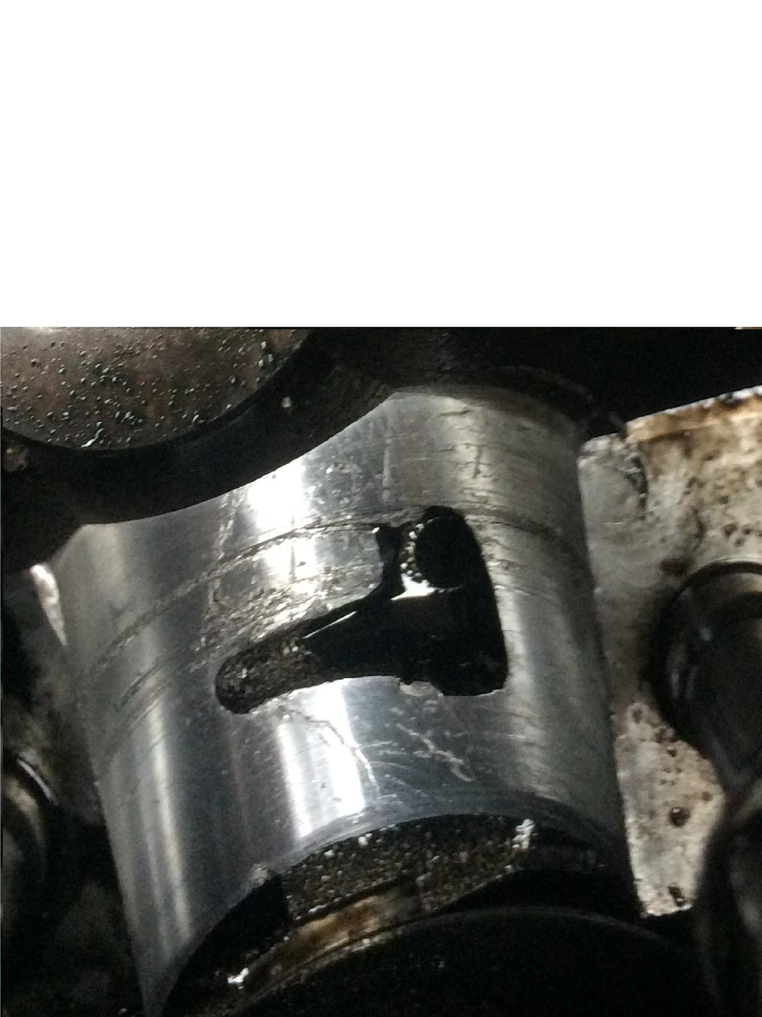

I hold vainly onto that hope, Xantia V6... And I agree Jim, I think the piston crown hit the valve, thus snapping the cam & causing the engine to fail.

xantia_v6 wrote:I have seen an (old) ford engine that looked like that, and the only bottom end damage was a broken piston with a detached crown. The rest of the piston and rings were still happily traversing up and down the bore.
Now given the construction of diesel pistons, there's a chance that may have happened here... I'm not sure which one it is but I believe one or more of the XUD family may have steel piston crowns on aluminium skirts...
In such a piston there is a good opportunity for such a failure to happen.

I do hope so Jim... Just a quick addition/correction. In my tiredness I stated emphatically that it was the inlet valves that had hit the pistons but now I've rested a while and look again it's quite obviously the EXHAUST valves that have clashed with the pistons. And looking at the valves in the head, they do seem a little bit clean even for running on veg...
So, as seller noted, cam timing probably has slipped initially, pistons mated with exhaust valves, very shortly after this the piston or rod on #1 failed also, the piston flew up and snapped the camshaft & the engine stopped...
Got to take the kids out so no "playtime" that I can forsee today, but when time allows I will be ascertaining exactly what has broken downstairs and posting back. I'll try and have a look what construction the pistons are too, be nice if it is that simple.

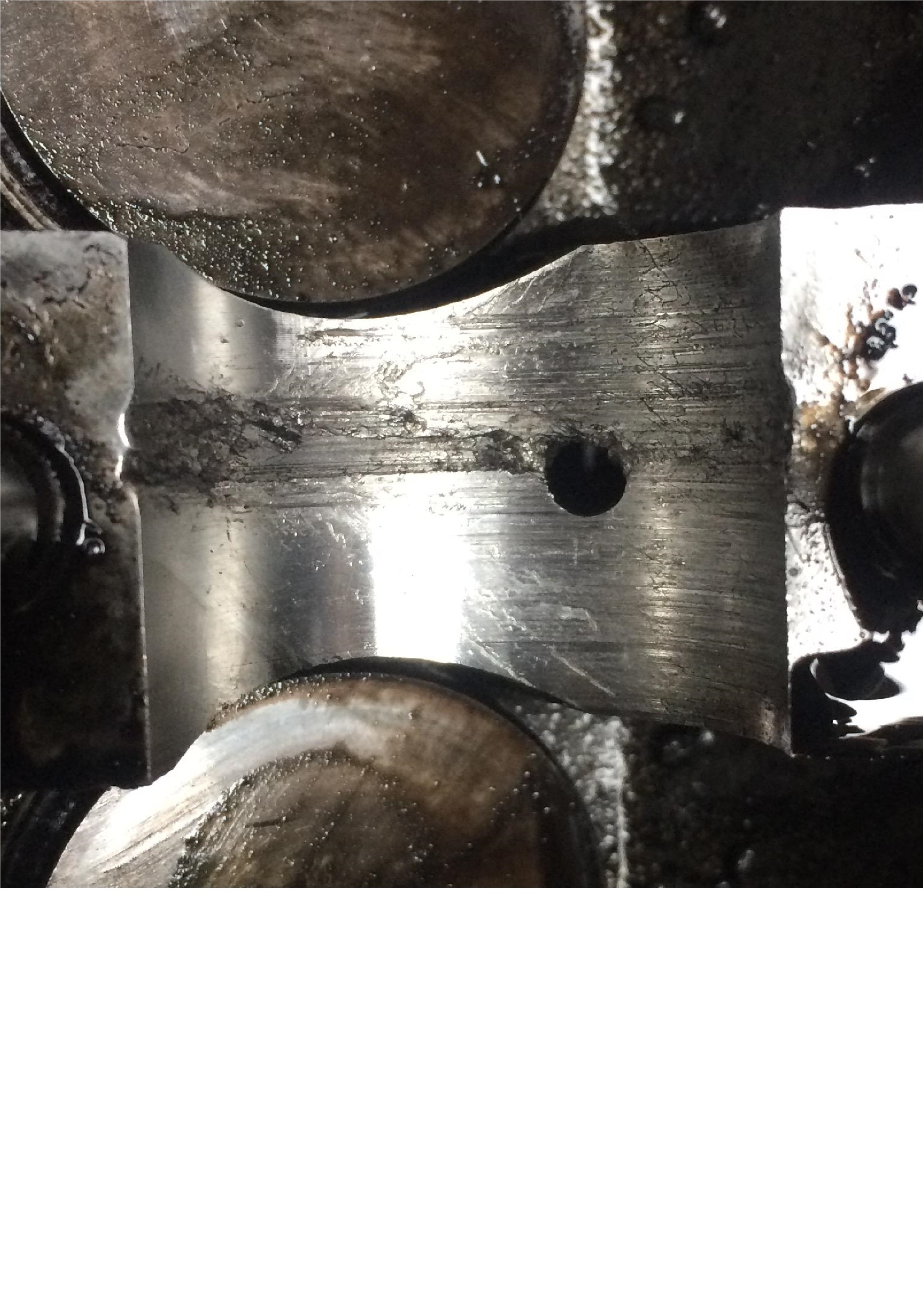

Yes that is hopefully possible this afternoon so will update later. Hope it's nothing too bad as I'm in two minds as to if the head may be serviceable with a new cam and caps. What are your thoughts on the bearing damage pictures? Thanks

That head, based on the bearing journals is verging on borderline. Can we see some higher definition pictures?

Just had a play with the original pics, they seem to have zoomed in alright but will try to get better if need be... My "gut feeling" is that it may just be salvageable, since the really nasty bits of the scoring don't extend the full width of the bearings.
The worst of them is the centre bearing, the far side hasn't suffered quite as badly.
would be nice to save it if possible...

I reckon they’ll do another turn with a bit of care. Main thing is they will not cause a serious reduction in oil pressure... The first is a bit marginal in that respect but it might be worth experimentally filling the pits and gouges with chemical metal...
