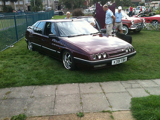

I can assure you, my grandchildren will bury me in this carMandrake wrote: Not to be cheeky, but is a coolant life of 20 years without changing it, at roughly 10x the price of normal coolant worth it for a car that's already 20 years old ? Are you planning on keeping your XM until it's 40 ? Because I'm not planning on keeping my Xantia that long.
photo(96) by Deanxm, on Flickr

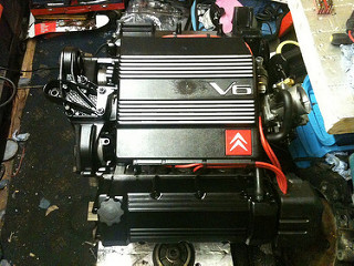

photo(35) by Deanxm, on FlickrWater and oxygen is required, like the fire triangle you only need remove one but no i would run it with the cap on as it doesnt seem to pressurise anyway.Mandrake wrote:But is it a good idea to run it open vented even if boiling isn't a risk ? An open vented system exposes the inside of the cooling system to a constant fresh supply of oxygen which can promote oxidation, whereas a sealed system has a small quantity of oxygen in the expansion chamber but once that is "consumed" no more can get in unless the cap is removed.
