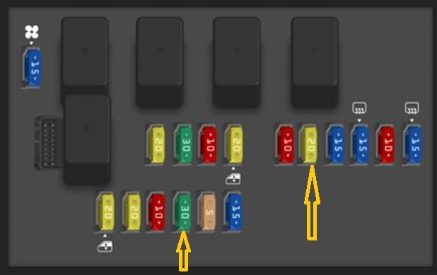

The one reference I found for a MK1 Relay has this fuseboard layout. The two fuses I have arrowed in orange are both labelled special equipment whereas all the others have actual functions not including the wipers. So they may be off one of these, more likely the 30A I would think but worth checking both. :)

Thanks for the info Mick. Just looked at both fuses and both are ok. I really am at a loss
