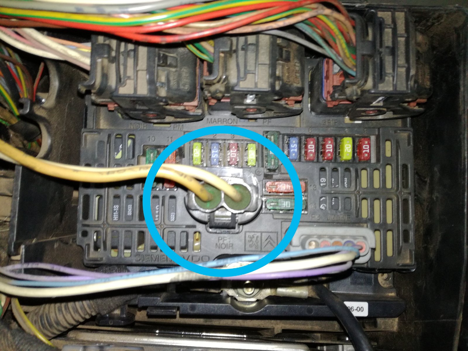

Justin_Brown wrote: 09 Nov 2017, 18:51 Thank you,
I'd appreciate that.
I would rather establish that it is indeed the fuse box before I incur any unnecessary expenses.

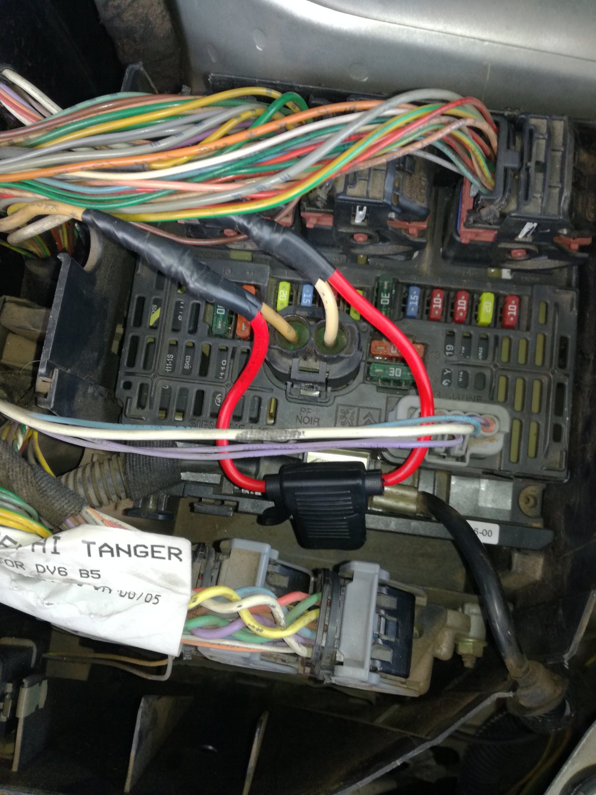

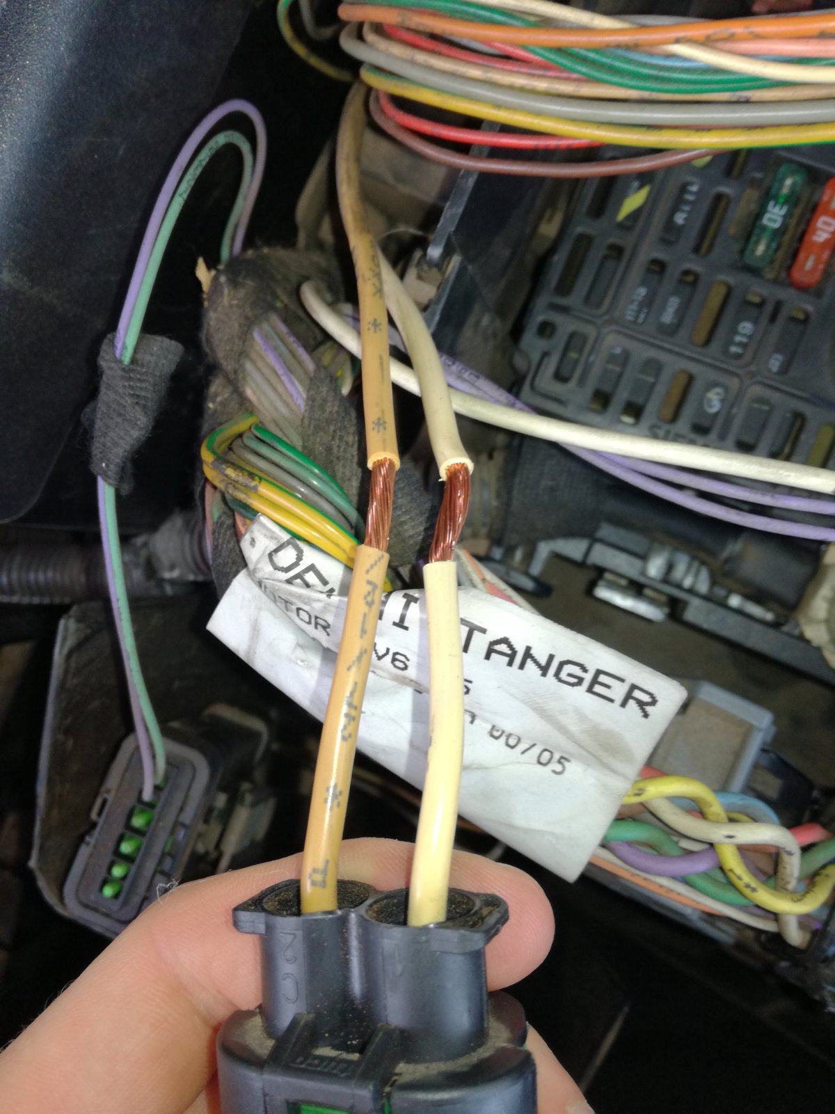

Justin_Brown
Posts: 18
Joined: 08 Nov 2017, 16:34
x 4
Re: C4 heater/air con not working
Unread post by Justin_Brown »
Hi Fayez,
Without cutting the circled wires I simply used a stanley knife to remove about a 7mm section of insulation on each of the two wires. After which I soldered in an inline fuse holder and taped up each of the soldered connections with electrical tape. (If memory serves I think I used a 30A fuse)
+/- isn't a problem as it is only a single pole and all you are doing is bypassing the relay switch. I have subsequently replaced my faulty BSI unit as I started picking up many other strange electrical issues. But I made use of the above fix for more than a year with no problems.

I had the blower issue on my 55 plate C4, i did the bridge trick and all is still well over a year later.
Mine is not the Auto A/C but manual 4 speed blower but by doing the bridge you bypass the relay, this relay is meant among other things to avoid having the blower kick in when the ignition is switched on.
If you switch the blower and A/C off before you turn the engine off does it behave as normal when you start the engine and turn the blower on ?
I think you may just have to live with the limitations provided by the bridge trick, with the A/C and Blower on when you switch the engine off there may be an ECU that has not shut down properly and when restarting the engine it shuts everything down, only guessing just trying to think logically.
