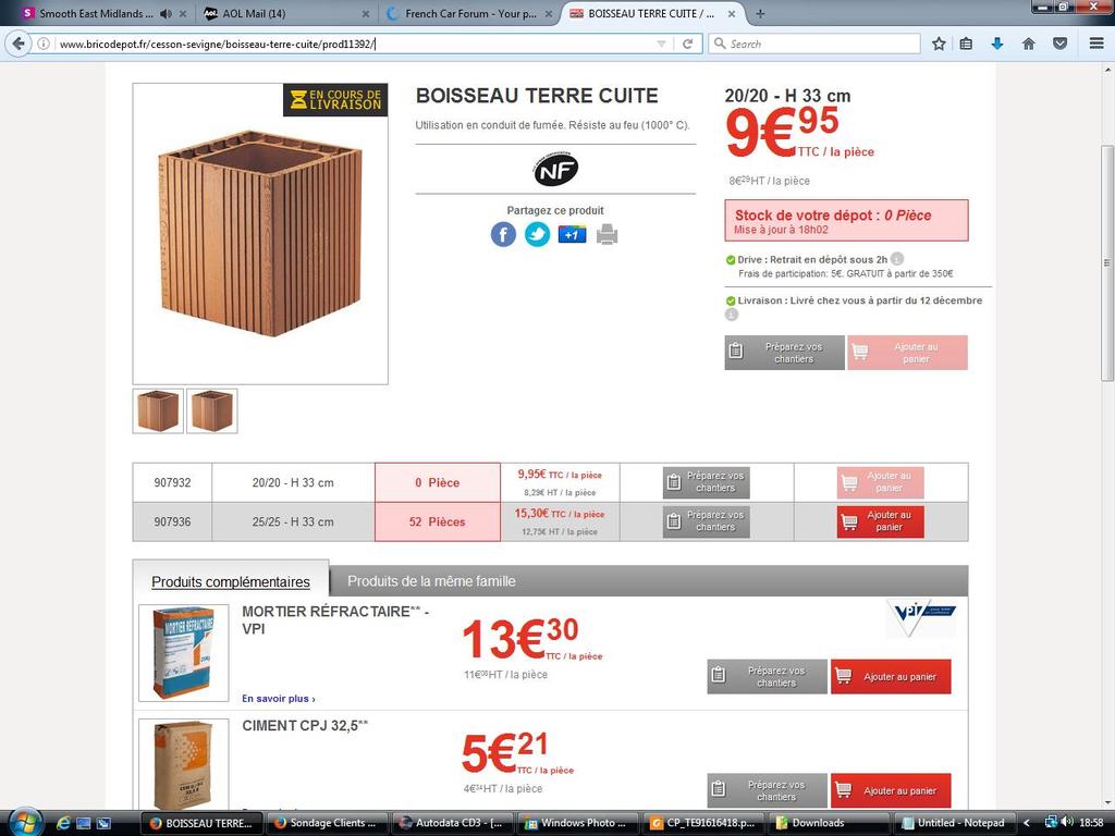

yes , while a stainless flue would work most of the time, in cold weather the steel would get too cold and when attempting to light the stove you would get negative pressure and it would smoke like a pig indoors.
Its not that we are expert on this - more that we have made all the mistakes along the way !!! :(
After we chucked our outdoor steel pipe we installed these - they are not expensive here and the chimney goes up very quickly. They must surely be available in the UK ??

We have about 6m of 5" stainless flue, which I ran up our brick chimney, after the first 1m, which is rigid vitreous enamelled steel. To avoid condensation issues (especially when lighting) and deposits of resins (wood burning) I wrapped the stainless flexi flue in glassfibre insulation. Your terracotta blocks look designed to tackle the same issue. A really smart way to build a chimney!
