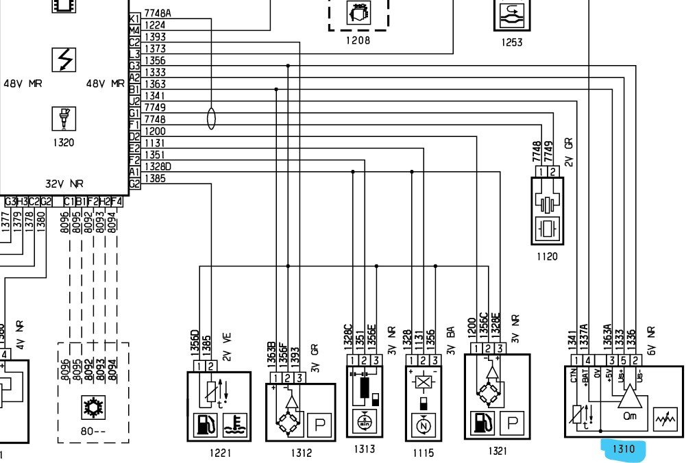

With the exception of pin 4 which goes to the under bonnet fusebox the other wires go to the 48 way Brown plug of the ECU. I believe this will be the middle one.
Pin 1 - J2 of 48 way Brown
Pin 2 - G3 of 48 way Brown
Pin 3 - B1 of 48 way Brown
Pin 4 - 10 of 16 way Black in under bonnet fusebox
Pin 5 - A2 of 48 way Brown

Hello wheeler, i will check the car this weekend and ill leave my feedback if i was able to track the problem, thank you very much
