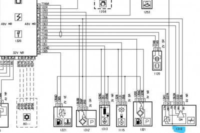

C3 1.4HDI 16v Pin assignment in MAF sensor plug

sorry, should have asked what your engine code is? it is the 6th, 7th & 8th digits of the VIN. it will probably be 8HY. Can you also tell me what ECU you have? should be on the label on the ECU case, I'm Guessing its a Delphi C6 system?

Re: C3 1.4HDI 16v Pin assignment in MAF sensor plug
VIN has 8HY
And ECU DELPHI R0411C023A
Thanks in advance for your time

wheeler
- Posts: 7933
- Joined: 21 Sep 2002, 19:07
- x 1057
With the exception of pin 4 which goes to the under bonnet fusebox the other wires go to the 48 way Brown plug of the ECU. I believe this will be the middle one.
Pin 1 - J2 of 48 way Brown
Pin 2 - G3 of 48 way Brown
Pin 3 - B1 of 48 way Brown
Pin 4 - 10 of 16 way Black in under bonnet fusebox
Pin 5 - A2 of 48 way Brown

rukadesigns
- Posts: 4
- Joined: 18 Aug 2020, 17:51
Hello wheeler, i will check the car this weekend and ill leave my feedback if i was able to track the problem, thank you very much
