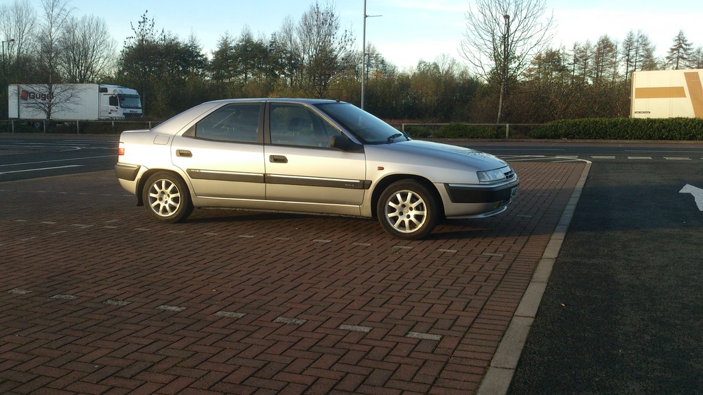

Re: New Xantia!
The photo is from a few months back - the front wing seen in the picture has had a rubbish repair done by a previous owner and has body filler repair from where the missing mudflap had corroded the lower wing. It's not dreadful but it is visible if you know it's there. The front bumper has a crack in it that aso affects the 'chrome' insert that had been touched up with silver paint (prev. owner).
Also has new front and rear number plates, flywheel sensor and repair to the driver window 'one touch' switch.
