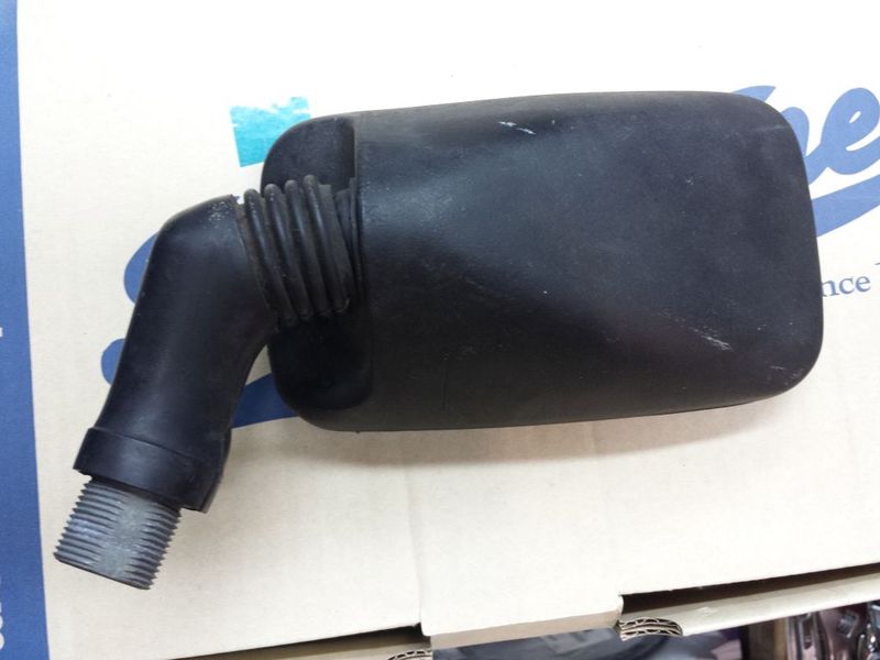

Right - LH streamline mirror has arrived from Germany - a reasonable condition secondhand, paid around 30 Euro. About half price compared to brand new (pattern, I presume) one from Französische Klassiker Onlineshop.
I'm happy with what I got, I just need to sort out the gasket - made one out of Sugru, hopefully will work with some RTV.
So I just need to swap it out, a couple of things to sort out 1) to make up a washer to hide the big gash by the hole and 2) something to cover up the hole I made for manual remote lever on the door card...
I think the streamline mirror is a tad smaller but is convex so that's good.

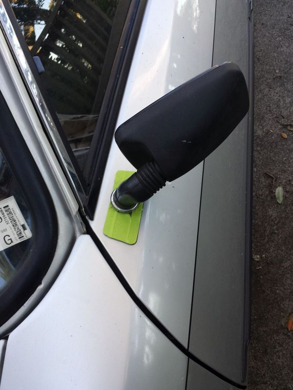

A bit of success after messing about.
LH streamline mirror, as received.
Installed - I needed the cover plate to hide the mess I made. It's a titanium sheet cut to remote mirror base and remote mirror gasket underneath. It has masking tape on 'cos I need to seal around the edges with RTV.

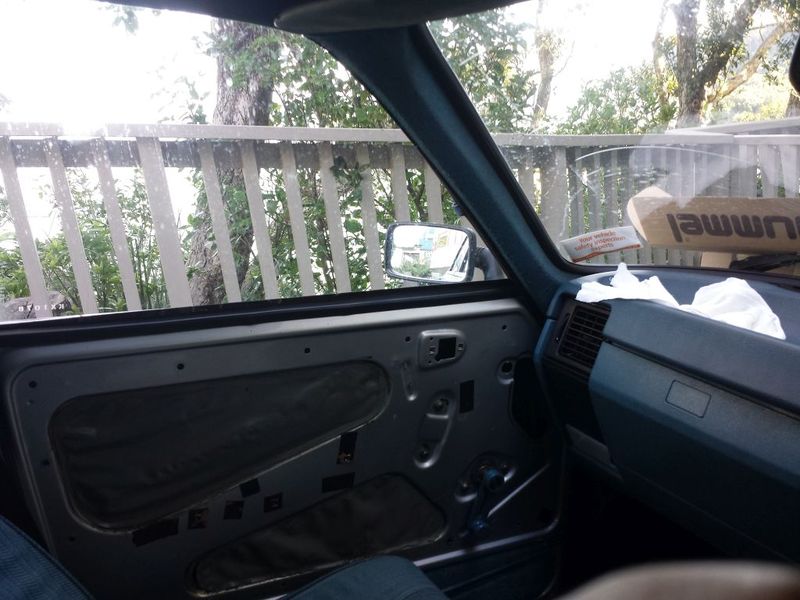

As seen from the driver's seat. :!:
It seems to have a spring loaded arm so you can fold it if you want to. But you have to fold it holding the arm otherwise you'll have to adjust the mirror every time, which is a pain.
I still don't know if remote control mirror can be used or not, haven't managed to confirm if there is another welded female threaded fitting.

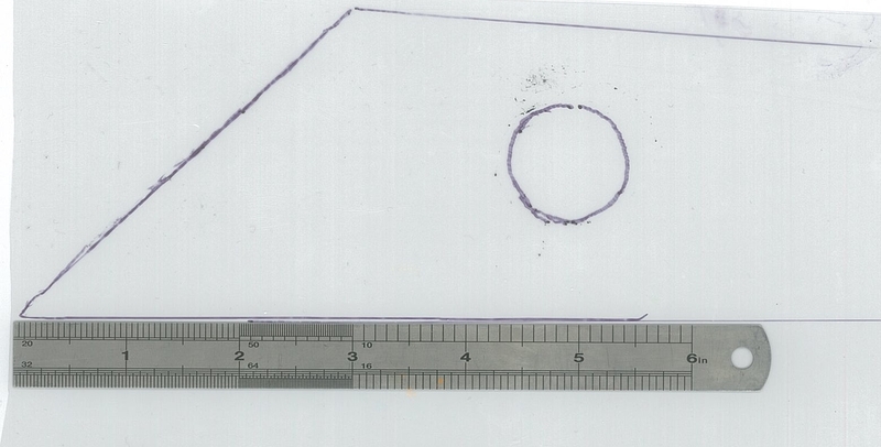

Here is the template. The hole is the thread diameter so you might want to drill a tad larger.
