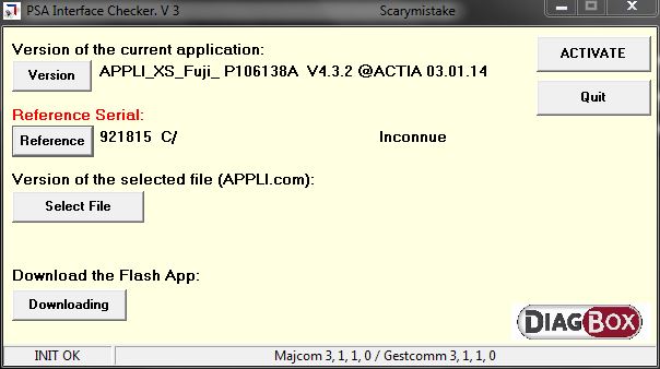

I checked the FW and REV with the PSA Interface Checker. Its a 921815C unit. Firstly it had the 4.1.3 version FW, and after I started the DiagBox it succesfully updated it to v4.3.2 - i'm going to use DB v7.58 for the moment, i don't think that I will update it to newer one in the next period of time. As soon I'll have an opportunity to test it with a C5 or 307 (is there some restriction, or the cheaper one aren't able to communicate with all of 307's?) i will test is for sure, we will see
There wasn't any stickers on or inside the box, I already opened it , there were just the 4 screws on the box and then it came apart. As i saw, it's a full chip one with NEC relays as the description says in on the sellers page. See this link for the pictures on my onedrive if you're interested, maybe you will see something that I wasn't able to see. https://1drv.ms/f/s!AiVAq0RbLtLvh4V8OyrEo1A1qk-j3Q

Ok, so far so good! Keep to 7.58 and you should be fine.
