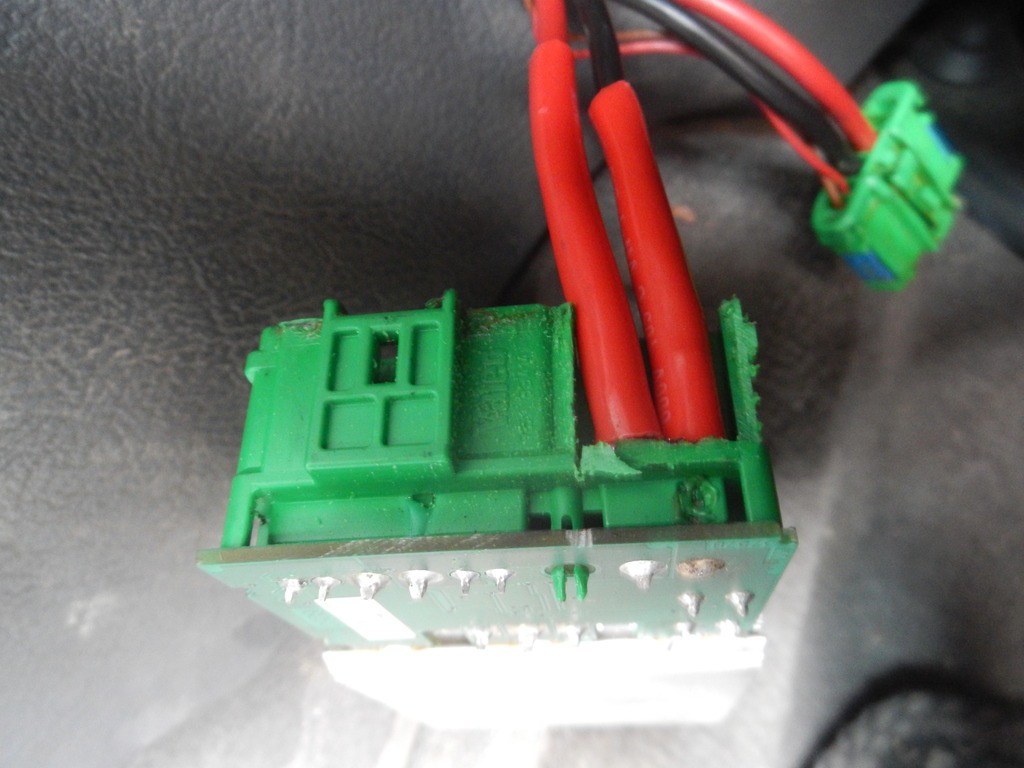

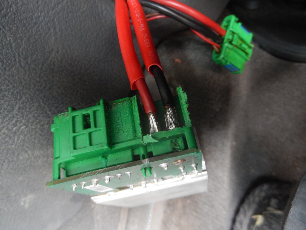

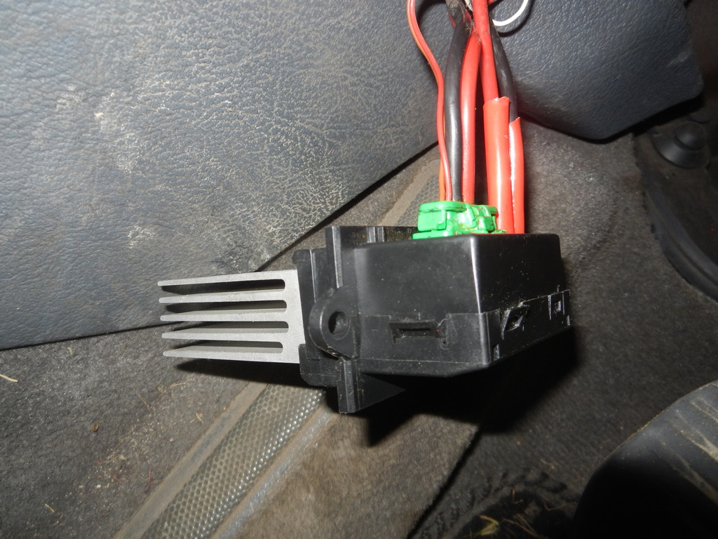

Heater fan investigation, pulled out resistor pack, showing signs of overheating on right side of multi-plug.
I've cut open the socket and soldered the wires on direct, also re-soldered the pin into the printed circuit. All working again, ( I think next time I'm down the breakers, I'll pick up a spare resistor pack and cut off a section of loom, as I could be revisiting this again in the future.)
