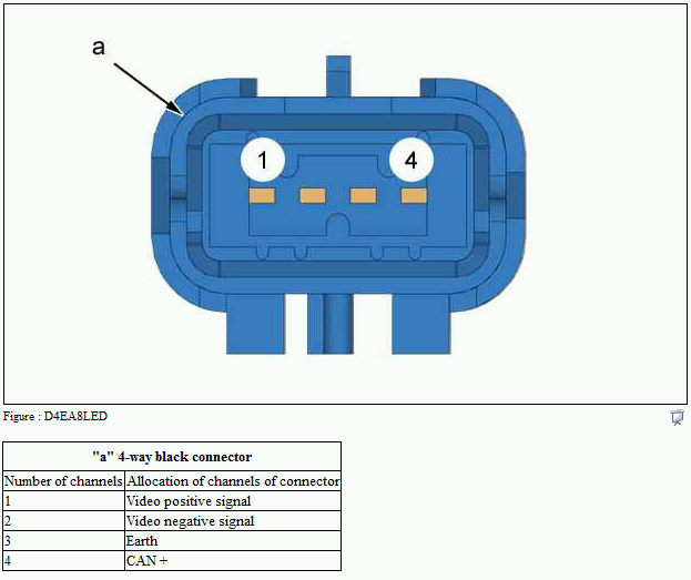

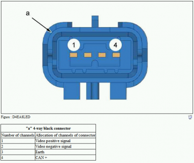

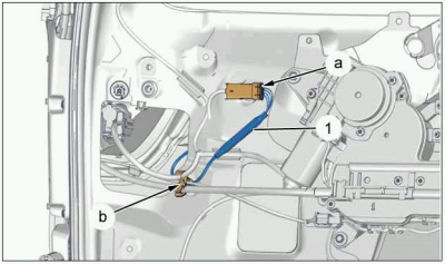

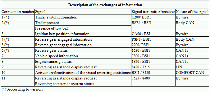

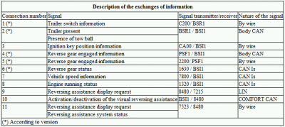

OK - I can't help you with the unit as I don't have this - but in case this helps here are the following:
There are no parameters that need configuring for the camera AFAIK and according to the docs, apart from the obvious settings in Diagbox for the type of reversing assistance. Two other things - I assume you have a CAN compatible camera and wiring, and secondly, that you have tried it with engine running, in reverse, tailgate shut?

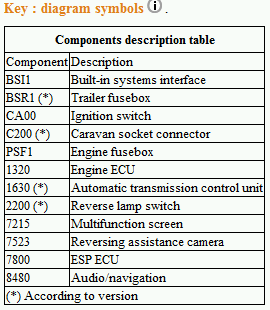

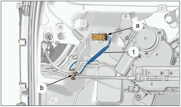

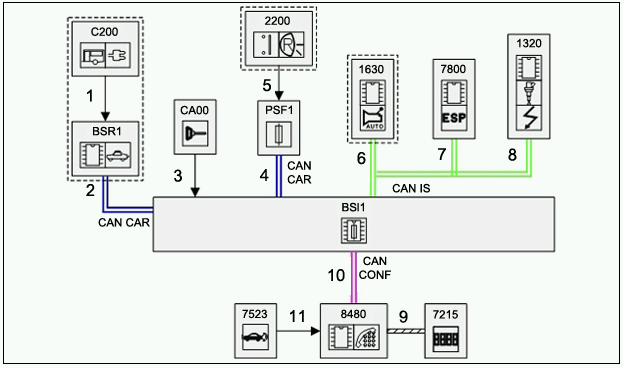

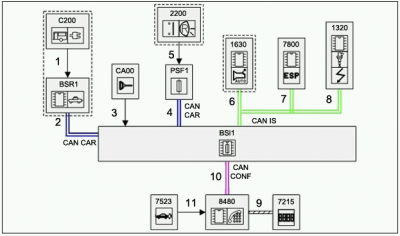

The connector in the tailgate (Tourer) that the camera plugs into: The 4 pin connector and the pin channels: The Communication flow between the components: The key for the above: The info exchange Description:

Re: Image quality reversing camera by night 2013 C5
Thanks GiveMeABreak. Camera is from another C5 - was worked in previous car. Camera is connected like in schematic. Engine is running, tailgate closed, reverse hear is switch on.

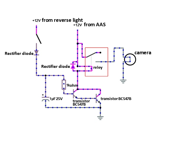

About Camera & RT6 & Citroen C5 X7 2008:
You need:
1. Camera (original or chinese cheap cam),
2. RT6 with camera support (with new hardware) - camera connected to pin 1 and 7 in RT6
3. BSI with latest software version (my problem was software from 2011. With new software camera start work)
4. Power supply to camera. I get +12V from AAS power supply, ground from ground point in car body, I use additional power switch/relay to power on/off camera when i put reverse gear - signal +12V from reversing light (without this camera was powered allways when engine is on). Why i not connected power camera from reverse light +12V directly? Because it's may problem with bulb diagnosis. Additional when You switch off reverse gear, RT6 show image from camera for few seconds more, so if camera switch off with reverse lights then You have blue image on screen for this few seconds.
5. AAS version it's not important
6. Configure BSI/Configuration/Driving information/Parking assistance/ Set right option with camera support.
