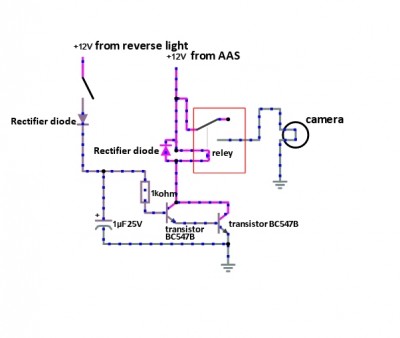

About Camera & RT6 & Citroen C5 X7 2008:
You need:
1. Camera (original or chinese cheap cam),
2. RT6 with camera support (with new hardware) - camera connected to pin 1 and 7 in RT6
3. BSI with latest software version (my problem was software from 2011. With new software camera start work)
4. Power supply to camera. I get +12V from AAS power supply, ground from ground point in car body, I use additional power switch/relay to power on/off camera when i put reverse gear - signal +12V from reversing light (without this camera was powered allways when engine is on). Why i not connected power camera from reverse light +12V directly? Because it's may problem with bulb diagnosis. Additional when You switch off reverse gear, RT6 show image from camera for few seconds more, so if camera switch off with reverse lights then You have blue image on screen for this few seconds.
5. AAS version it's not important
6. Configure BSI/Configuration/Driving information/Parking assistance/ Set right option with camera support.
download/file.php?mode=view&id=1551
camera power supply delay
