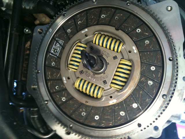

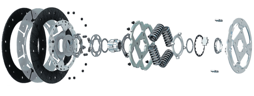

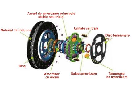

Please look at the KIT4P video first before you post something that is not even correct.
Valeo kit4P is different than what you stated on the pictures as the springs are much larger and are double springed see pictures so it vibrates as same as the DMF than a std. clutch set to compensate vibration. The clutch plate in the Kit4P has the springs what is inside the DMF so it compensates vibration. It drives the same almost to no difference.
I am not endorsing stuff or anything I am just making my point of an useless feature which is not needed.

I am aware that on the solid flywheel conversion kits that the friction plate has larger springs, and probably other things, to replace the effect of the dual mass flywheel. The manufacturers claim that it is as effective as the dual mass flywheel otherwise they wouldn't sell them. But if that's the case why are the DMFs produced at all?

The details I posted come straight from the technical data sheets of the manufacturers.jsp wrote:Please look at the KIT4P video first before you post something that is not even correct. .
Also, I did say "the 4p kit moves the damping from the flywheel to the clutch plate, using longer springs".
Main point is those extra-length springs in the 4p kit will still be doing a lot of work damping the peak torque values, and would seem to be just as likely to develop play as the springs in a DMF, so overall one might well still end up having to service the clutch unit more frequently. I'm not saying that the 4p kit isn't a good alternative but the peak torque values of a modern diesel, and the added damping requirement, will always increase service costs.
