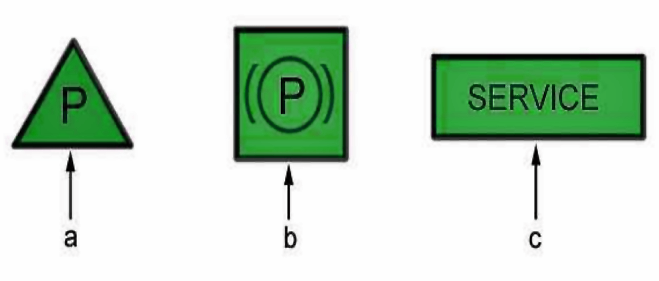

Fault Code U2118 After sales description of the fault code Fault in the reception of the partial triggering message by the built-in systems interface (BSI):Coherence Description of the diagnostics On a partial wake-up request, the frame is invalid or absent Conditions of activation of the diagnostics Ignition on Conditions of disappearance of the fault - Down-grade modes if fault present No back-up mode Switching on of the warning lamp and/or warning message Warning lamp
- "a" : Not on
- "b" : Not on
- "c" : Not onMain customer complaints likely Switching on of the warning lamp and/or warning message

Fault Code U1108 After sales description of the fault code No communication with the engine management ECU fault: No signal Description of the diagnostics The engine management ECU is confirmed absent Conditions of activation of the diagnostics Ignition on Conditions of disappearance of the fault - Down-grade modes if fault present No back-up mode Switching on of the warning lamp and/or warning message Warning lamp
- "a": Not on
- "b": Not on
- "c": Not onMain customer complaints likely Illumination of LED/Error message

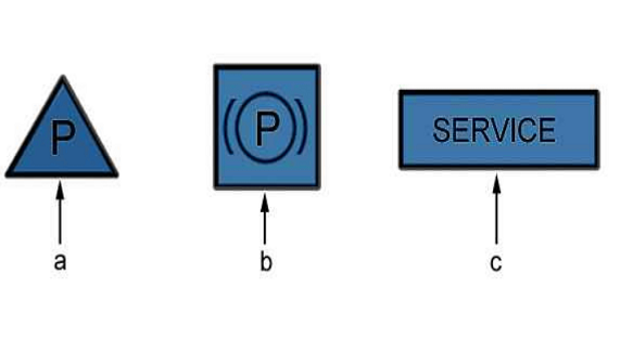

- Dynamic braking by the electric parking brakeSwitching on of the warning lamp and/or warning message Warning lamp
- "a" : lit
- "b" : lit
- "c" : litMain customer complaints likely Illumination of LED/Error message

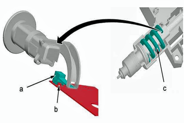

The hill start assist is not workingSuspect areas Brake pedal switch
Electronic stability control (ESP)

Here's the fault code for C1552.
Key
Switching on of the warning lamp and/or warning message:
"a" : Electric parking brake fault warning lamp
"b" : Electric parking brake warning lamp
"c" : Service warning lamp
Here is the sensor inside the EPB:
"a" Magnetic target.
"b" Integrated force sensor.
"c" spring.
The force sensor is of the HALL effect type and is integrated into the EPB.
The force sensor's job is to measure the force applied by the handbrake mechanism on the rear brake caliper cables.
What you might want to try is to release the handbrake and then try re-apply the handbrake holding the handbrake electronic control up for 10 seconds - this will apply maximum force. Then release it again and try applying it normally with just one normal lifting of the control. It's possible that if the rear pads have been replaced or the rear calipers, that the mechanics did not release the handbrake mechanism using a diagnostic tool to fully release the cables. After, there is a re-attachment procedure that is done using Diagbox to ensure they are properly re-attached and calibrated.
I've not heard of this specific sensor failing before - but it's possible of course.
Key
"c" spring.
- The magnetic target "a" is connected to the rear left secondary cable.
- A spring "c" stretches to hold the secondary cable in the released position.
- The calibration value of the spring "c" is recorded in the electric handbrake ECU.
- When the handbrake is applied, the movement of the secondary cable compresses the spring "c".
- The movement of the magnetic target "a" is measured by the sensor "b" integrated in the electronic card.
- The electric handbrake ECU compares the value of the movement of the secondary cable with the calibration value of the spring "c" to calculate the force applied to the calipers.
