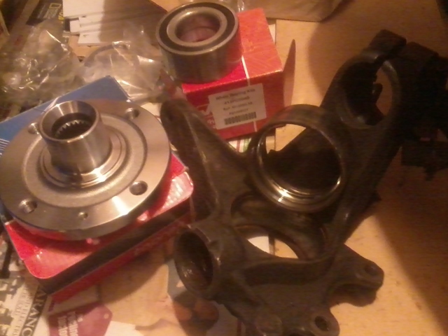

1996 Xantia 1.9TD 290k front nearside hub replacement

Re: 1996 Xantia 1.9TD 290k front nearside hub replacement
8lb sledge = quite a lot of percy-whatsit
I was wondering how on earth you managed to pull the inner race right through
On the getting it out - I would add the winding the tension on with the puller, then getting the hub 'kin hot, and then whacking the back of the tool with the tension on may get it shifting. Once it has started it will come out ok, but getting it started is going to be a challenge....
Shim on the tool too small to push the outer race so just mangles the bearing?RichardW wrote:8lb sledge = quite a lot of percy-whatsit![]()

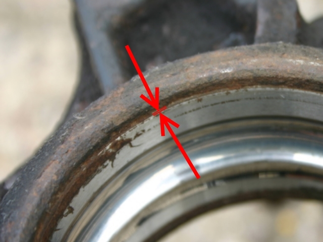

Only prob is the difference between the rim of the bearing and the beginning of the hub carrier is like under a millimetre :/
So as suggested gonna pull from the inner raised area
.. where the bottom red arrow's tail is sitting over
ok, right.
Really getting somewhere now
I've got the outer bearing race out! Cheers for heads-up guys
As suggested, pulled from the lip inside the race with that puller kit in the red case shown earlier.
When it wouldn't move from me swinging on it, I gave it a big bit of persuasion from the, not 8 but 10lb sledge hammer.
Kept doing that till I was able to wind it out.
Ok, so I suppose as the Haynes manual always states.... "refitting is just the opposite of removal"
Other than pressing that bearing in straight and so not letting it lean to one side whilst it goes in.
Is there anything I should be aware of when I do this for real on my poor Xantia? :/
Thanks for the pointers.
