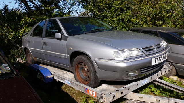

This has now arrived at its dismantleing place now harry...
Ill be making a seperate post for the car else where..
A very sad...
