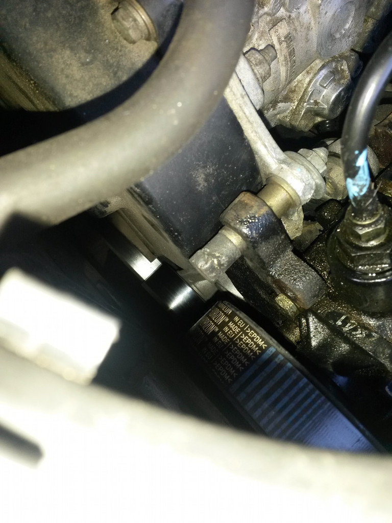

At least that ties in with what I was expecting. Just had a peer down the side of the engine and can't immediately *see* a whacking great coil spring (we're shortly heading out to dinner and I was just playing automotive Tetris to get the 107 out so didn't have much time to check), though given how limited access to that end of the engine is that doesn't necessarily mean anything.
This terrible photo shows the offending item just below centre frame.
This is the one which appears to be making the characteristic dry bearing drone/whine and looking at it looks as though the belt is running slightly off centre on it. Not sure if this is the tensioner though or whether that's the other pulley buried down in between the hydraulic pump and air con compressor? If I'm taking things apart anyway I fully intend to change all of them to save hassle in the future.
Sorry to sound like a complete rookie, I'll learn eventually! Just a few more bits in this engine bay than I'm generally used to, and the belt routing seems fiendishly complicated compared to what I usually have to deal with.
...Maybe it's a good thing that I didn't end up with a V6 after all!
I don't have photos of the presumed incorrect parts as they've since been returned I'm afraid.
Current fleet:
Forum Treasurer
Posts: 12576
Joined: 07 Aug 2002, 17:12
x 1485
Re: Oh well, know what I'm Doing Tomorrow!
Unread post by RichardW »
Certainly looks like the earlier one.... :?

citronut
Posts: 10937
Joined: 29 Apr 2005, 00:46
x 94
Unread post by citronut »
i can see the top end/mounting of the big spring in your picy Zel,just the other side of the hydraulic pipe with the white splodg on it, if you look down the back of the hydraulic pump and under the fuel pump you will see the spring
