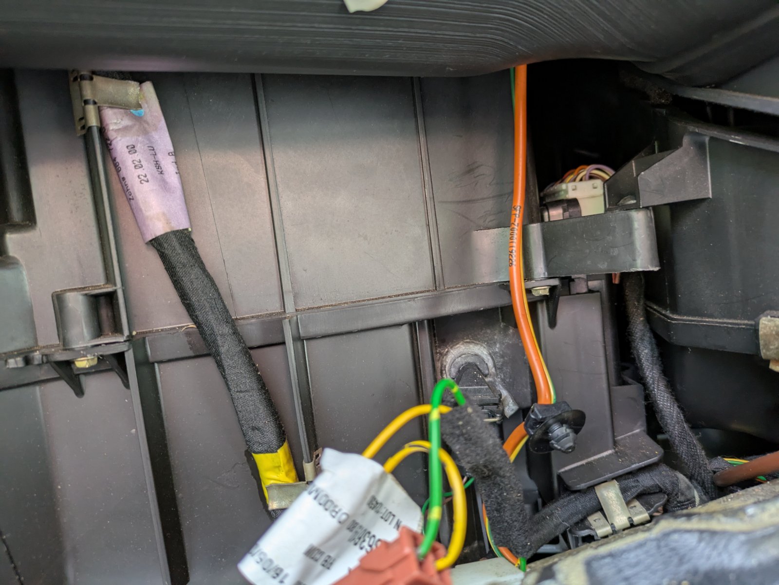

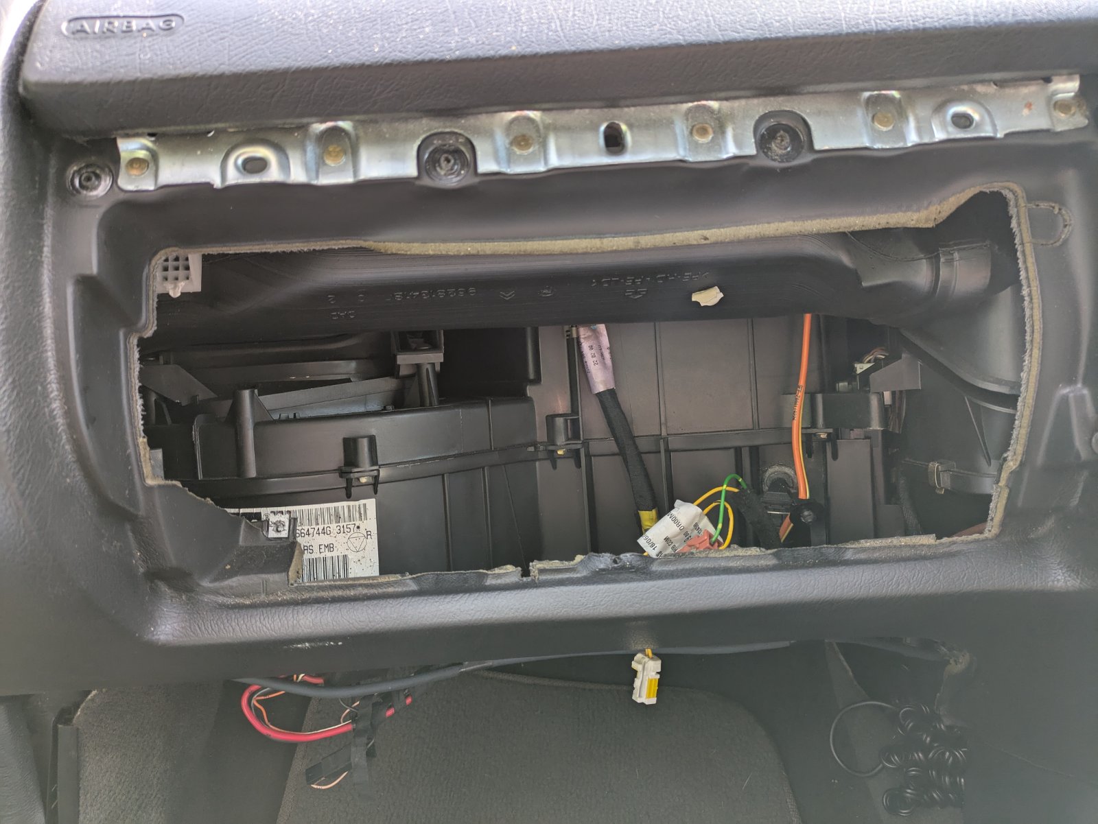

Hi Jim,
Many thanks for your message.
I have attached two pics:
1. 'Glovebox view' - a general view with the glovebox removed.
2. 'CPH close-up' - a slight close-up of what I assume to be the CPH - to the right of the Glovebox space. You will see the white connector plug on the top of the box.
Can you confirm that really is the CPH, or am I missing the bleeding obvious and looking in the wrong spot?
I want to be very sure that I am attacking the right item if I start pulling the whole car apart! 😀
Cheers,
Kim

Hi Kim,
The CPH sits on top of the heater box behind the bit of annoyingly in the way air trunking you can see... If you can, put your hand up there and you'll feel it...
If it's a warm day out your way the bit of air trunking may just be soft enough to deform enough to pop out and offer more room and visibility...
The ECU and connector you can just see to the extreme right of your picture is the aircon ECU...

Hi Jim,
Thank you so much! I'm so glad I didn't start hacking away at the car to remove what would have turned out to be the A/C ECU!!!
Following your suggestion I have dislodged the air trunking a little. So now I can see a new range of black boxes with electrical connector plugs. Knowing that the CPH has two connector plugs I think I can identify it now - to the right side of the glovebox opening, right behind the air trunking.
I'm no closer to being able to remove the CPH btw, but at least I think I am working on the right piece of equipment now!
Many thanks, once again!
