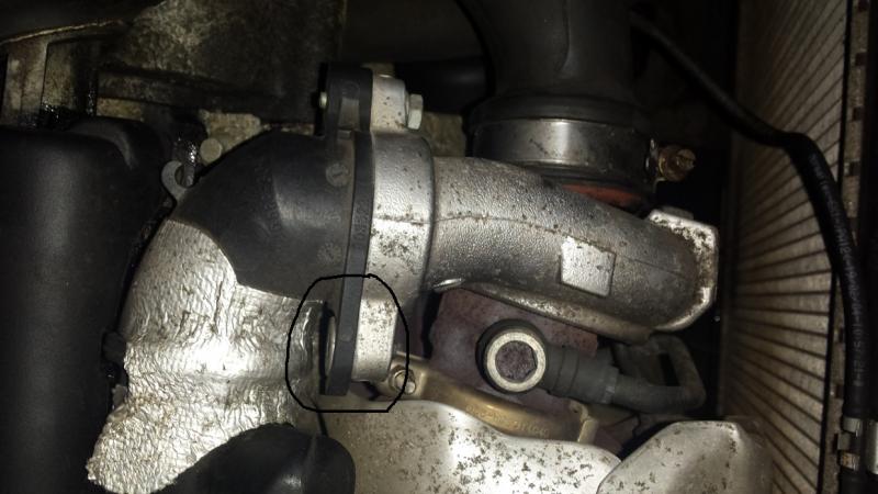

Guys -- A pre fitting the Turbo question.
Next to the top banjo bolt on the left is like a oval steel plate on the Turbo and this connects into like a plastic box the sits between the Turbo and the engine. This box seems to have a tube on it that runs to the radiator at the front of the car in an L shape. Virtually next to the banjo bolt is Torx type very short bolt that looks impossible to get at. What sort of removal device does that need as the other side has a normal bolt with a head that could be removed with a socket set, but the left hand one is different?
On my picture (post 10) its the flange at the top right of the picture that has a threaded hole at the bottom and the bolt goes through the bit at the top. Its the little bolt with a torx type head on it that I need to know how to remove or do I just cut it off, and if so how?
In addition both of the new Banjo bolts seem to have filters in them, should I remove both filters? Also the both seem to have like a spline thing bolt in them, how are these removed? Forgive my ignorance just want to be prepared so if I need to buy something to remove stuff I can get it beforehand. I fear starting the job and getting stuck half way through because we do not have the right tool.
As my son in law is being good enough to replace it I don't want to land him in it so to speak!

Re: Picasso Turbo Replacement (Not EGR)
cheers for the info Rob. Yes I checked the part number on the existing turbo and made sure it matched the one I got. I assume that it should be correct, from info it appears this turbo is used on all sorts of cars. Looking at the duff one on the engine the new one looks the same, however, It was the weird little bolt / thread which I was wondering about. I don't want to not have all the tools to hand, hence why I was asking in case I need to buy something. I will certainly pick up some sealant from ECP.
Not quite sure what you mean by "The pipe that is connected to the turbo flange should be disconnected from the dosing valve end first and you should then be able to get at and loosen the bolts." Are you saying that if we remove the right hand proper bolt from the flange it becomes easier to get at the weird bolt on the left? Have taken a picture to show you the weird bolt. (sorry guys cannot figure out how to attach the picture directly into the post)
Here you go Tom
The top bolt IIRC has some torx part on the left hand side. I think this is due to access being so poor on it that a Torx head allows enough torque on it to screw it on and take it off with minimal damage to the head.
I have some torx screwdrivers you can borrow if needed as i think it looked like a T25/30 size.
Also i have some exhaust paste which you may need for the turbo outlet to downpipe/dpf section to ensure a good seal.
As mentioned, poking the filters out is worth doing even with new Banjo bolts
Is it possible to actually undo that little weird bolt (the one I circled) as it looks as though you cannot get anything into it due to the silver foil around that pipe being in the way?
That's the bit I'm talking about Tom, the circled bit looked like it had a torx head on it
The left hand bolt in the picture, the strange one, should be accessible with a torx screwdriver and shouldn't be that tight to undo. You need to disconnect the other end from the dosing valve bit and then loosen both the right hand normal bolt and the left hand strange one. The plastic tube flange has a cut out which allows the tube to pivot on the right hand bolt and pass over the strange bolt. You can't see the cut out easily as it is below the strange bolt but you'll see what I mean once you loosen everything. Do you have a Haynes manual? Although not always accurate (hence known by many as the BOL -book of lies) it is generally useful for most stuff.tomthered wrote: Not quite sure what you mean by "The pipe that is connected to the turbo flange should be disconnected from the dosing valve end first and you should then be able to get at and loosen the bolts." Are you saying that if we remove the right hand proper bolt from the flange it becomes easier to get at the weird bolt on the left? Have taken a picture to show you the weird bolt. (sorry guys cannot figure out how to attach the picture directly into the post)
Thanks for that Will and Rob. I have checked and he says he has them so hopefully we can do it. We take off the bolt on the right then undo the torx head one right? Will get some exhaust paste just in case and sealant from Halfords that is specific for Gasket making. I assume that would be ok.
So the dosing valve is the black bit that runs off to the left of where that flange is with the weird bolt on which has the silver foil type stuff on?

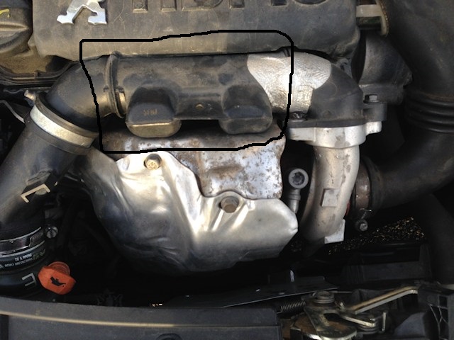

UPDATE on TURBO REPLACEMENT
The turbo has been swapped and everything went fine for about 20-30 minutes. It was fine and had full power, however now I have like a whistling from a black box that sits between the engine cover and the heat sink over the CAT / exhaust. It sounds like a police siren when the accelerator is pressed.
There is more power than there was before the turbo was changed, but its not at full power. Will has suggested there may be an air leak on the Turbo or a pipe somewhere. With that in mind I got someone to rev the car and there is a heavy vibration in the middle of this box when its whining.
Has anyone any suggestions what it could be? I have taken off the pipe to the end of the turbo to check for any play and that seems perfect to me?
Does this have any valves in that could be stuck causing this vibration?
Its this box I have circled here:--
Anyone's help would be most welcome thanks in advance
Citroen call it an air resonator - which it certainly seems to be doing at the moment!! Did you remove and drain the intercooler? Possible that it is full of oil in the bottom and restricting the air flow?
Where is the intercooler, the bit on the left? I have a feeling its where the two big hoses go into like a tiny radiator on the left, just looked at one on Ebay. Are they hard to remove? It seems weird that its vibrating between them two nodules on the black box!!
Oil bypass from the turbo spindle bearing is possible as the turbo that was on it had a shaft that moved around like a stick in a bucket
intercooler off shouldn't be too bad on that but maybe best from underneath...
Oh you mean oil got past the Turbo into the Intercooler path as the bearing was definitely worn out when we got it off? If that is the case why would it start and run alright for 20-30 minutes, although when it first started there were puffs of black smoke when he revved it and greyish smoke till it warmed. This was after we left it idling for about 12 minutes to give time to bed in and warm up. The smoke eventually disappeared and I suppose we could remove the resonator and look inside to see what is going on. Why would oil in the intercooler cause the loss of power, is it because there is not enough air and its all oil?
How is it removed, does it just slot out as I saw two locating lugs at the bottom for one I saw on Ebay ??? Do I then tip it upside down to get oil out - how is that oil removed from it then? Any ideas on time to remove this - only cos I need to know how long it would take to see if its feasible at night time due to dark and weather maybe its best waiting until next weekend!
Sorry for all these questions people, Not doing it tonight though, too fed up!! Just wish there was a way of magicing it all on!!!
