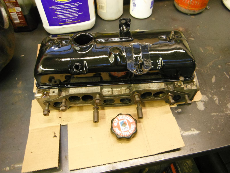

Oooo, an actual update! First up, good news on the head, it's not warped at all so that can go on the block happily. I've been told various other components are tired but usable, since the car is likely to only do light duties for a long time they shouldn't cause me any issues so we're going to reuse what's there and replace them if need be in the future. Couple of things holding me back from putting the engine together, the first being the honing tool being out on loan so the liners aren't ready to go in yet. The liners appear to be in good shape, they just need the carbon and muck cleaning off so things are happy on reassembly. The second issue is my back is still giving me grief and the third is that I really wanted to make the mechanical bits and pieces look nice as I work through and sort them out.
For a refresher, this is how the engine did look.

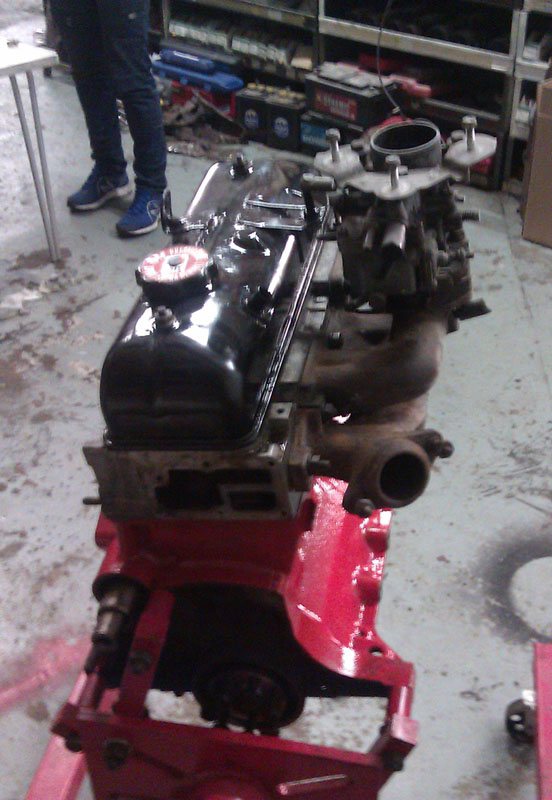

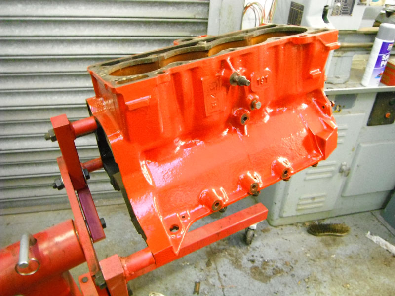

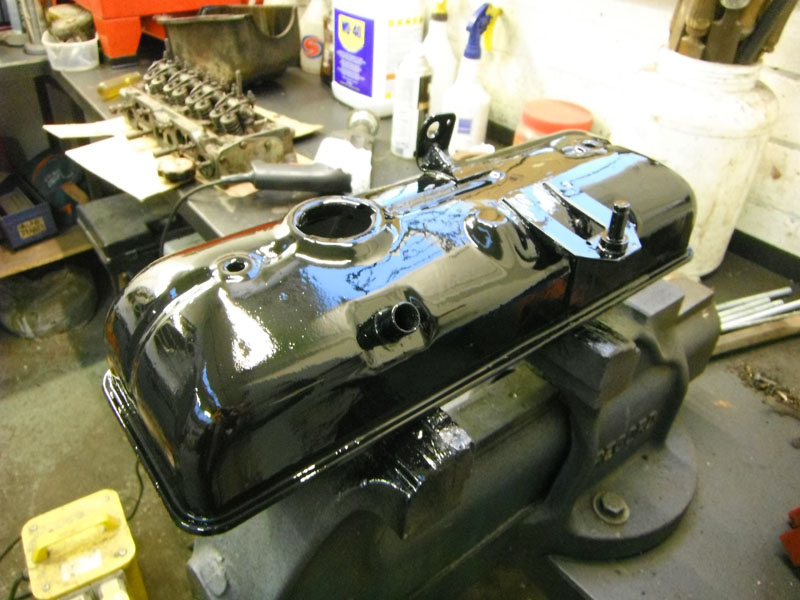

The rocker cover got a fresh coat of black paint. It was pretty tatty all over but still nice and solid. The filler cap is in great shape so that just needed a clean.
I wanted to paint the block green and then decided against it because we had some red paint and I like red and hey, it's free so why not. After taking a wire wheel to the loose stuff I applied three coats as per the instruction on the tin and got a reasonable finish. I'll go back over important mating surfaces with some thinners to make sure everything is clean before reassembly.
Plonked the rocker cover onto the head when it was dry enough to handle to keep things tidy. I'll get the new seal fitted before bolting this all back together properly.

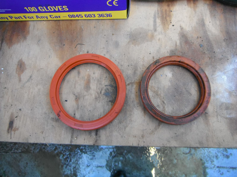

There was a bit of an issue when we found one of the crankshaft end seals in the kit was the wrong size. Everything else in the kit looks the same as what came off the car. I did wonder if the old one had shrunk and the new one just needed compressing but the new one doesn't appear to physically fit where it's supposed to go. I'll be getting in touch with Der Franzose about that one.
Not to worry, we don't need that bit as we're not ready to put the flywheel on yet. The liners were cleaned up and found to be free of steps and scores, the pistons inspected and found to have a good set of rings on all and to likewise be free of damage. Paper liners (literally paper rings that go at the bottom of the liners) of the relevant thickness for the wet liners were fitted and the task of installing the pistons began. This went very smoothly for two which were installed in the block very quickly. Unfortunately, on the other two the ring compressor slipped which let to snapping the end off one of the compression rings and deforming the end of one of the oil scraper rings. That was quite annoying. Luckily, you can get single sets of rings from Der Franzose for about £15 plus postage. I've been unable to find an alternative supplier for these at the time of writing. Even so, we got far enough that the oil pick up could be fitted and the pile of parts to reinstate has shrunk considerably.

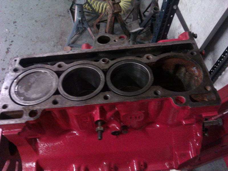

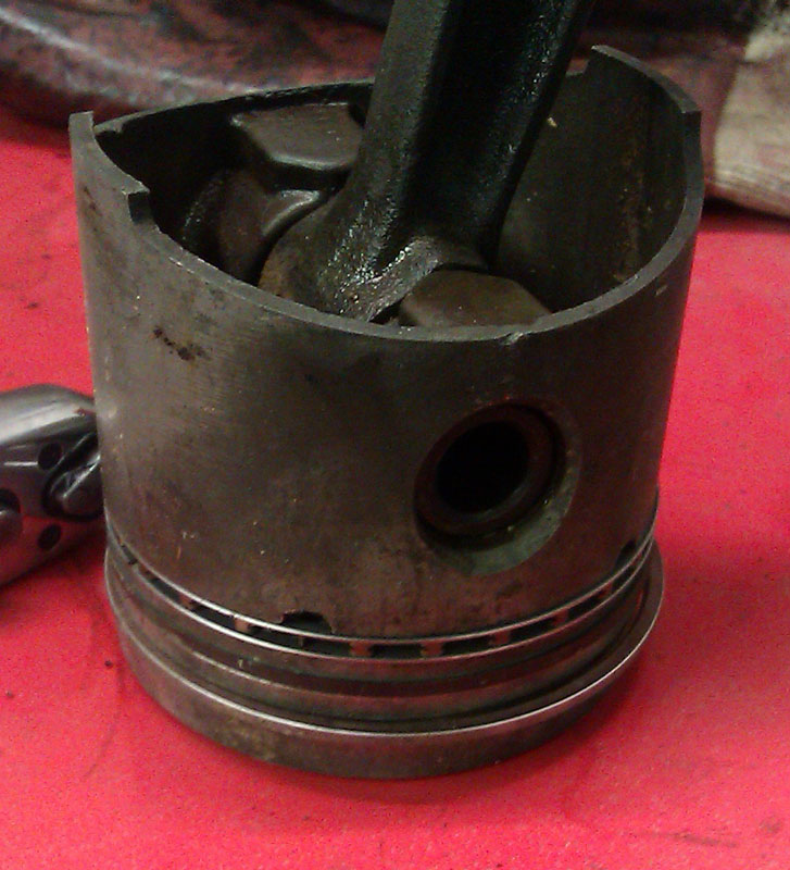

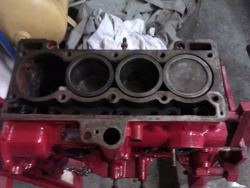

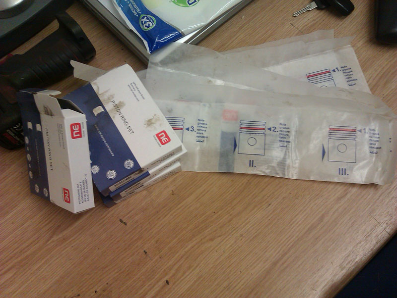

I finally got the expensive piston ring set from Der Franzose which came with instructions as to which went where if I wasn't sure. Some of the old rings did put up quite a fight, others didn't, and while the pistons show their age they're far from knackered so were decoked and kitted out with new rings.
This time, no piston rings were snapped on reassembly. Mike invested in a glaze busting tool for the unit and we tried it out on the Renault's scruffy liners. Worked a treat and they all cleaned up very nicely. Pistons went back in nice and snug and with a few tricks from my brother on how better to use the ring compressor and such we had all four back in the engine in no time. Here's some pictures of just three in situ. I was relying on my camera phone so components look dull when in real life they're actually shiny.
We made sure the correct paper liner gaskets were fitted, that the pistons all pointed the same way (there's marks on the crowns) and that the liners were correctly paired. There does seem to already be signs of good compression, as there was some necessity to rotate the engine while getting everything in and my brother's gloves were being successfully vacuumed into the bores, that bodes well.

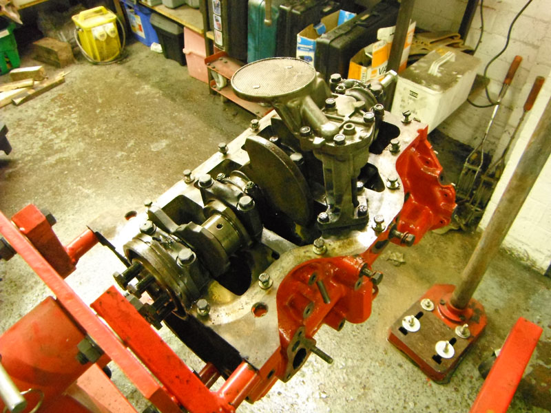

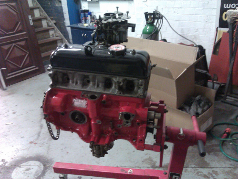

With that done it was really a case of reassembly. I didn't get everything done, I'm still a bit unwell and I wasn't in a rush, I'd rather the job be done well than quickly. Got the cam buckets and pushrods refitted, head gasket fitted, head bolts torqued in correct sequence (they'll be retorqued accordingly once the engine has been running) and even got the rocker cover gasket fitted.

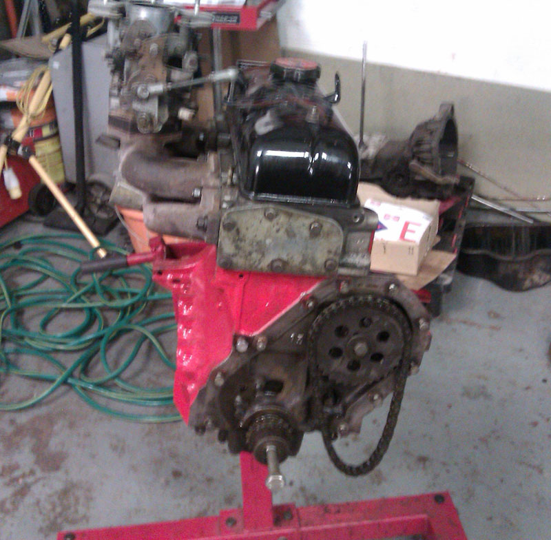

On a bit of a roll the crankshaft went in, the exhaust manifold and carburettor were also fitted. I was going to sort the timing and get the chain on but the tensioner has burst into its component parts and doesn't seem to want to stay together. Nothing appears to be broken or missing, it just doesn't seem to want to stay in one piece.
It's looking like a smart little engine now. Looking forward to firing it up when we've finished rebuilding all the various bits and pieces, I'd like to hope it's not going to take another year before it's back in the car but you really never know with the way my life goes.

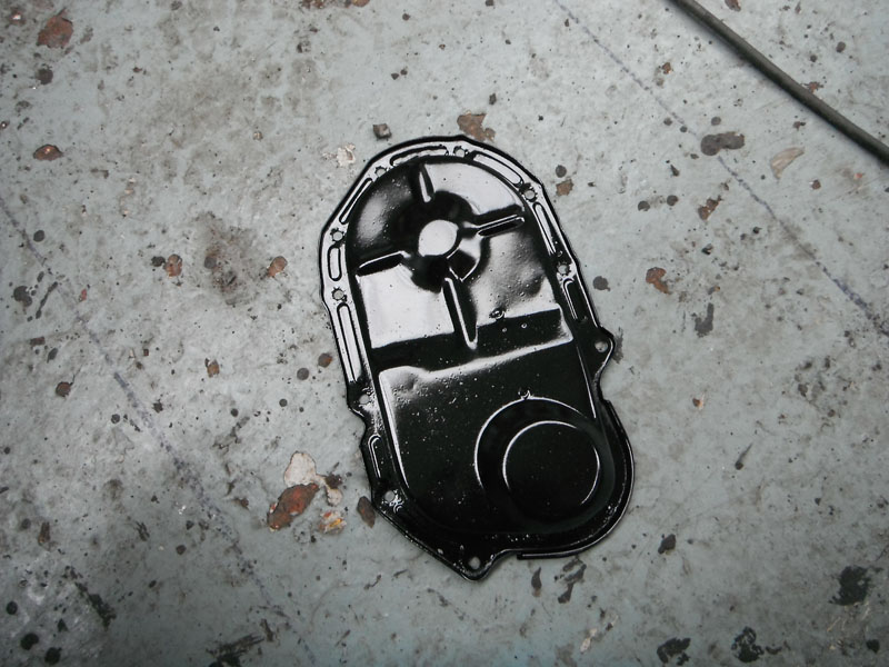

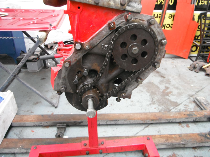

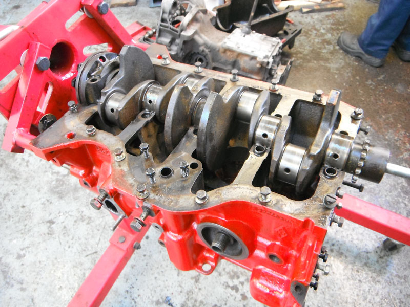

Today started off well, got the timing chain on and set the timing surprisingly easily.
Things were off to a good start today. Cleaned up and repainted the timing chain cover.

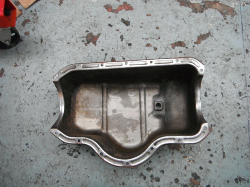

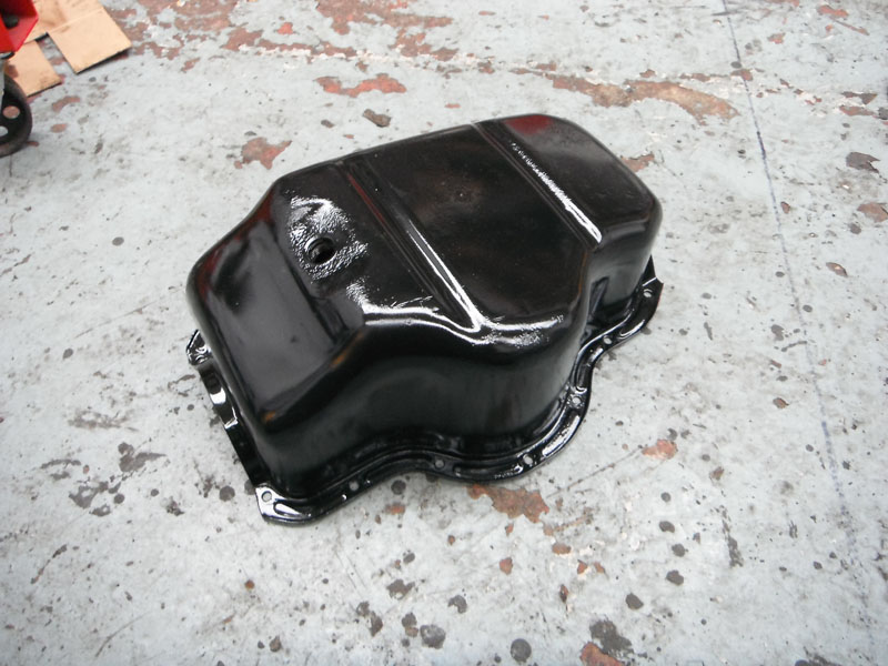

Cleaned out the sump too, the bottom of which still had the horrible grey putty under the oil sludge. Took a while to clean it all up.
I need a new sump plug, the old one looks like someone has used a dinosaur to try and release it. The outside of the sump was a bit pitted from rust and had signs of a bit of a scrape where it looks like the car's hit a rock or something. Nothing too serious and hidden with a fresh coat of black paint.
Feeling pretty good about all this. Time to get the engine turned over a few times and get the tappets set. Then something went wrong.

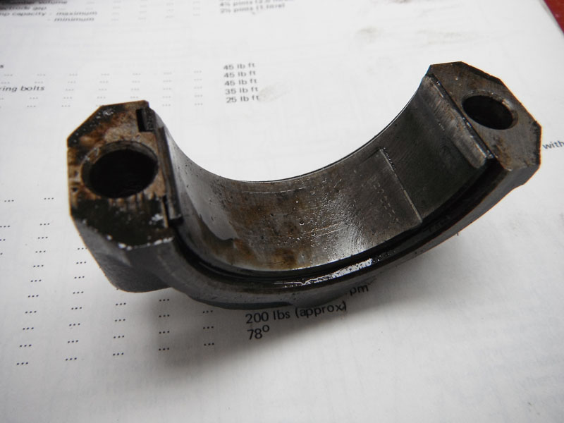

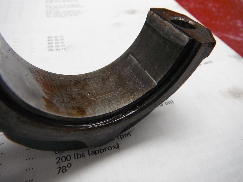

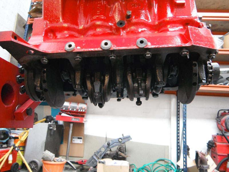

After getting the engine together, setting the static timing and checking it was rotating freely (and I did use assembly lube on everything so it was all nicely oily), somehow a con rod bearing shell slipped when it was rotated, I don't actually have the faintest idea how, and now I have this problem. The scoring visible in the photograph isn't very visible at all in the real world and there were no scoring marks on the crankshaft before this happened. I've not yet inspected the crankshaft but I'm expecting it too is damaged and will need regrinding unless I'm very, very lucky. Then I'll have the unenviable task of locating oversized con rod bearings, a prospect I am not relishing.
It's the second one from the right in this picture that had spun.
I'd like to know how I managed this and what went wrong. I've read other engine rebuild threads where bearings just do this sometimes, both new and old re-used ones. Where I'm lucky is that this has happened on hand cranking and not when I was driving the car as seems to be the norm for this sort of thing from what I've read over the course of the last year or so. It's my first full engine rebuild so mistakes are inevitable and hopefully this one won't be too costly to resolve.
On the positive side I don't have to dismantle the entire engine to replace the bearings and inspect the crankshaft and before the bearing span the engine did turn over really smoothly and operated all the pushrods as it ought so there was a moment of sunshine today.

I am no expert on spun bearing shells, but the crankshaft journal is a lot harder than the bearing shell, so is unlikely to be damaged.

I do hope so! I was so disheartened when this happened. I'm going to the unit tomorrow so I'll know for definite, hopefully find out why the Princess has decided to start backfiring through the carb too. Old cars, why do we bother?
