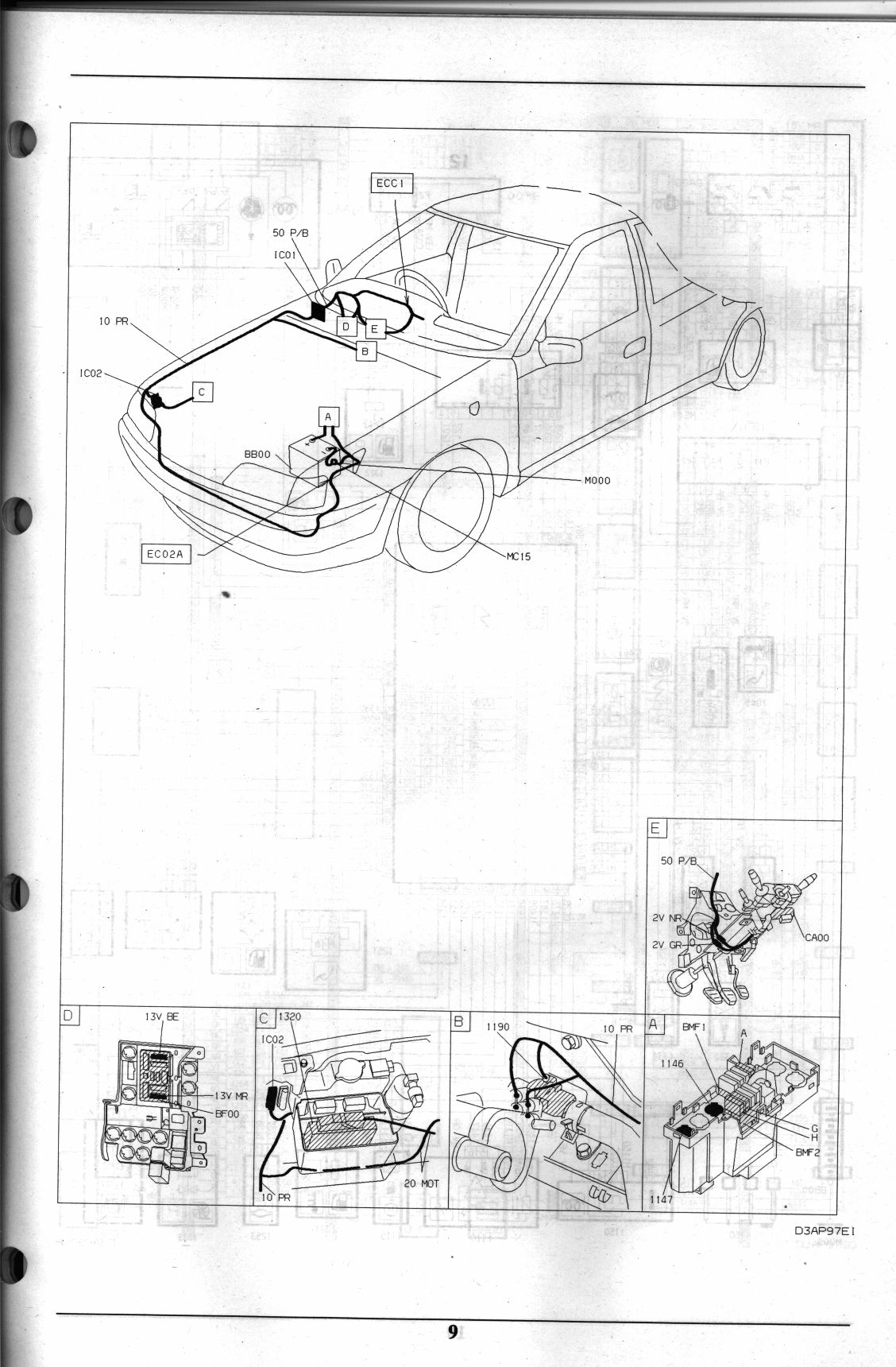

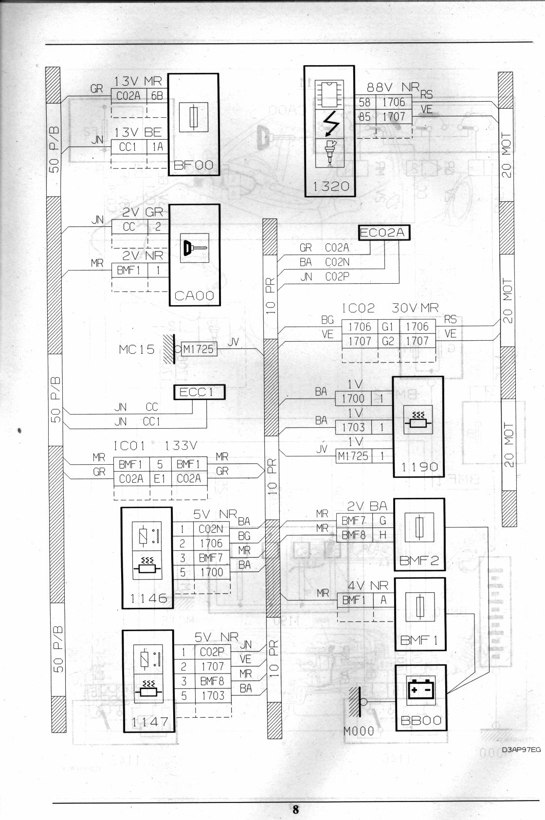

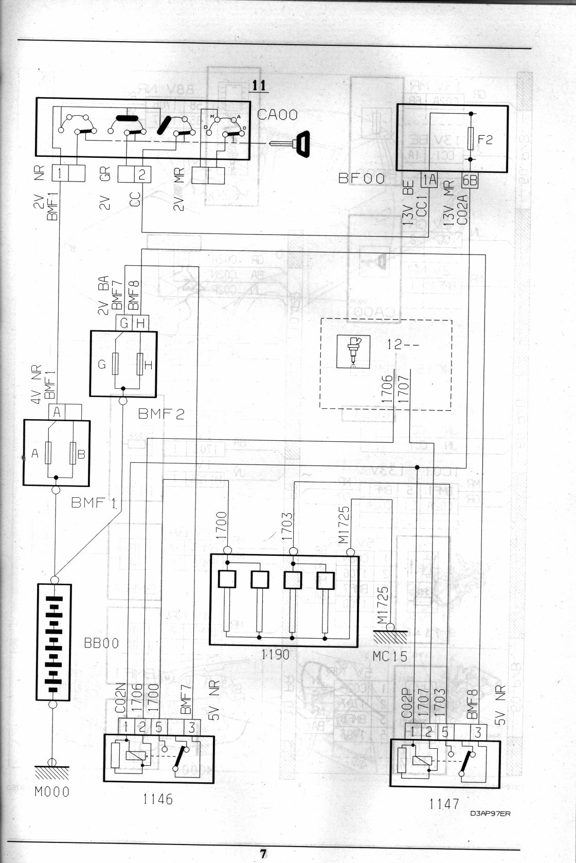

Posts: 55201
x 8445
Re: Water preheater- need hose size
Kenny,
Here's the wiring diagrams for the glow plug type auxiliary heater:
Circuit Diagram
Harnesses
Locations
Hope they prove useful :-D

KennyW
Posts: 2615
Joined: 17 Jan 2006, 21:22
x 165
Unread post by KennyW »
Jim,
Thanks for those diagrams, as I suspected they( glow plug heaters) were connected to the fuses in the passenger bay. I love the location diagram brilliant =D> .
