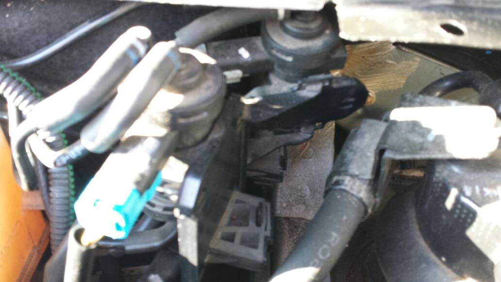

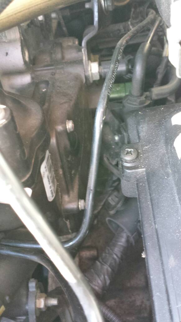

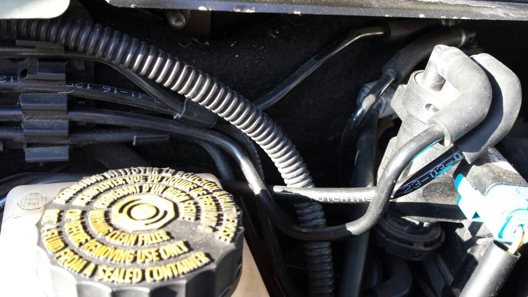

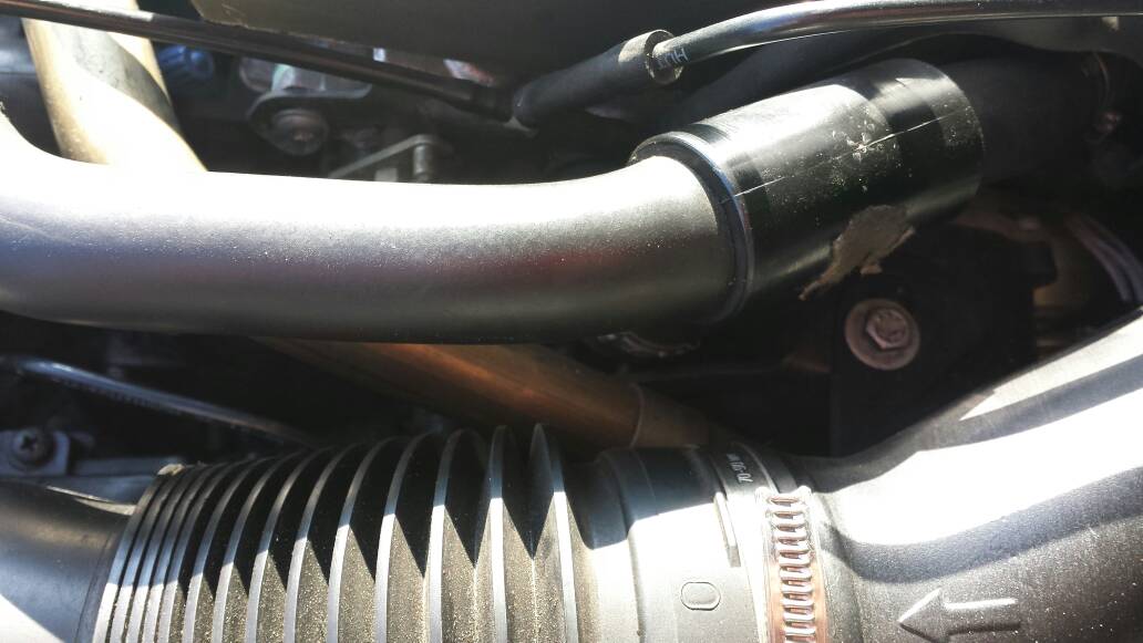

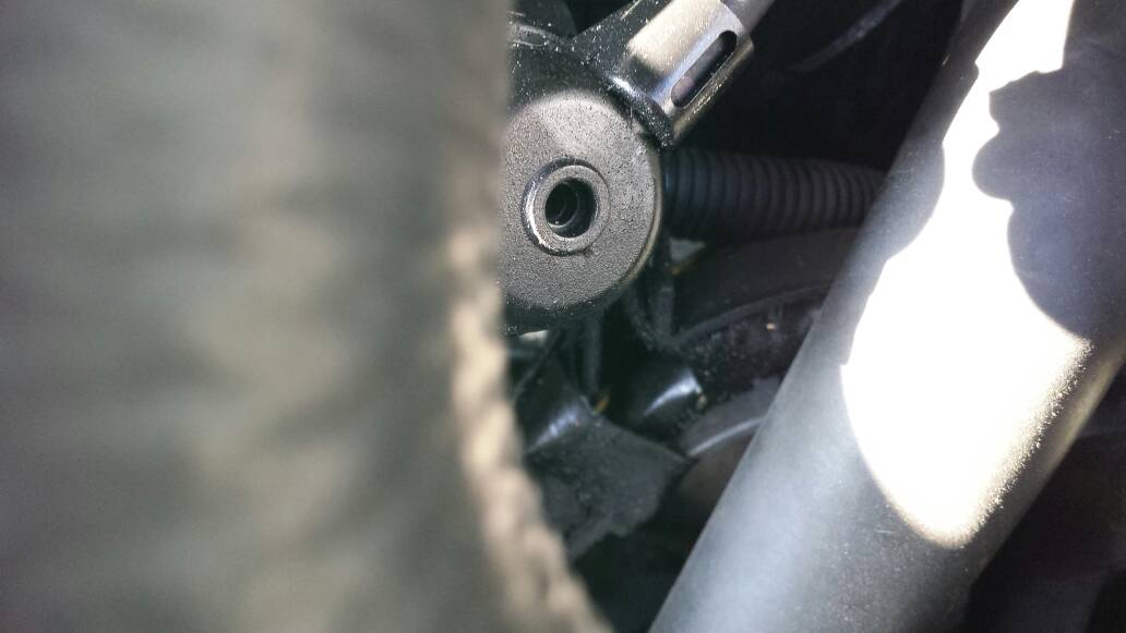

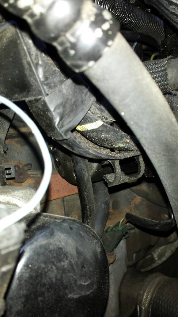

It is exactly the same engine as mine was taken from a C5, it is the 4HX but it was torn down to bare engine and everything off my 4HW was placed on it and everything went on exactly the same way it came off so no hidden extras!

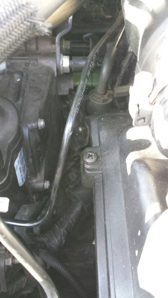

Could I trouble you to take some photos for me in the daylight tomorrow please Wayne? from left to right as I have a few brackets to hand and no clue as to where they go.
Also, I think that the cables will be more visible, if it's not too much bother please?
Many thanks again!
Many thanks again!

not sure these are going to help really need to get under shield off.

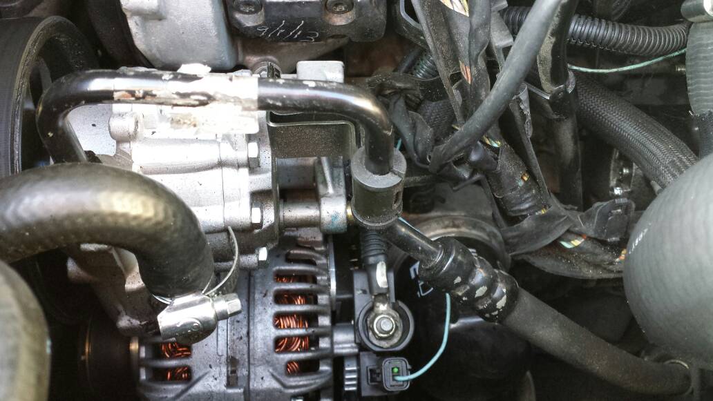

maybe as you say this wagon has every add on conceivable, the extra wire could be a supply to the add on's/extra equipment, which picks its currect up from the live feed on the alternator,
can you test which of the two connectors is live whist they are both disconnected but the battery hooked up,
this one will certainly go to the alternator

Have you swapped over the cables and put the one with the white mark on to the alternator?

C8Charlie wrote:OK, Electrics on! and I also I found out what the cable dangling down the back was, Auxiliary heaters for the inside of the cab, the connection port was disconnected and hiding in a heat resistant sleeve, job done!
All I have to do now is find this one it's place even though it does seem to want to go on the alternator for some reason!
Looking at that picture suggests to me that the one you have connected to the alternator is the direct from battery positive wire, the one in the red circle should also be connected to that terminal and is to pick up the power from there to supply other services.
On my 2.0 litre C5 that pick up is made, not from the alternator end but picks up directly from the battery positive connector, it gets the same result but is probably just some minor convenience when they designed the loom, maybe to save a couple of inches of copper cable.

Thanks for that, I too think it goes there and that the 2 should be on as I am having a few issues with it disconnected, electrics playing up etc!!Gibbo2286 wrote:C8Charlie wrote:OK, Electrics on! and I also I found out what the cable dangling down the back was, Auxiliary heaters for the inside of the cab, the connection port was disconnected and hiding in a heat resistant sleeve, job done!
I don't have a clue as my "trusty" mechanic (whom I do not speak to now he landed me with this mess) took it all off, I have just been playing a guessing game but as per my previous post, I will update accordingly to let you guys know how I got on!

That makes sense, especially as the battery on the C8 isn't in the engine compartment, it is under the floor just inside the drives door.Gibbo2286 wrote:... On my 2.0 litre C5 that pick up is made, not from the alternator end but picks up directly from the battery positive connector, it gets the same result but is probably just some minor convenience when they designed the loom, maybe to save a couple of inches of copper cable.

Firstly, the cable was for the alternator! That problem solved!
