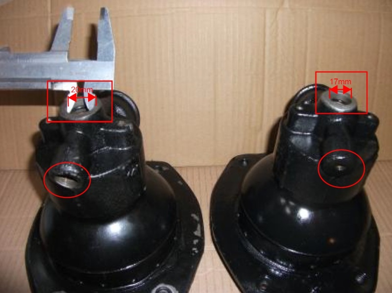

Mike, pictures taken but run out of time to put them on the webserver today. I'll try tomorrow.CitroJim wrote:Mike, I'll give all the KingAS detail later and some piccys of his very excellent work. Can't right now, currently enjoying a meal in Wagamama and sending this from my phone...
Anyway,
Contact KingAS at info(at)elastomer.eu
His proper name is Irmantas and he's very helpful. I can tell you now he'll ask 75 Euros + VAT for each one. You pay outgoing freight and he pays it on his despatch back to you.
I got 4 despatched to him using ParcelToGo for £31..
New ones for a Xantia may still just work out cheaper after VAT, carriage and exchange rates are taken into account.
All up, the four we had done cost £370 all-in with carriage..

I believe V6 struts have a bigger hole, because the cylinder that goes into the strut is a bit thicker...

Here it is. And also difference between hydractive and non-hydractive.

Activa is 17mm with 10mm (Hydractive) pipework Mike...
The V6 ones are unique to the V6 which makes them rather valuable..
Didn't realise Xantia tops were now NFP
