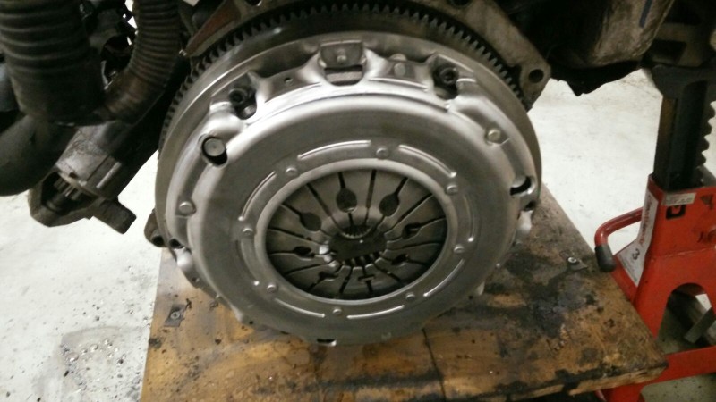

I have done the Valeo single mass KIT4P conversion and runs good on one of my customers 407sw HDI 16V (same engine). (2 years ago) You can hardly feel it it's a single mass flywheel. The car is booked this week for a big maintenance will make a video of the ride if you still aren't convinced.

The kit 835068 is for a HDI 16V before 12-2005 for a 136hp. The 407sw that is booked this week got chipped I heard just ago. so it's running fine at 179hp on the kit4P. 835069 is for hdi 16v 2005 - now

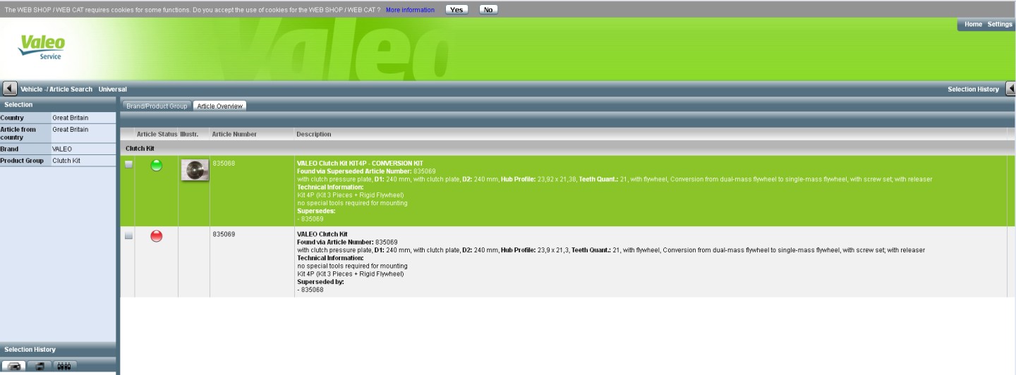

835069 Valeo should fit under your car.falling-out-with-my-car wrote:I found a valeo kit online for my 2007mk2 136 16 valve 2.0 hdi. At £257.00 for the SMF conversion but I'm not sure if it is a 4p kit. Don't have access to.the details on my phone but will post up a link later one on proper puter.
Sent from my GoFone_GF50X using Tapatalk
Please check if this on the box at your local parts shop.
I have the specifications here:
Brand Valeo
Item Weight 13 Kg
Product Dimensions 6.1 x 5.4 x 2.4 cm
Item model number 835069
Manufacturer Part Number 835069
OEM Part Number CITROËN:0532 Q9, CITROËN:0532Q9, CITROËN:0532S7, CITROËN:0532X7, CITROËN:2052H4, FIAT:96 643 620 80, PEUGEOT:0532 Q9, PEUGEOT:0532 S7, PEUGEOT:0532 X7, PEUGEOT:0532Q9, PEUGEOT:0532S7, PEUGEOT:0532X7, PEUGEOT:2052H3, PEUGEOT:2052L3, PEUGEOT:2052N3, PEUGEOT:96 607 456 80, PEUGEOT:96 643 620 80
Item Weight 13 Kilograms
https://www.valeo-techassist.com/xwiki/ ... text=kit4p
http://ows-cdn.tecdoc.net/valeo/home.js ... 0fe6f82565
Just had a look at valeo tecdoc but, seems 835068 and 835069 are the same? Both should fit then under your car if you have a 2.0 HDI 16V.
