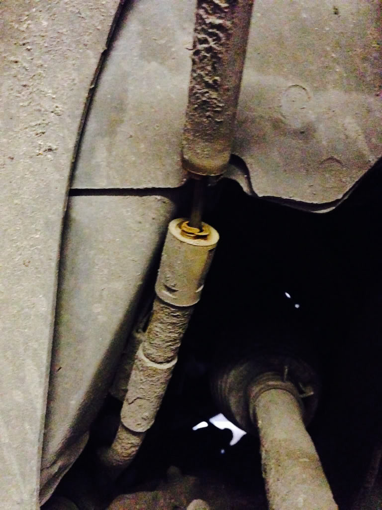

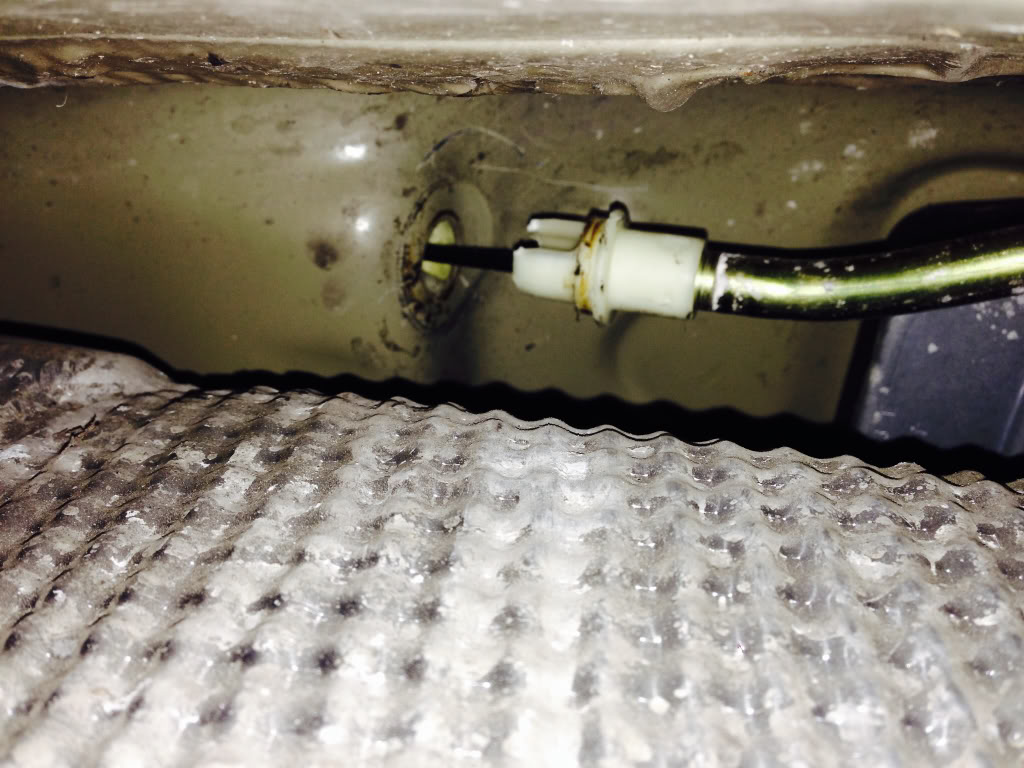

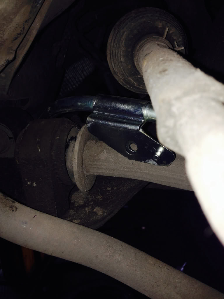

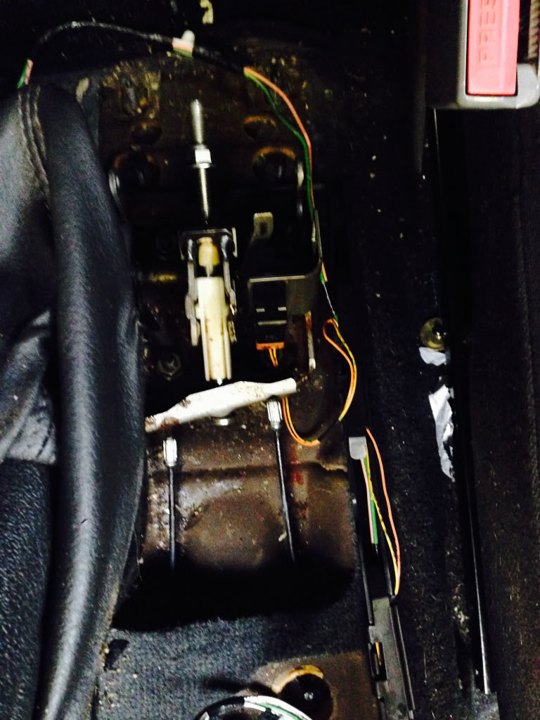

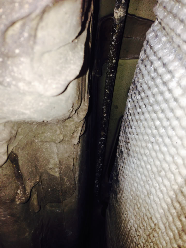

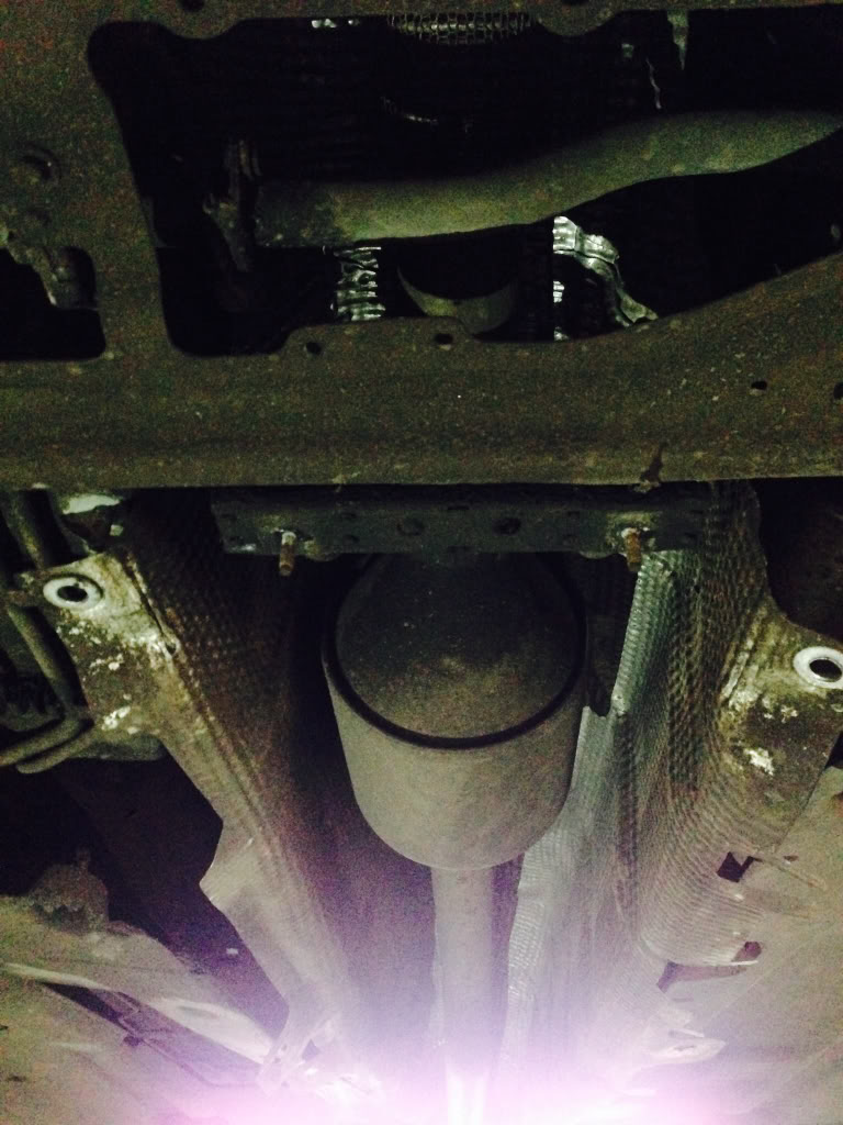

This is the heat shield released, note the exhaust is still on. The exhaust front x member support is off, but you need to pull the exhaust support (with rubber supports) off as well .
Some of the tube just visible above heat shield
Inside the car with console out (obviously), nipples released from lever.
This bit is tricky, you can see I have smashed the white clip,it's about the only way to release it from the floor, it's a tight fit.
Where the inner cable exits the tube, they are usually broke here, this is where the water gets in. It's under the wheel arch, not surprising really .
New tube & Brkt heading towards the correct location. Getting the new one in, and located at each end is the hardest part of the job. I bolt yhis Brkt on 1st, and then with a really small flexing of the tube along its longest length, you can locate the white plastic clip into the floor pan hole
