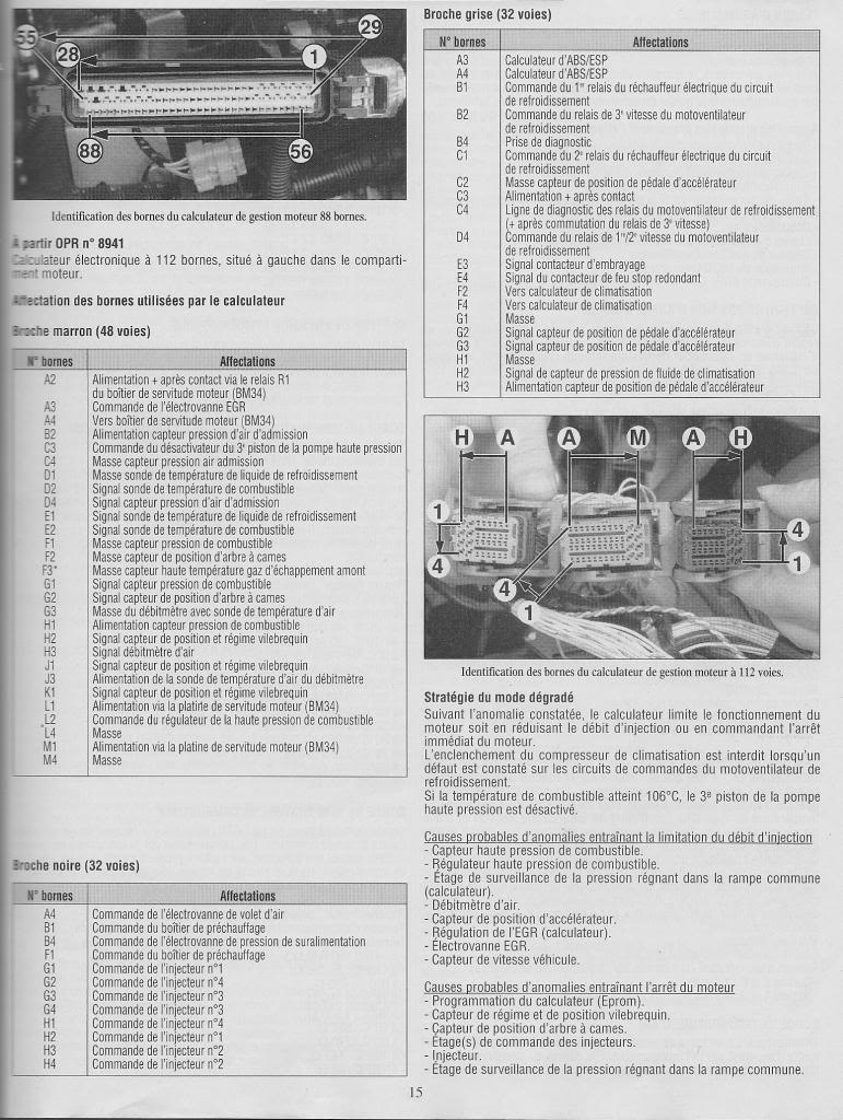

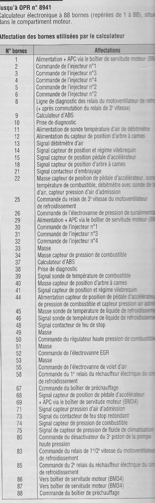

anybody got anymore diagrams on the 88 pin edc15c2 please?
i cant get auto data to work
many thanks
many thanks

cheers bx
Now translating lol
I'll post it in english soon
